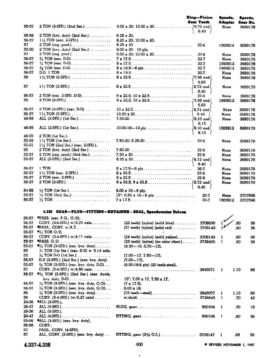

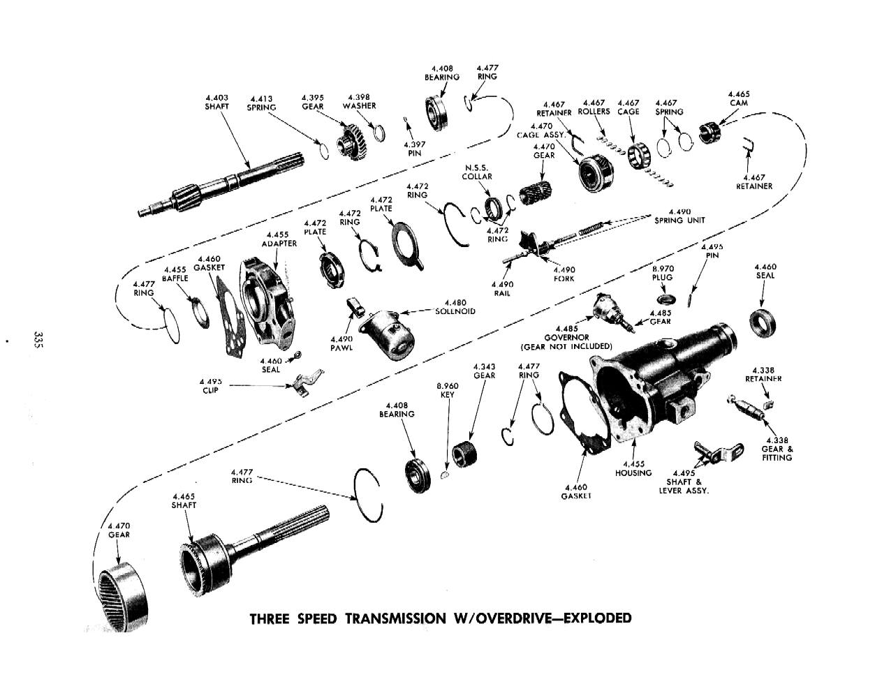

    Its a Borg Warner, they were used on many different brands with just a different bolt pattern, or output shaft. So, once you figger out what gear, it may not necessarily be from a chevy. Sorry, no gear info...good luck

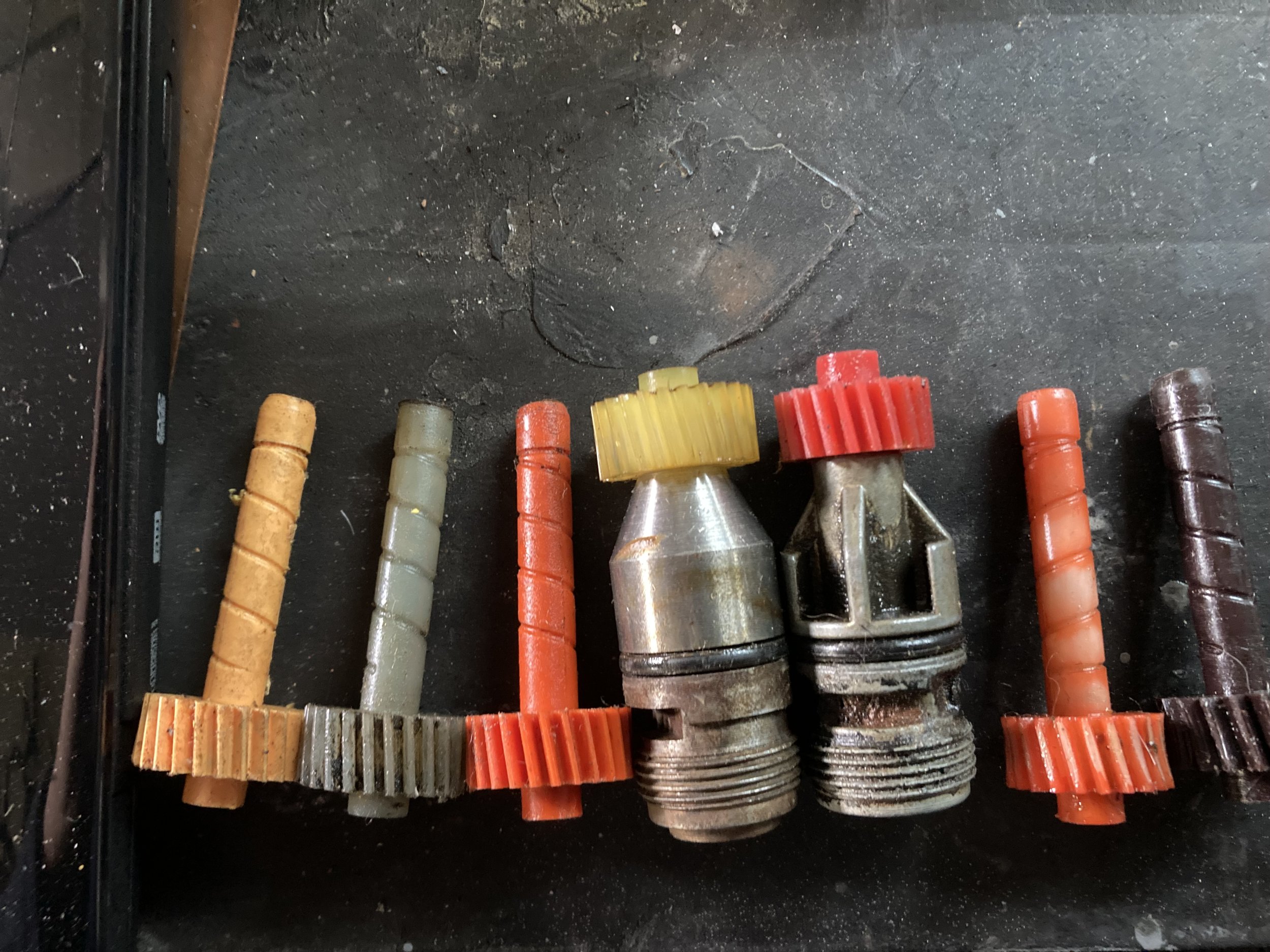

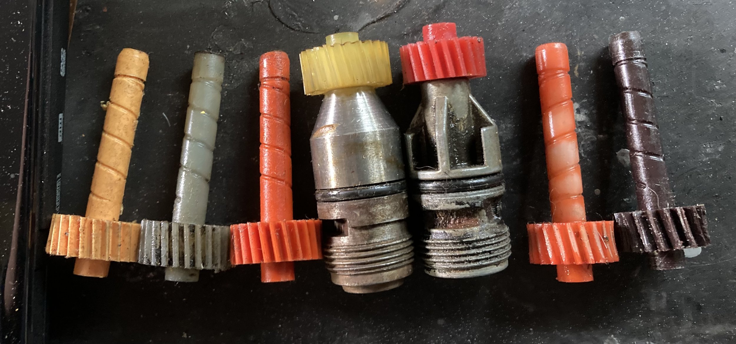

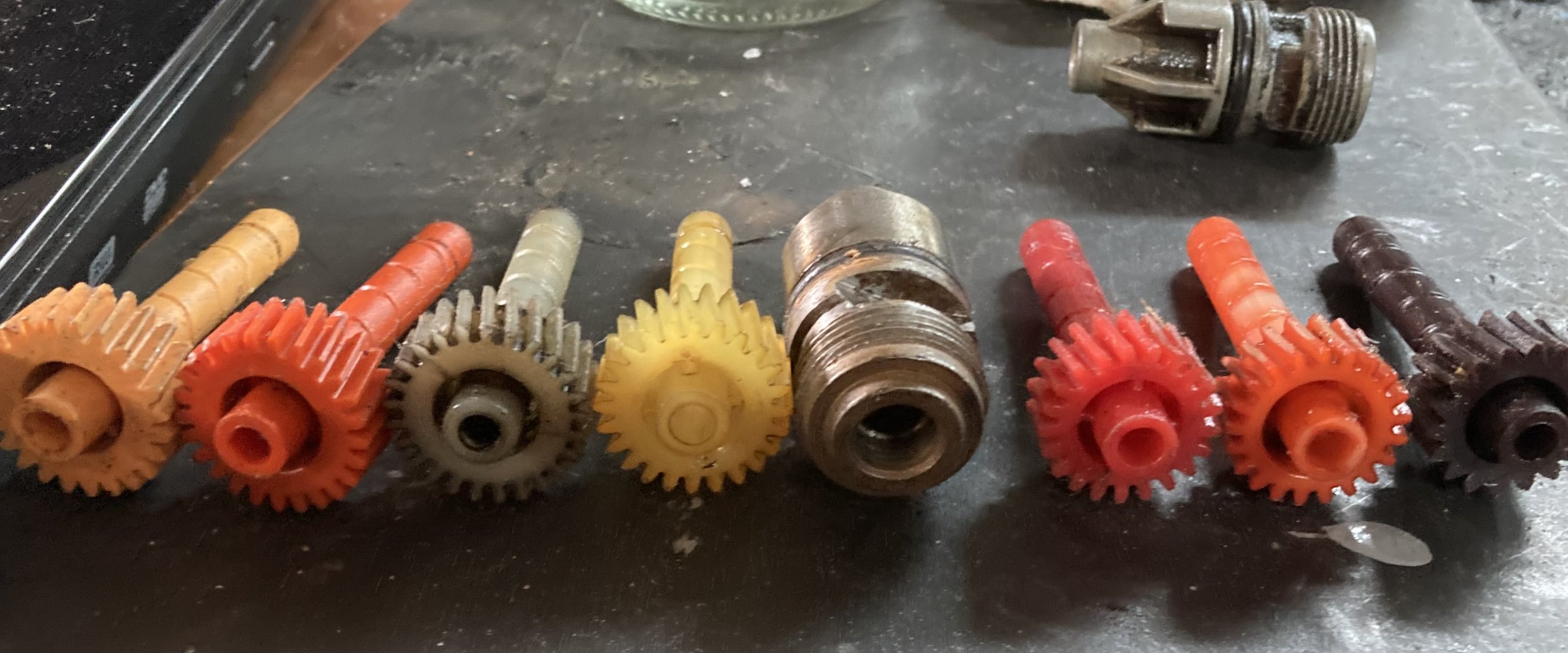

    You have a Muncie 319, that is the Overdrive version. The Driven gears come in different colors which signify different numbers of gear teeth as shown in the chart above.
    The three to the right are for the Muncie transmission, the four from the left are for the Saginaw transmission. Note the difference in tooth count and diameter. Changing tire size will affect speedometer accuracy, you can get a more accurate speed by changing out the Driven Gear.
