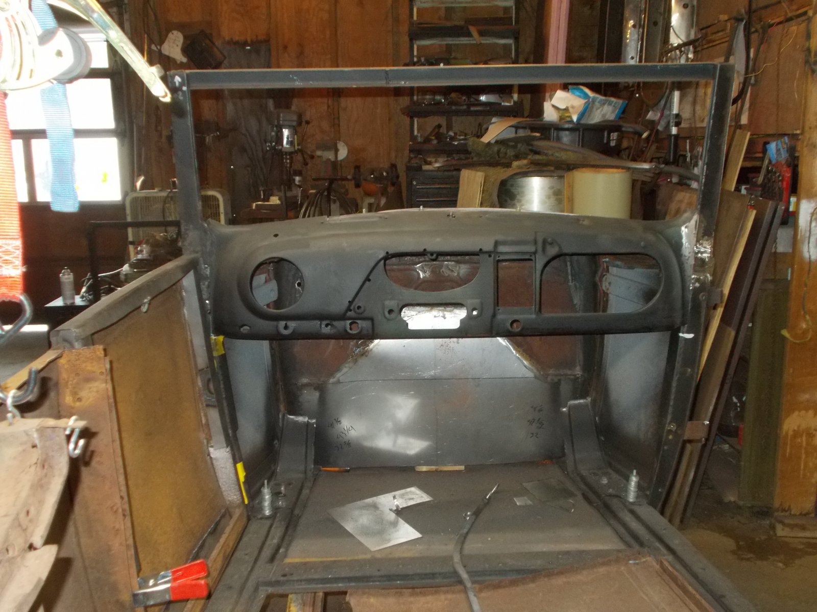

    check out '48 -'52 F1 dashes ... narrowed '48 top pic. narrowed '52 bottom pic...
    they are flush/flat with the A pillar then swoop out into the actual dash ...
    that is the hardest part of modifying a later dash to fit early cars, pic...
