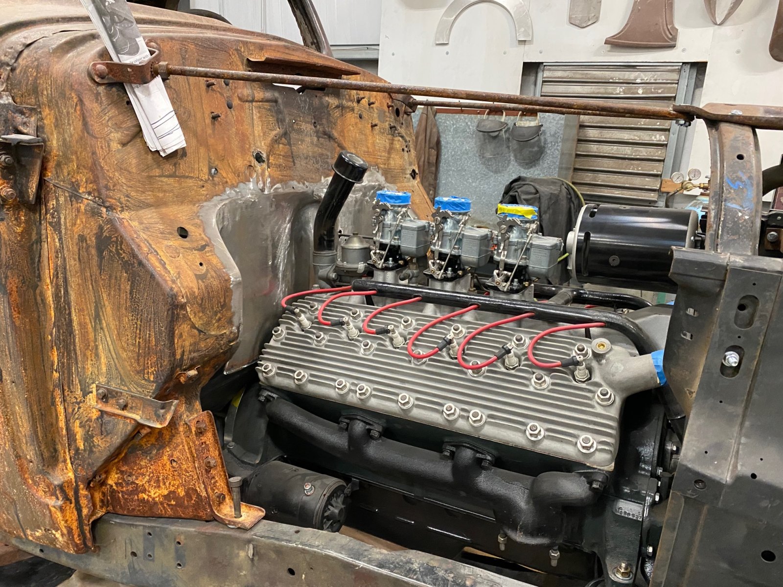

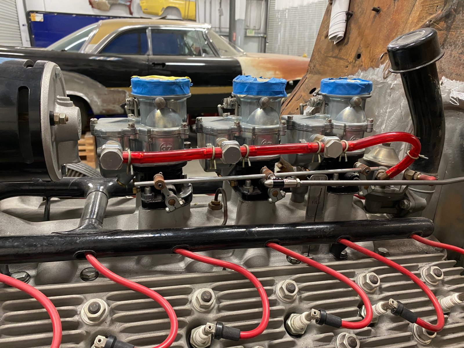

    Hey guys, our shop is installing what looks to be a stock build v12 into a 1937 studebaker truck. The owner hooked up the 3-97s without a progressive linkage so they are all direct hook up. Will this be ok to run? Also, when it comes time to hook up the choke, should I only hook up the center carb choke and leave the other 2 alone? Thanks!

    chokes are nice for the cold starts and after sitting a while, but not really needed. If a good electric pump is installed as a "pusher" (***uming this engine has a mech. pump) a couple of pumps on the carbs ought to start it. A single choke might do it on the center, maybe. I'd try to run it with all three and see how it performs, then maybe block off the end two and try just one. One thing you might consider is the fuel pressure, don't know about those carbs but 3-4 psi seems to be good for most multi applications. Multi's ain't for the faint of heart.

    You will only need a choke on one carb. If I had a choice I’d pick the center carb but not necessary. I think three may run well with straight linkage on a 12 cylinder. You may have to play with the power valve and jet size. I’d stay on the lower than average size range for starters. Get yourself a carb synchronizer and know how to use it. Many do not. 7F487B62-AE9C-4AC2-AE51-50E71DF17680.png

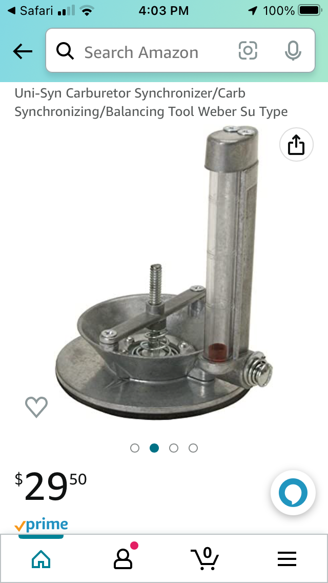

    It appears all three carbs have idle circuit adjustment screws. To get it to run right you need to synchronize the carbs using a tool like this.
    In order to successfully run progressive linkage the two end carbs shouldn't have idle circuits and the throttle plates
    need to seal when the throttle is closed.

    You beat me to it! I like your price better.

    With straight linkage, all carbs will be opened at the same time. You could maybe set that linkage to where the two end carbs are completely closed at idle, then the center carb choke will work good. This may not let the two end carbs open 100%! If all carbs are used at idle, the choke will be less effective. Just my two cents!

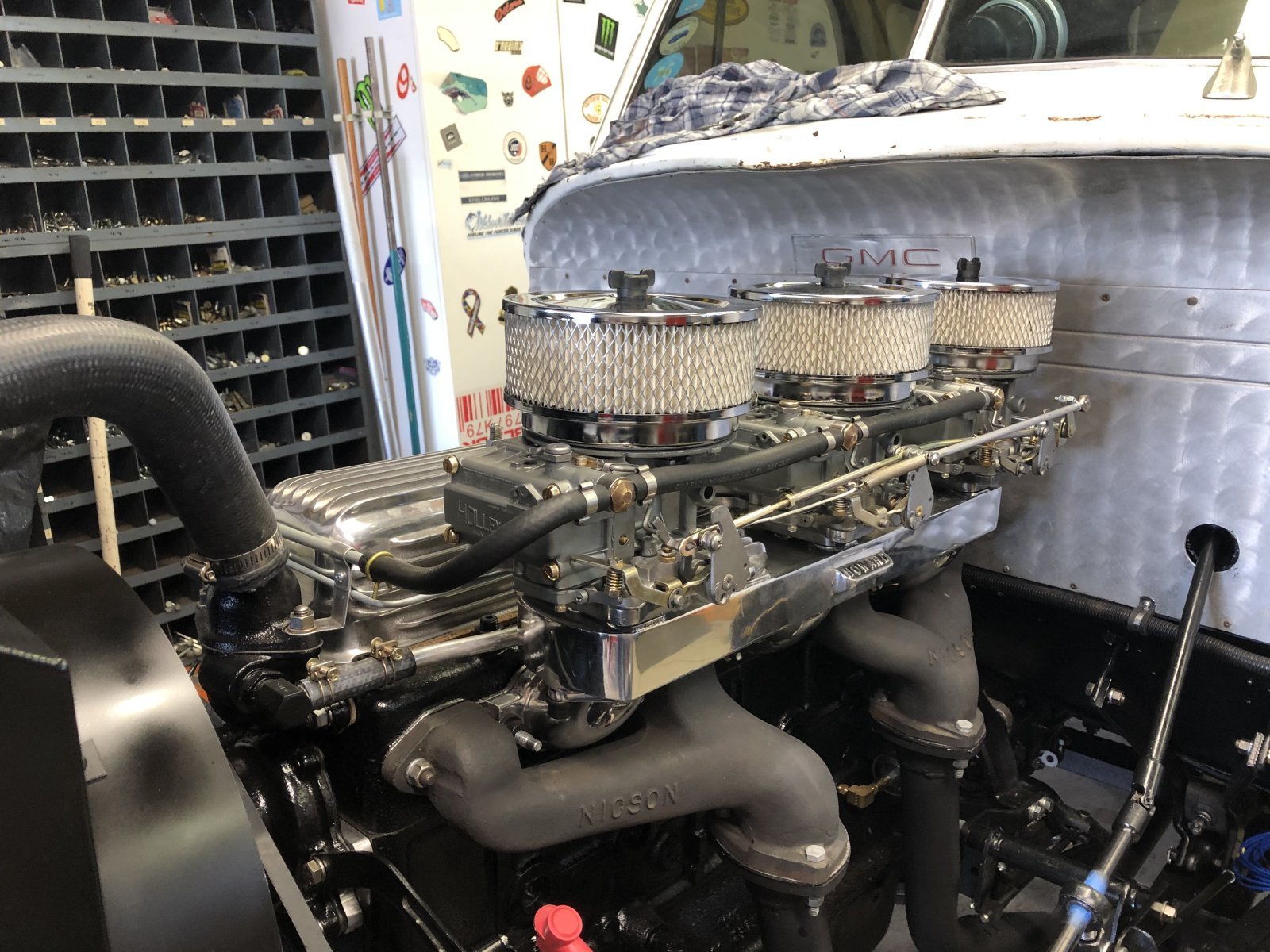

  12. In my opinion, and it's just an opinion, For one choke to work properly you need to run progressive linkage. If not, when the engine is cold, and during warm up, if you open the throttle without chokes on the secondaries it's going to be too lean way to quick. It would likely be just fine after warm up, but a bit persnickety (at best) until reaching operating temp. Personally, with three carbs I'd run a progressive linkage, but my part of the world is colder than yours. :)
    I run 3 deuces on my 390 Galaxie with progressive linkage and 1 choke. It works very well. I'm in the throws of putting dual 94s on my '50 Flathead Ford with straight linkage. It will have both chokes working.

    Put a progressive linkage on it, unless you plan to do drag racing. Only the middle carb gets a choke - treat the other carbs like secondaries, so no choke, disable the power valves and idle mixture screws. You are idling only on the center carb.

    It's easier to get all three working as one unit then is to get two sealed off and made into outer progressive dump carburetors. Start with each setting the same on all three, float, needle hight, mixture, throttle opening, what ever you have to set, do it three times. Once the engine is running, adjust each one the same. An Air/Fuel ratio gauge would be real handy to have for this along with the Uny-Sinc gauge. Once you have it running correctly, hook up the linkage, be sure take and slack out of the linkage so all three move at the same time. You will get a much better fuel distribution with all three work as one.

    You only need one choke on the center carb IF your linkage was progressive. But only choking one carb with non progressive linkage defeats the purpose, and might as well not have any chokes hooked up.

    I like to idle on all three and run on the center. The throttle shaft to base should leak very little on all three. A UniSyn definitely helps and what JoeH suggested, one at a time with plates is an excellant idea. These are not early Ford carbs but work perfect progressive. FAC60A0A-7BA3-4088-ACB0-40142345269E.jpeg

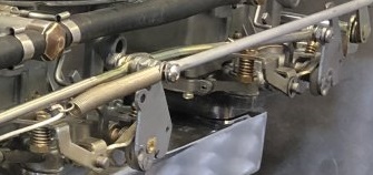

    But that linkage. When I think progressive, I'm not seeing it. Looks to me to be in unison. One movement moves it all. But it looks great. No doubt about that.
  22. I think, and it's hard to see in the picture, that the linkage from the center carb to each secondary carb has a slide that doesn't engage until part way through the throttle travel. That's the way my Holley triples are set up, as the primary opens, the linkage takes up the movement in the slides and then opens the secondaries.
    jimmy six likes this.

    The GMC is 311” 10-1 compression, a reasonable Howard Cam and head work by Mike Kirby; 1.94 intakes and 1.60” exhaust. The carbs are Holley 1960 Mercury 292” and rated at 280 cfm and were used for 20 years on a Clifford manifold.
    “Center of the Galaxie” has it. If you expand the photo the front carb slider is evident. The rear carb slider is actually on the center carb closest to the factor arm linkage. Much of it is from Ford FE’s and some I made. The main actuator on the back of the rear carb is the center crossover arm on an FE dual quad 427 all fed by a cable foot feed. Not my first multi carb set up but definitely my most challenging. The car was my first LSR in 1975, it set many Bonneville and El Mirage records and I gave it to my son 4 years ago and included this engine. 597D0949-DDDA-4B05-914D-0F050F437AFB.jpeg

    FAC60A0A-7BA3-4088-ACB0-40142345269E1.jpg There it is alright, and I did see it, it just looked like it was in a fixed position. You're saying it slides. Crystal clear.
    FAC60A0A-7BA3-4088-ACB0-40142345269E12.jpg I'll take your word on it that it works the way you say.

    That’s an early photo during the build even tho it had been run. The rod going to the rear carb does have the same slot and was adjusted later to have the same gap as the front so it would be more evident. You would think the slot would be at the rear carb but it fit better in the opposite direction.
