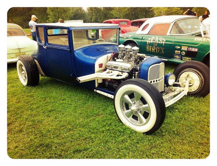

    upload_2023-9-14_10-8-54.png 3 x 2 on a 348 impala
    Hello,
    We ran the stock 3 x 2 on our 58 Impala. it gave us 280 hp at full throttle. but, around town, the center two barrel ran all of the time. for gas usage, that was great. When I stepped on the throttle, it was gentle and not forcing anything. But, the power of the 348 motor was available when and if I needed it. the center two barrel is the ultimate for normal daily street driving and road trips on highways.
    My friend started with the 4 barrel on his 57 283 motor. It was a great running motor and again, ran the two barrel until the other side was necessary on a full throttle escapade. So, again, great gas mileage, good power for all normal daily driving to school, cruising around and on open highways. But, if and when the other two barrel was necessary, it came alive. 4 full barrels.
    But, he had a deal working for him. Another friend did not like his dual 4 barrel carb set up on a Corvette. He was not worried about gas mileage, but drivability around town. 90% of everyday driving was with a four barrels, when he stomped on the throttle, now all 8 barrels were in action and the Corvette took off. Yes, we drove that 60 Corvette around and it did have a lot of power. At the time, any lightweight fibergl*** bodied sporty car with a powerful motor was intimidating with the combination of power and weight.
    So, we traded the dual 4 barrel manifold/carb set up for the single 4 barrel carb set up. The cost was minimal as the trade off was that we did the work and the older friend was now happy with a single 4 barrel carb for everyday driving. Acceleration was perfect, and there was still plenty of power for the Corvette to accelerate and feel like a fast sporty car.
    My friend’s dual 4 barrel set up was now adding some extra horsepower to his 283 with a cam and headers set up. When we finished, it was so much more powerful. We also installed a complete 4 speed and Positraction third member to round out the street performer. What about the drivability of the dual quads?
    Although the two barrels on each carb were functioning like a full 4 barrel carb, it did use up more gasoline. But when the throttle was pushed down, the effect of another 4 barrel carb came into play. the surge was outstanding. Now, I had a functioning 2 barrel carb on my 348 with the additional 4 barrel power when I needed it. my friend had a 4 barrel running all of the time and had an additional 4 barrel power on hand for any extra encounters.
    Jnaki
    For everyday street driving, I stay with the factory vacuum linkage process. It never failed and came on when I needed it. The progressive linkage I put on was ok for the all out dragstrip acceleration day/night events, but just awful for the street, without the other two carbs coming into play. So, I stayed with the vacuum linkage for the rest of the days I owned the 58 Impala.
    For normal everyday driving and long distance road trips, a fully functioning center two barrel carb will work the best and will make easy driving in any traffic. For strictly racing, the dual quad set up is probably better and it will be up to you as to how your use your hot rod or cruiser. I would get a three two barrel carb set up over a dual quad set up.
    Note:
    When my brother and I were in the process of getting our 283 Isky Cam/Jahns Pistons motor running, we were offered a choice of dual quads (our first choice) versus a 6 carb Stromberg set up. The local speed shop owner said both are good set ups. For the drags, the 6 carbs would be better for more power. But, it did run on the center 2 two barrel carbs until the progressive linkage came on with the other 4 carburetors kicking in full throttle mode. Or the whole 6 carb set up could be linked all together at once.
    I would go with the three two barrel set up for the street’s everyday driving. YRMV

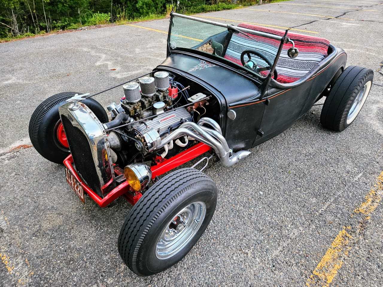

    This is my new build setup….screams hot rod

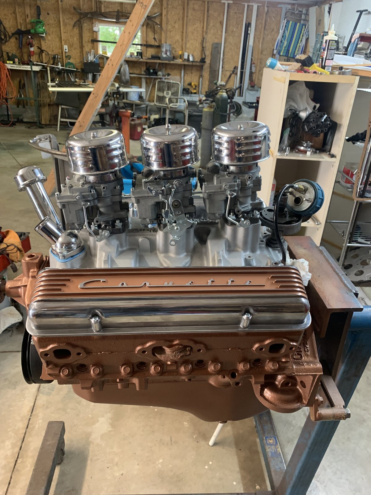

    Here's my answer. Just picked this up at swap meet last Saturday. 20230910_150405.jpg

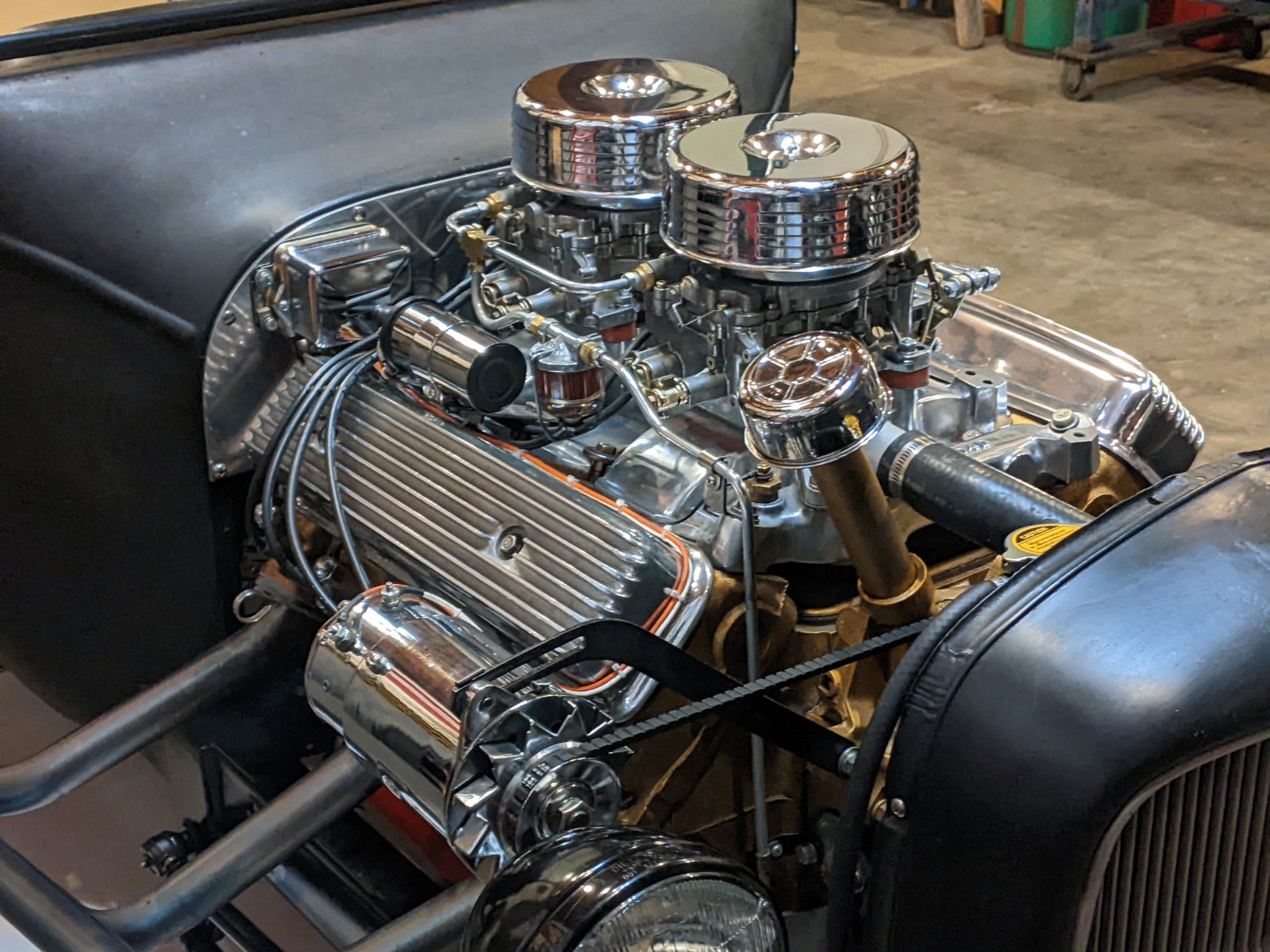

    I'm a 2x4 guy and a firm believer in 1 to 1 linkage on them, 2x4's just make a statement of all business. Three out of four of my cars are currently running dual quads and the fourth will be too as soon as I get the engine together.
    On the way home tonight from a cruise night I put my automatic in full manual mode and let it sing, sure sounds great at rpm.
    Even the deer come out to see dual quads
