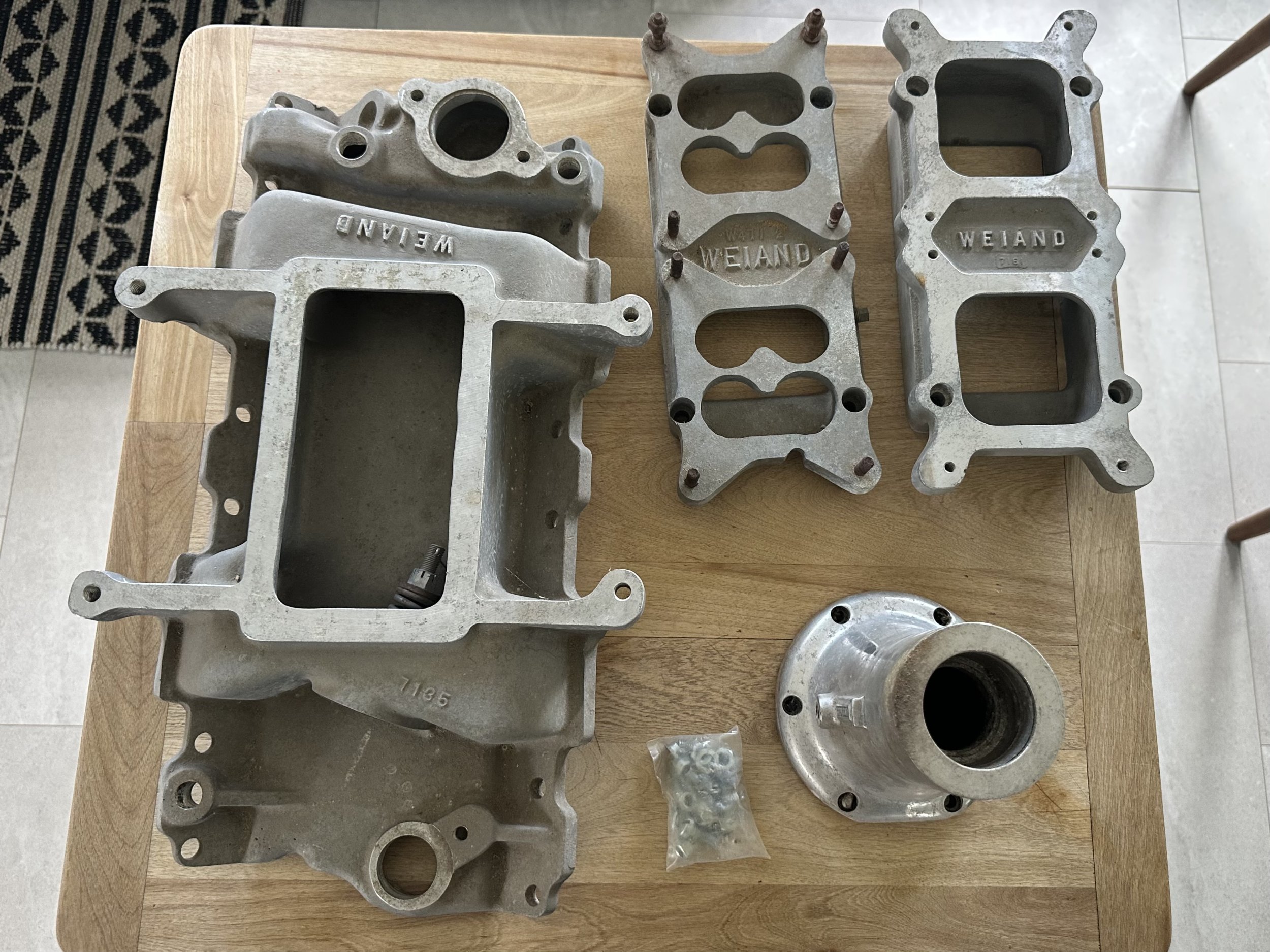

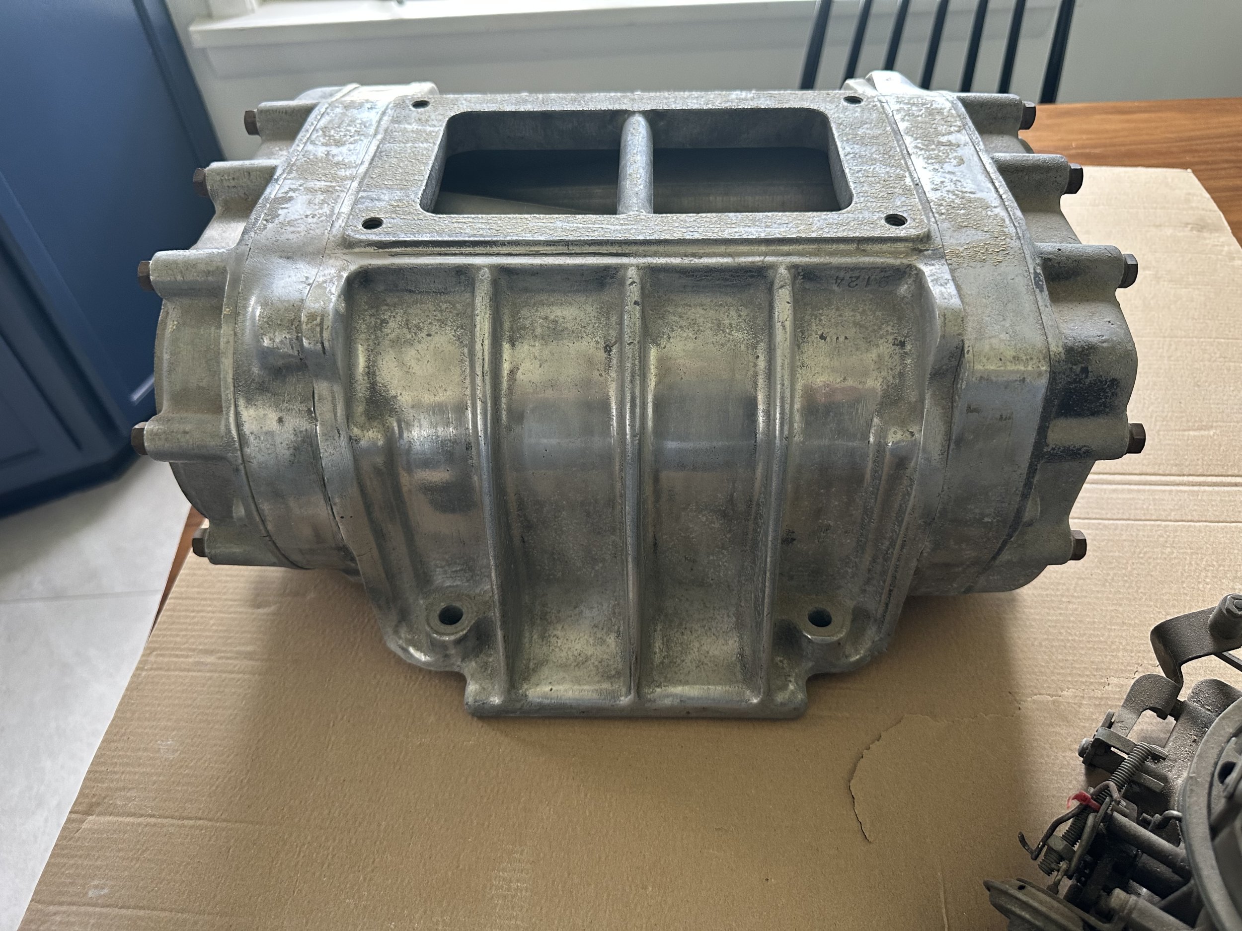

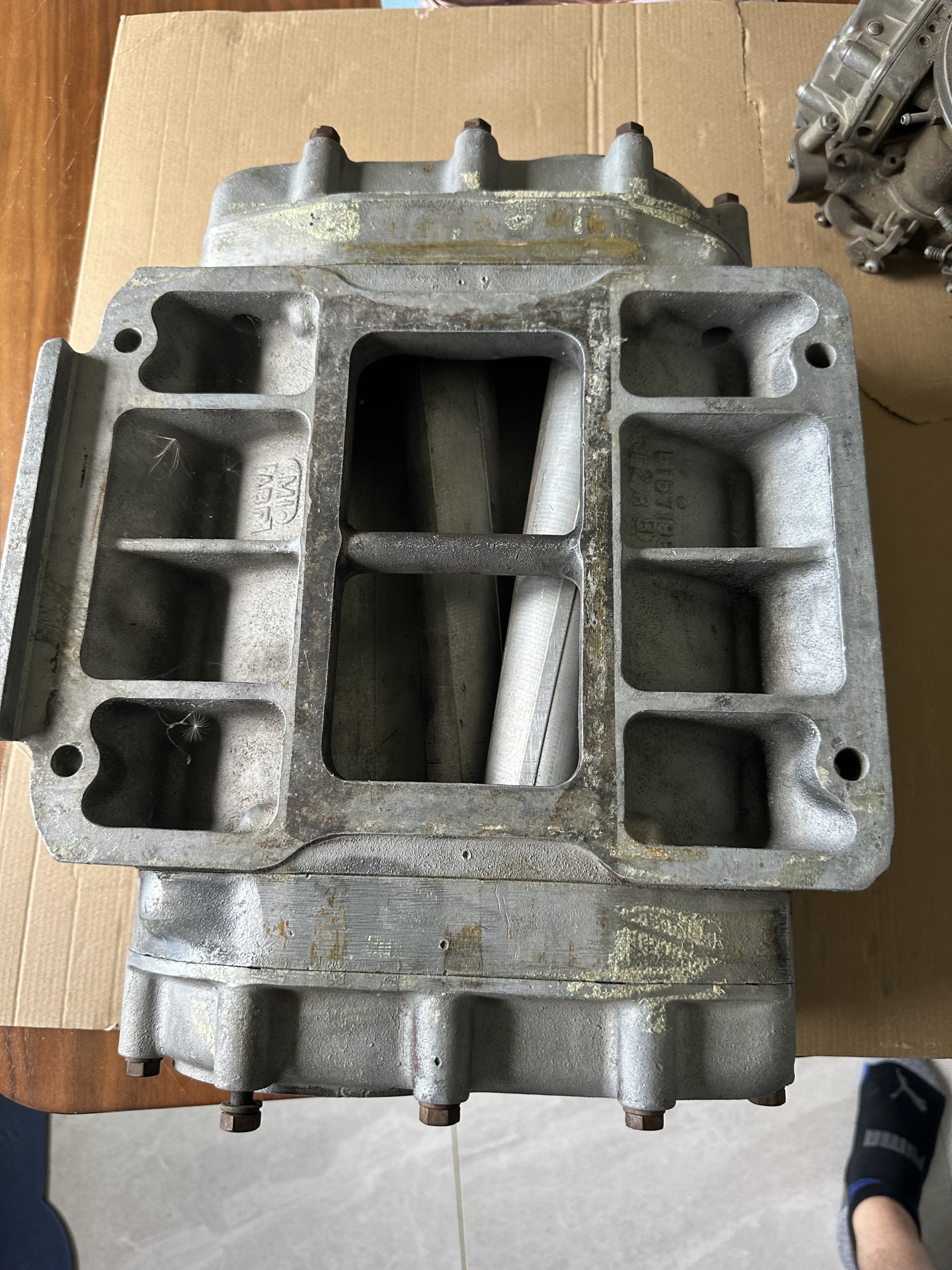

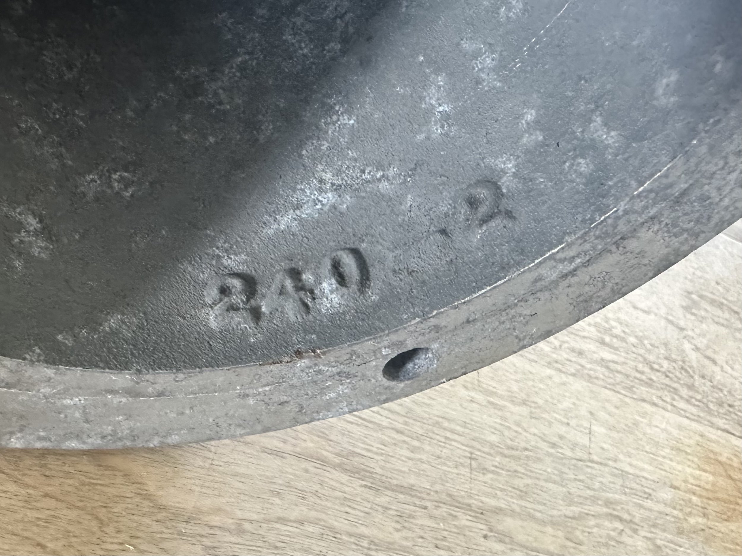

    I’ve done some research, but school me on what I have and what I still need.
    I’ve known about these parts for a few years and my friend finally wanted to let them go. I’ve been focused on my 60 ElCo but have a 283 powered ‘35 3 window that’s been on the back burner. This 4-71 is perfect for it.

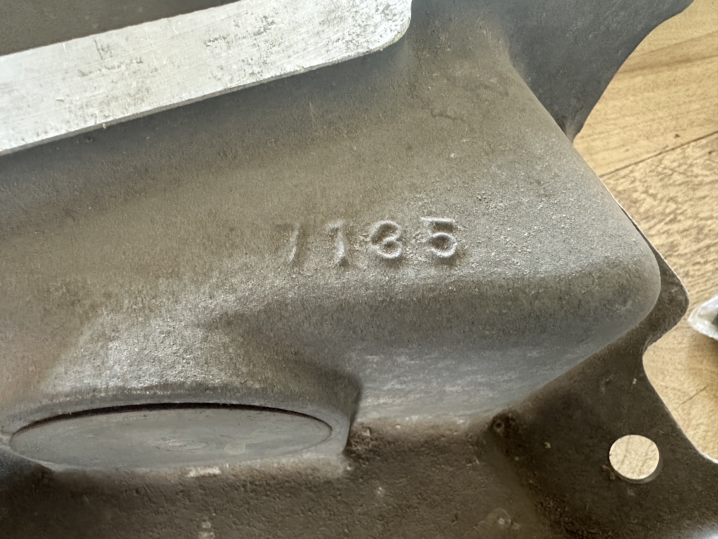

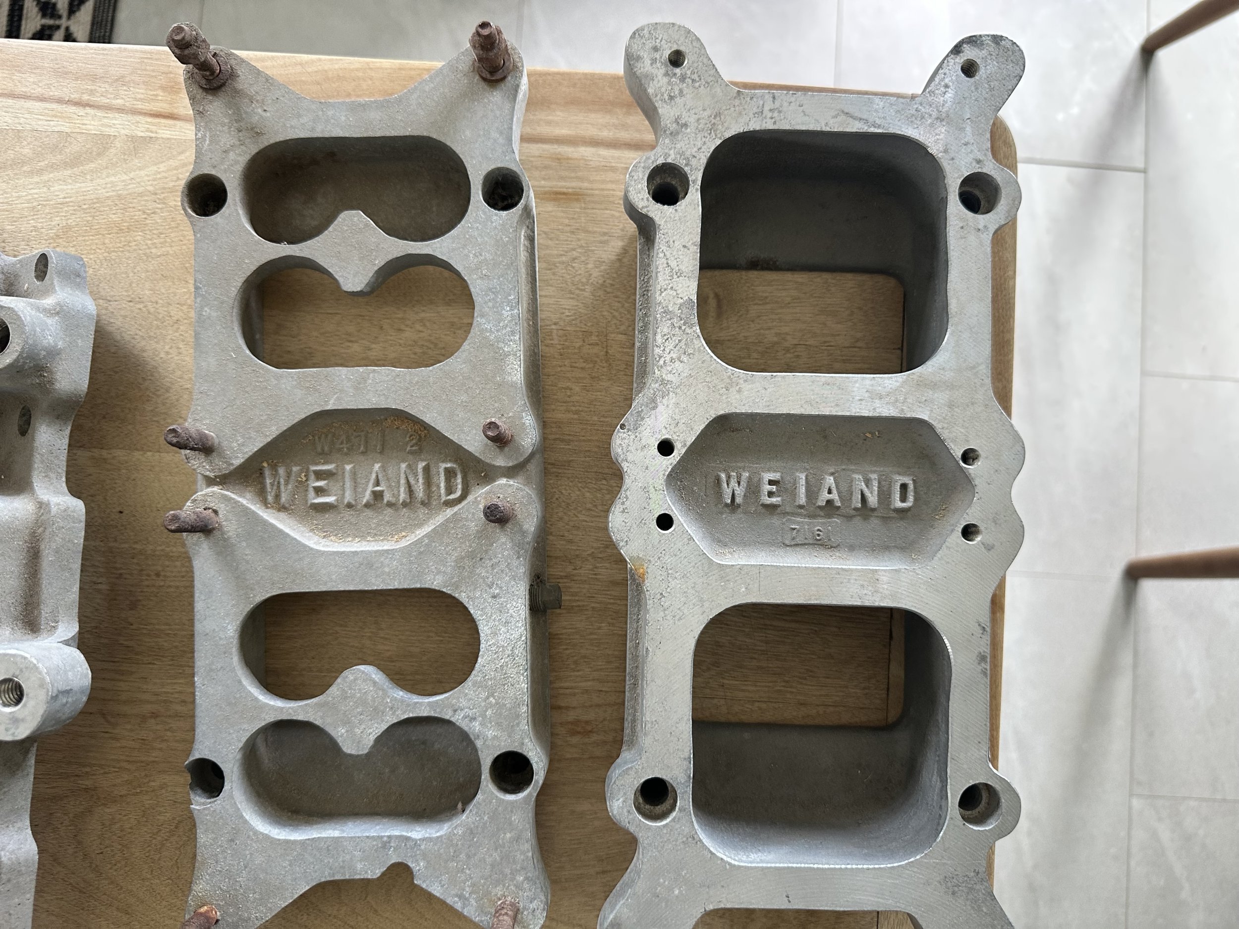

    I think this is a “later” Weiand 7135 SBC manifold because the logo is smaller lettered. There are the two dual quad adapters, one older, the Cragar snout, and the blower. I think the blower is basically stock GMC and someone started polishing it.

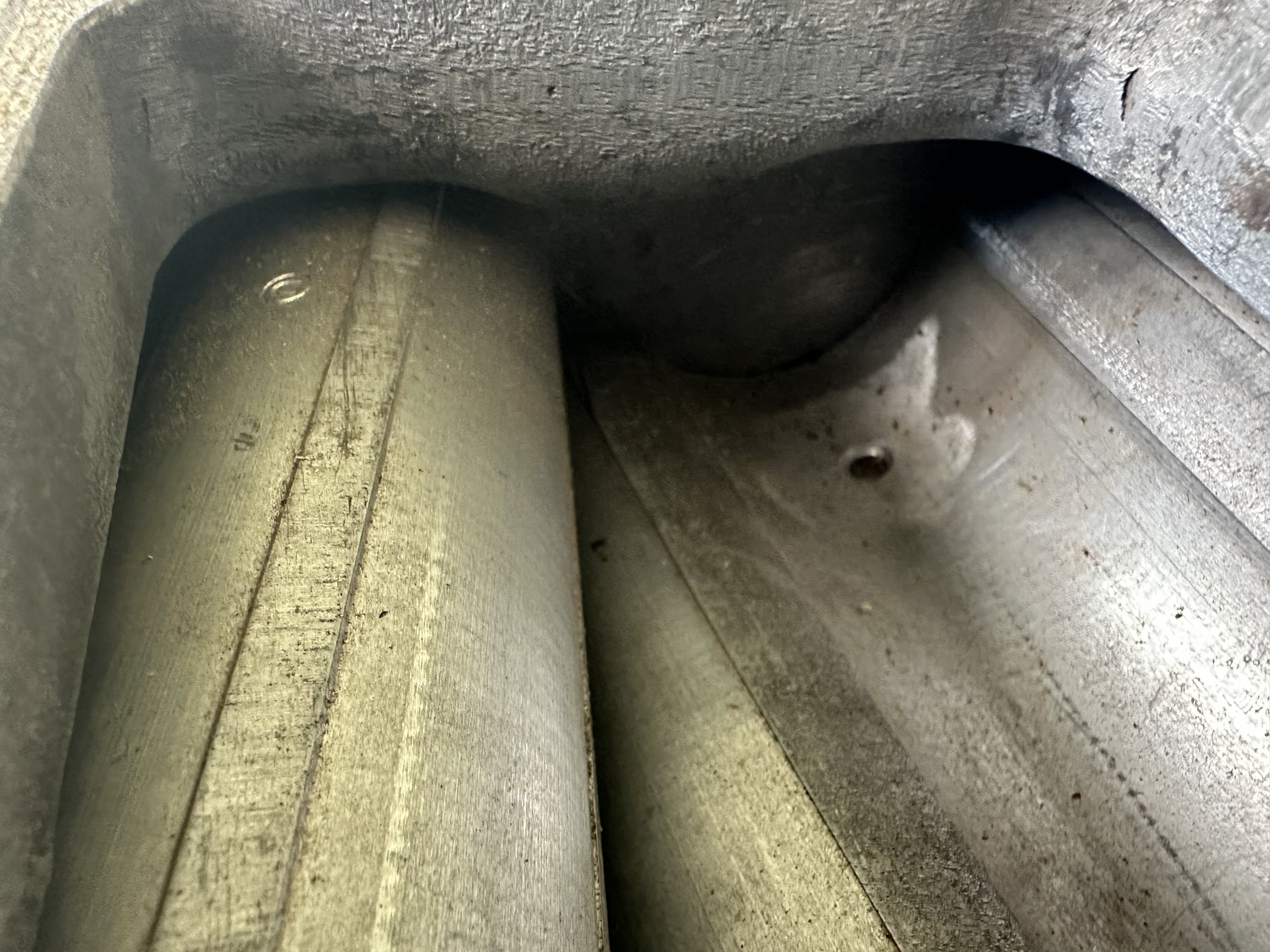

    How do I tell if the blower has been set up for gas hotrod use?
    Any idea on the vintage of the intake?
    I think I need a drive setup including the snout arm, the shaft for the snout, a back plate, a triangle plate, and whatever internal stuff the blower needs. What else?
    The plan for the car has been a ‘58 283, ‘60 T10, and a 9”. I’ve got 327s around, but I wanted to focus on a late 50’s kinda build. Would this blower be happier on a 327 or a 283?
    V belt drives are super cool, but the gilmer drive belt whine is great too. I guess I need to make a decision there…
    This is a long term kinda project so I’m not in a hurry for the missing parts. I’m focused on the ElCo but when stuff like this turns up you’ve got to grab it!

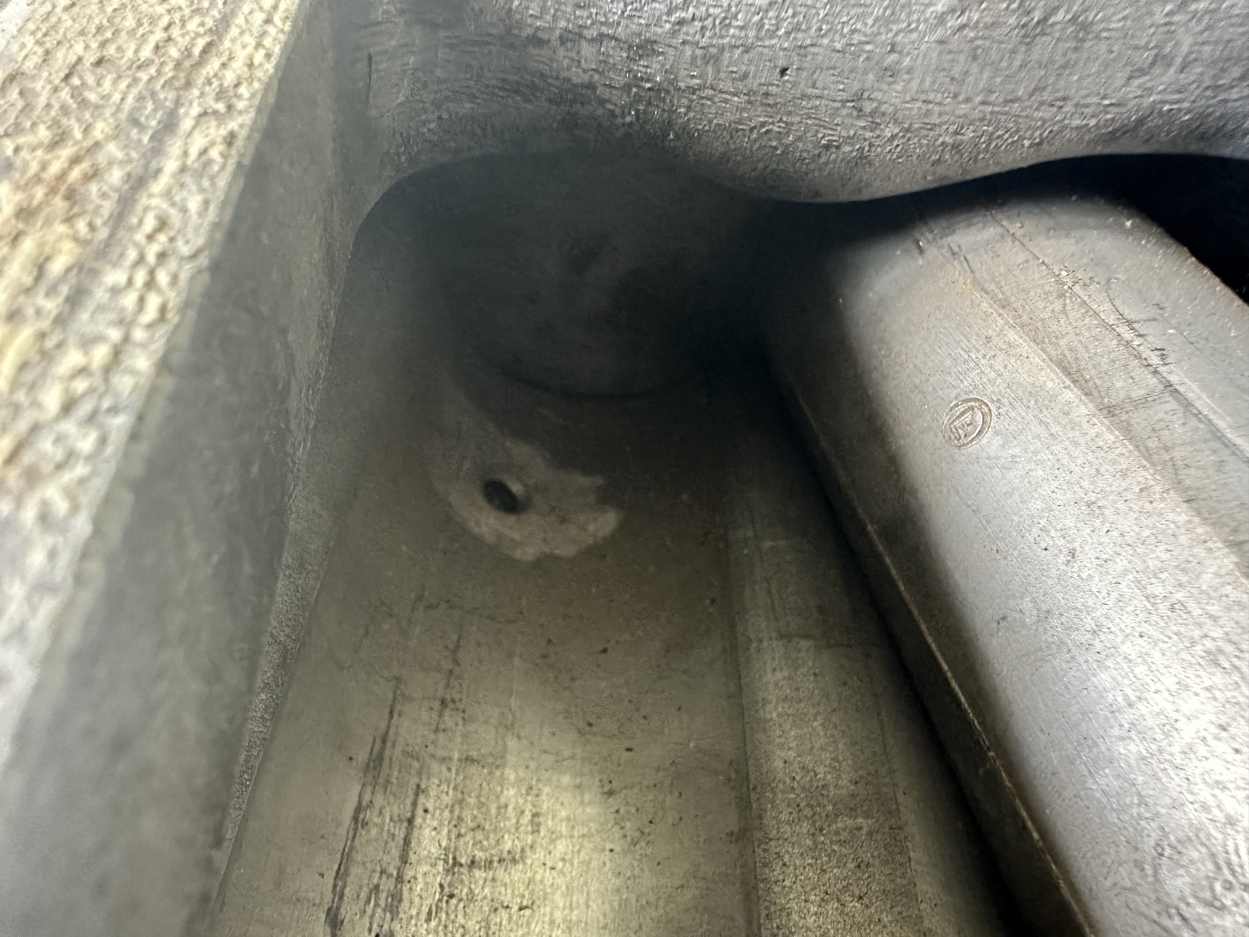

    since it still has the "lip" on the base, it's pretty likely that it was never converted.

    Nice score! Perfect for a SBC. The blower will not care what's it's sitting on. Just do some homework and pull together a collection of parts that will play nice together for the street application. Nothing radical required. Moderate static CR, choose your pistons carefully, and don't get carried with drive ratio. Pumping air generates heat. Depending on your background, patience, and tooling it's not beyond a DYI conversion. But also lots of places to send it out.

    That mounting lip is the first thing I always seem to notice on original GMC blowers.
    I had my nose in lots of magazines starting in my teens, often wondered what the lip was for, then an older brother of a grade school pal of mine said it was to support the weight while installing them because they were mounted on the side of GMC diesel engines.
    Another thing I will never forget was him saying that when he was in the Navy in the mid 60's they dumped A BUNCH of 6:71's in San Diego Bay:eek:, something about surplus and such.

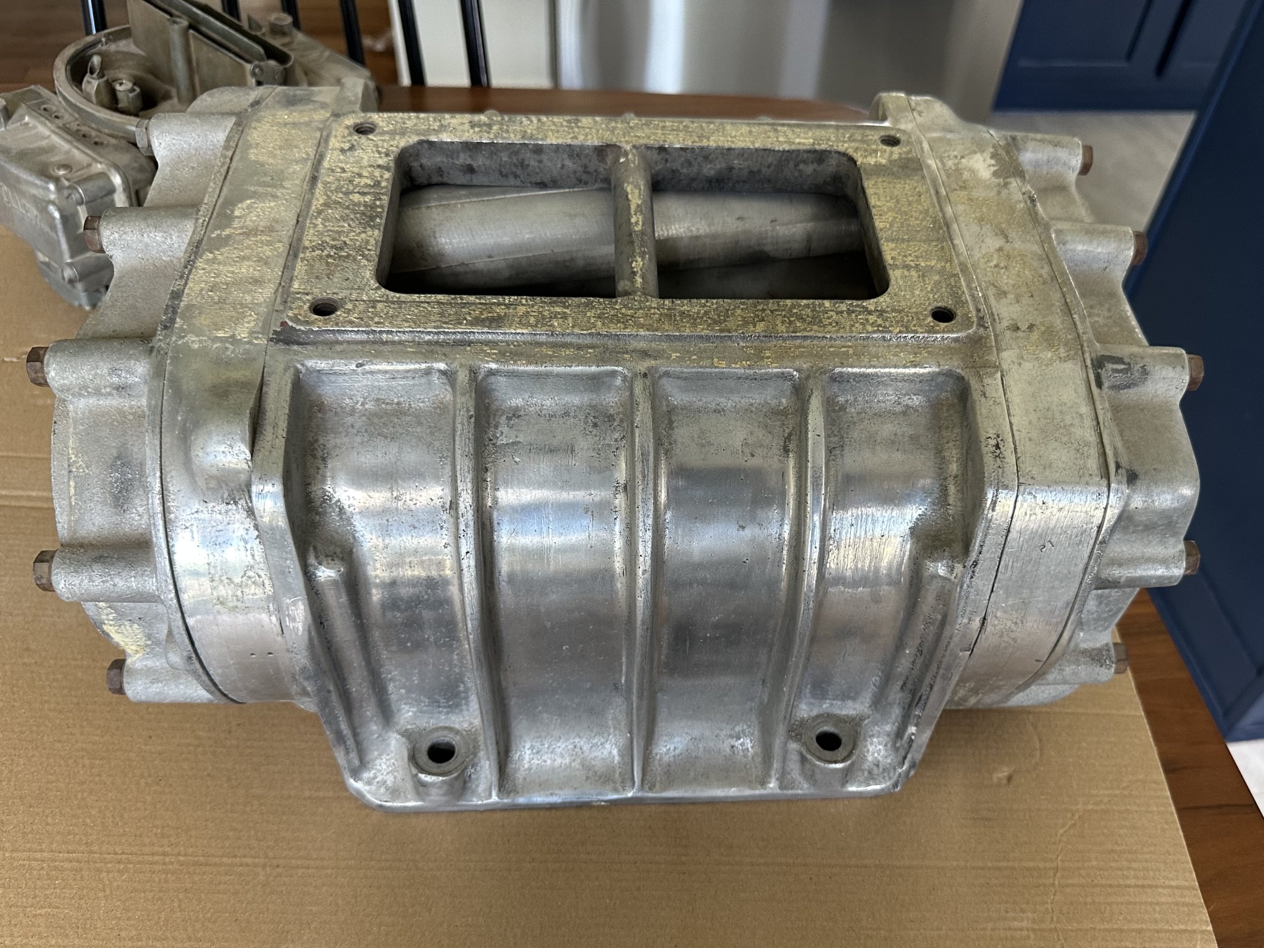

    The more I look at it, the more I think it’s stock.

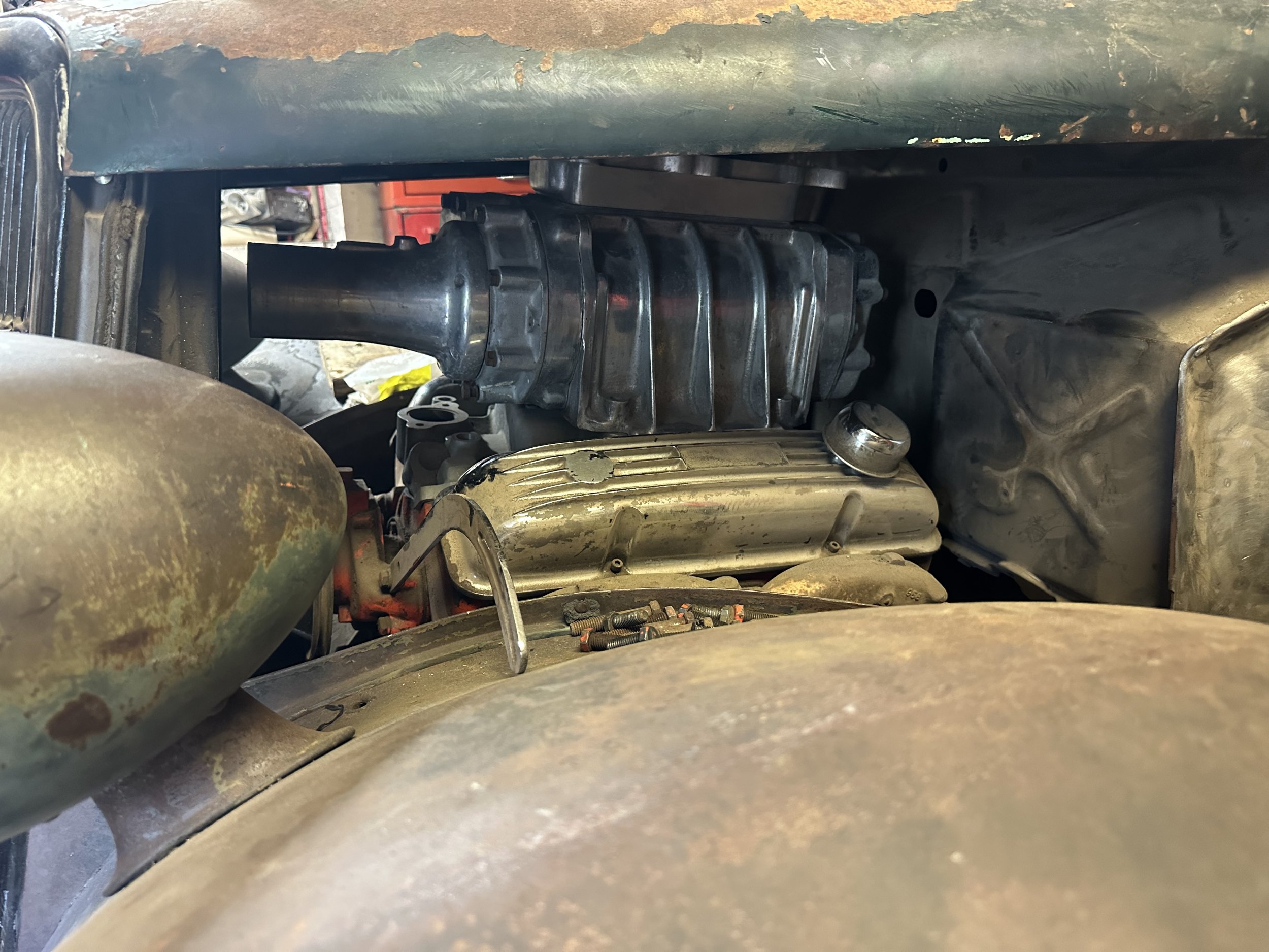

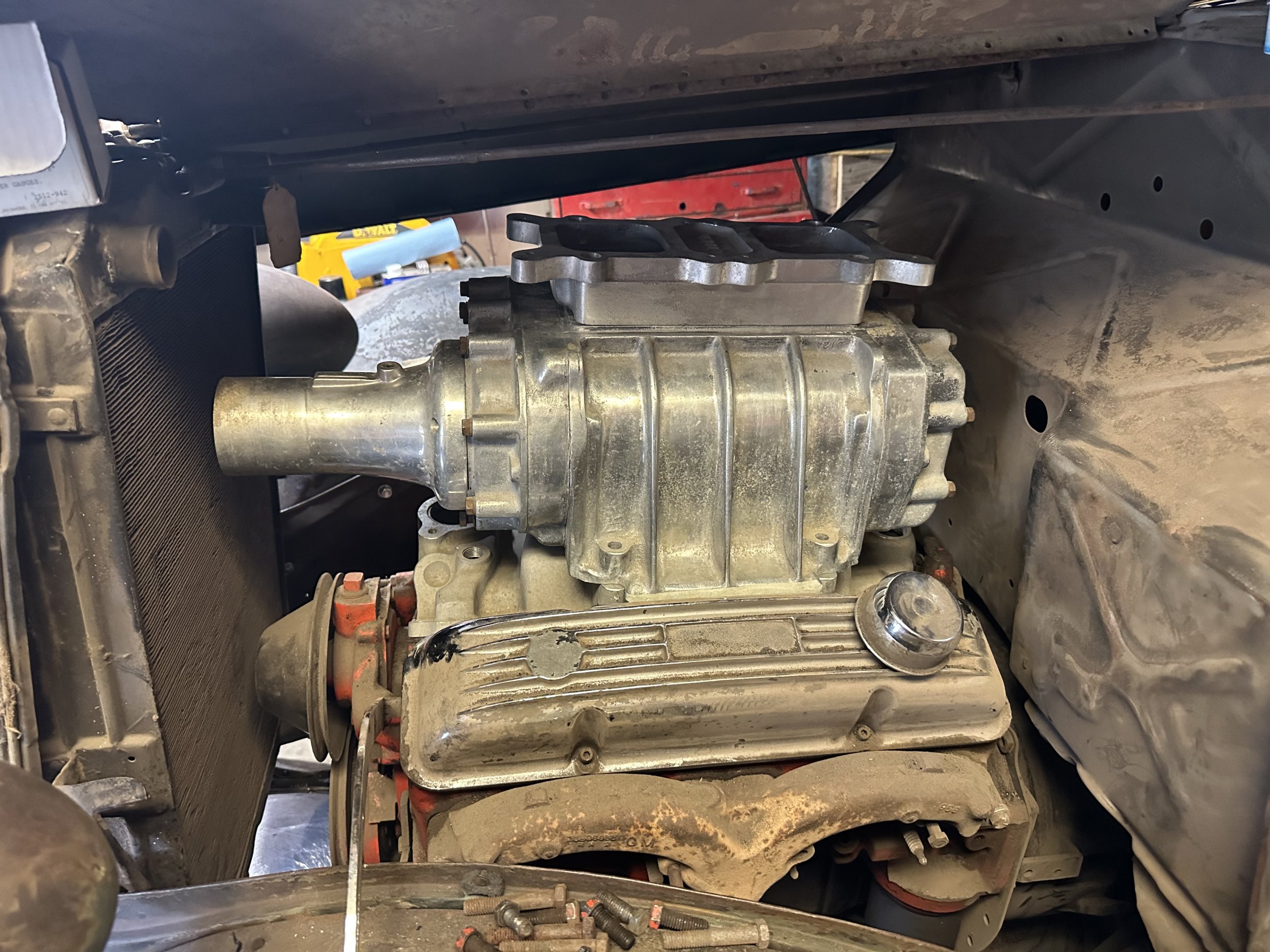

    I’m have a can do at***ude and good tools including a mill. Unfortunately the garage the mill is in has no power. My projects have projects. I’m on the fence about sending it out, luckily I have time to decide. There’s a guy on YouTube who goes through everything on a 6-71, and it looks approachable, just involved.
    The mounting lip hits my valve cover. The blower won’t sit flat on the intake. I need to prune it. When my grandpa was in the Air Force, he saw tons of usable stuff get bulldozed into the ocean in Hawaii. He never talked about superchargers though.
    I had to test fit!
    I should set some carbs on it too.

    I seem to remember an article in an old Hot Rod magazine about converting those blowers, don’t know what year. Anyway, it showed the lip being removed using a bandsaw, carefully running the blade just next to the overhang. No machining required. Again time for squirrel to chime in…

    If its just compressing air, how does it know if its on a diesel or a gas motor, and why would it care?
    Never had one, didn't know they had to be "set up" for gas. Thanks for the education. Correction, air /fuel mix, but again whats the difference?

    Think about the RPM it works at, and the pressure. Different clearances, mainly.

    You did not mention a price,
    The value is really in the intake
    Crager Snout , carb adapters,
    The 4:71 to convert No big deal
    Mill / Lathe make it easier but really not needed , Unless you trying to build set up as stage 2 plus ,
    5-7 psi 283 -327 5,500 ish.
    Mark gears & rotors @ tear down.
    Cut or file Lip off .
    Main thing ,seals .
    Bearings ,,, I have used stock on spinning 5,000 engine Rpms ,
    There are charts / formulas for rotor RPMS . Then translate to bearing speed.
    Modify stock rear end plate ,
    Plug oil drain holes ,
    Out side thinking to make a snout axle
    2 used pulleys $50 each , new $100ish
    Belt , $50 -100
    Idler make or buy , $150- 400
    Off top of head ,can not remember
    Diesel rotor clearances , gas around
    .006 .
    Long straight edge with sandpaper complete even stroke to knock Rotors
    Down , if to loos , Just will need to spin little harder

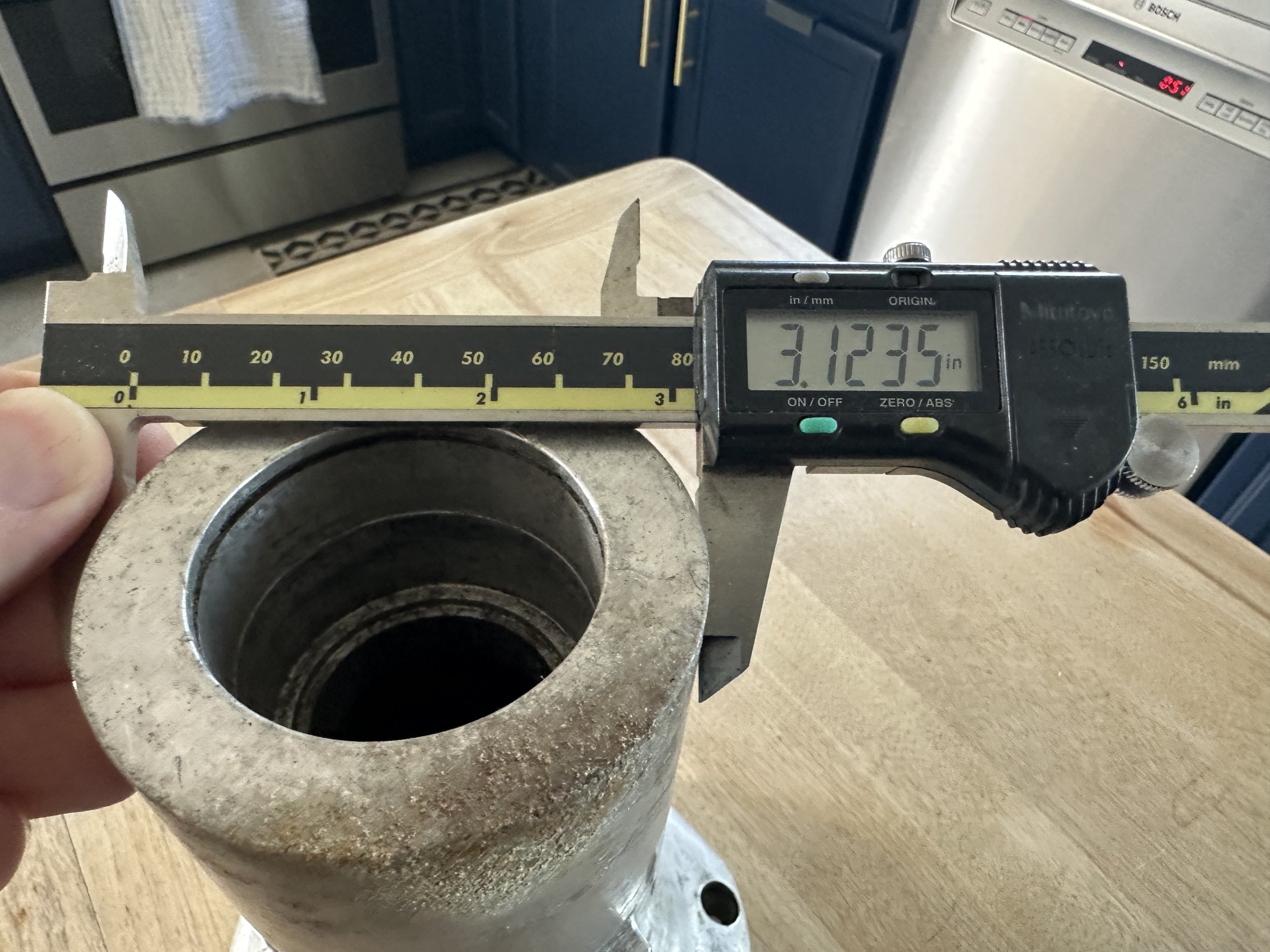

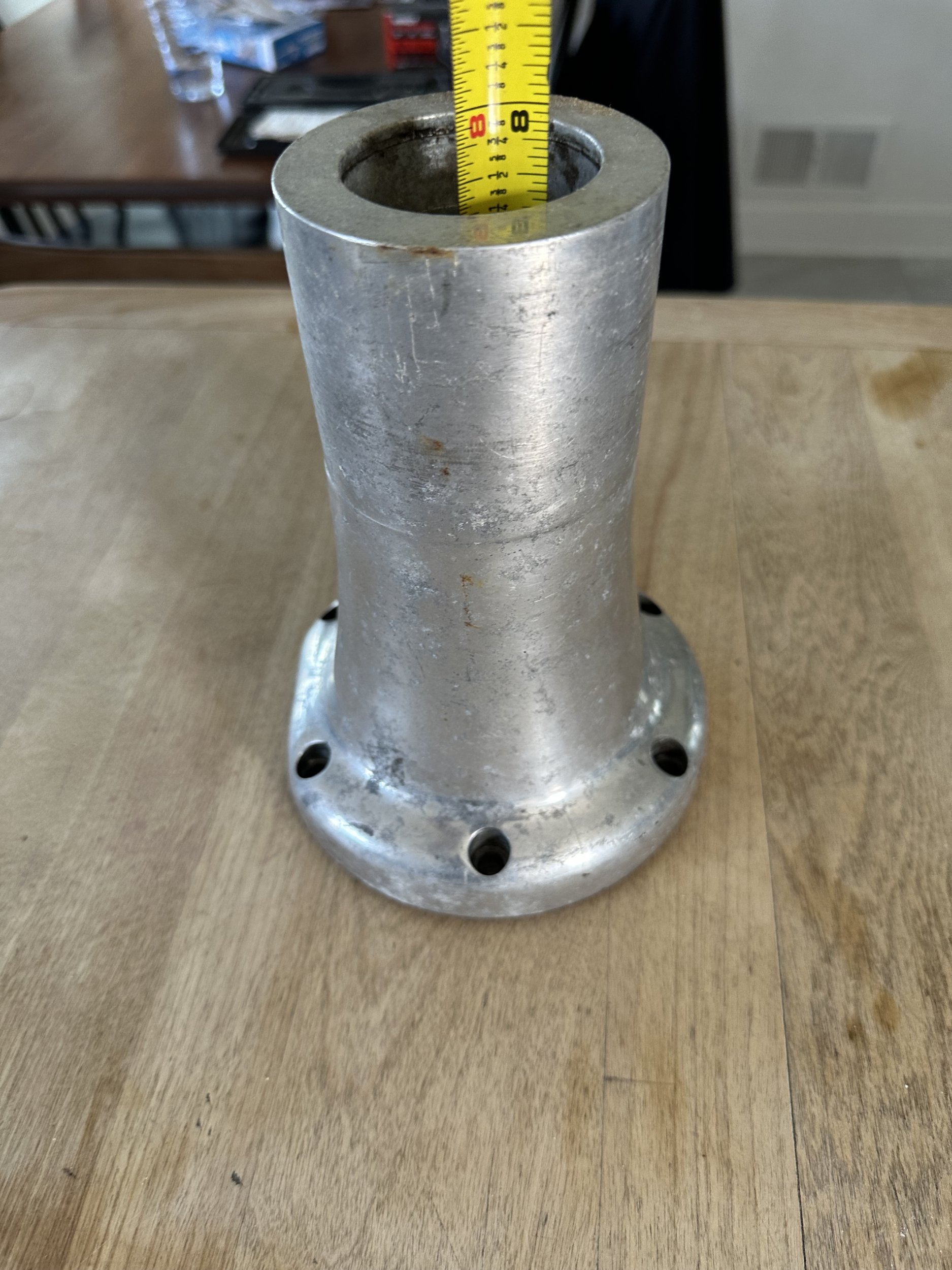

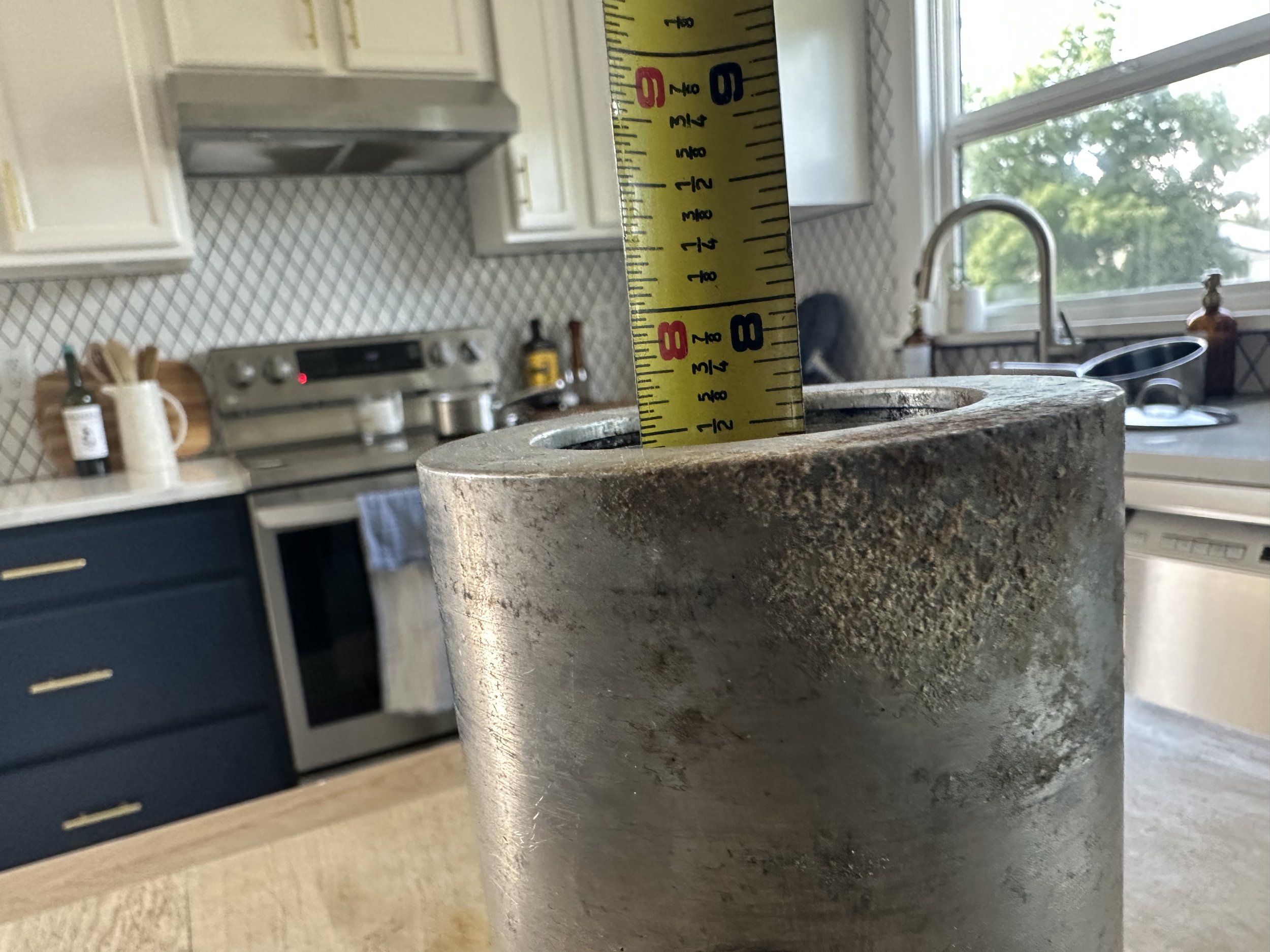

    Anyone know anything about Cragar blower part numbers and dimensions? I want to make sure this snout works for my application. 240-2.

    I have a snout that length on my small block in a 32 coupe. Works perfect.

    Are you going to Make or buy Parts ?
    Or both , Its simple if you have a understanding Of parts ,
    A Lathe more likely is needed , to fit whats needed.
    Crager , I do not know if they made own part , contracted out, or sold
    There wrights to another ,
    I have not hand hands on Crager
    Since early 80s
    You will need a coupler on rotor gear ,
    Bearing Od to press in snout , usually held in place with clip ,
    Then you have OD size of axle to
    ID of bearing ,
    Look's you will need 10 inch axle ,
    There @ least 1-1/2 to 2.00 that slides into Rotor coupler,
    You can extend the pulley Flang out from end .
    Then bolts pattern for pulley ( Flang)
    Some areveven on all six , then there is
    Industrial witch is Not ,
    Some have Both patterns
    Some are custom patterns . One off's .
    A new snout / coupler is around
    $600 , but over Years there different
    Splines , Axle sizes ,
    bearing , there are different spec for loads , speeds , sealed , Non ,
    single rollers , double roller

    Somehow I missed the notification on this reply, sorry! This is all really helpful. I’ve looked at a bunch of pics of currently available snouts but haven’t seen one in person or dis***embled pics yet. I’m guessing the driveshaft is either press fit or circlipped into the snout bearing that is circlipped into the snout? And the whole snout/driveshaft slip fits into the coupler that is bolted to the gears?
    My Cragar snout looks like it’s bored for two bearings, a circlip, and a seal. I’ve seen old catalog pics that suggest the driveshaft for the V belt pulley is a straight shaft with a flange for the drive gear end and a taper with a threaded end for the pulley. Is that right? When the Cragar snouts were Gilmer drive, did they use the same or setup or the current style I’m seeing now?

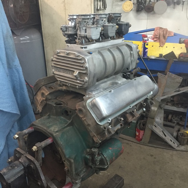

    I was able to get a 3 inch 8mm in my
    Duce In stock location with Walker Z
    For Fenders , Hood ,Fire Wall stock location , Its all tight , to get Top Pulley
    Off I have to take off the Rad to fire wall rods & tilt the Rad forward on springs , this is 6:71 with short drive & I use the Waterpump idler bracket & I think my
    E -Fan was for a Ferrari ,
    That fan pulls close to 50 amps .
    On all my blowers I use 8 mm
    From Vortec off 90s fox , then B&M 144 to 6,8, 10 ,, My 12 I use 14mm
    I do not have a 3 or 4
