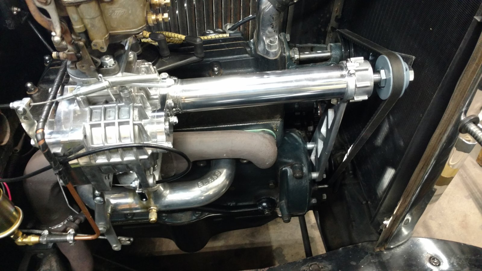

    I ran this for a little while on an A banger I had in my Cabriolet.....maybe 500 miles or so.
    It produced about 3 lbs of boost....and flattened out the hills and changed the throttle response. I run around between 5200' and 7200' elevation so it was giving me roughly sea level performance...not going to hurt the engine...
    It had a Lion II head with 7:1 compression and a Holley 94
    Aaron Loveless makes a kit and it goes on a AMR500 blower.
    The trick is finding a good blower. They are cheap on the web but all of them are used.
    I've refurbished a couple but they are tedious to ***emble.
    I will probably re-install it again at some time in the future and run it some more on a B engine
    INVISIBLEKID, jet996 and '29 Gizmo like this.

    Agreed...my experience is that it took the hopped up engine to sea level performance. I have a 'calibration hill' that I pull for performance comparison. It is roughly 4% grade over a distance of 3 miles and tops out at 7200' elevation. No blower, same car, same engine etc. no blower, tops the hill at 52 mph. Add blower 65 mph and pulling
    Everybody talks boost....actually with this set up, no blower there is manifold vacuum at full throttle of around 2+" water column
    with the blower, full throttle, slightly positive manifold pressure.... the pressure change due to added volume
    My set-up isn't optimum but it sure is fun and garners a lot of attention
    Am I going to win any races, against even the stock 216 in my '39 Chevy 4 door sedan, no
    will it keep me from impeding traffic and impatient drivers that get pissy easily following a stock powered Model A up this hill at 40-45 mph , yes
