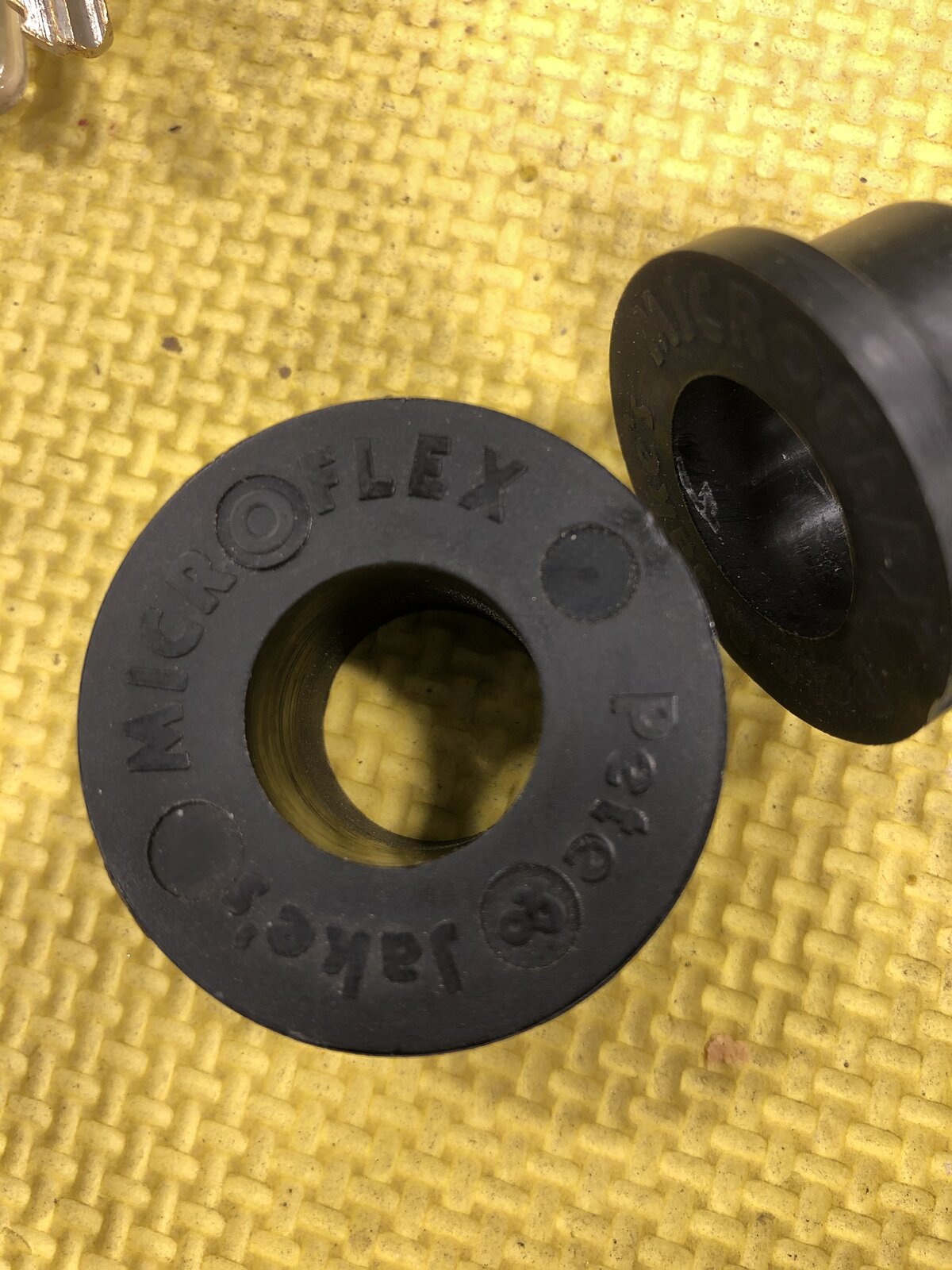

  18. ronzmtrwrx
    Joined: Sep 9, 2008
    Posts: 1,596
    ronzmtrwrx
    I have no personal experience with these over time, but a good friend of mine swears by them and he drives his stuff. I’ve had these leftover for quite a while as I used some of them for various mounting situations other than suspension parts. If they’re still available, they did have a couple different sizes and came with an inner steel sleeve that spanned the width of a pair. Hope this helps BC93B10B-6A02-438D-A490-1DDA02AB82D3.jpeg
