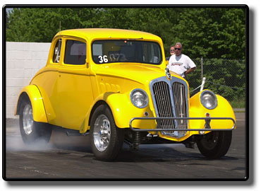

    TRUE STORY:
    I recently let my son race my '33 Willys that I built in 1989. He said after he went through the lights the car wanted to change lanes and he had to drive it to keep it straight. I told him "that is just the nature of the beast, a short wheelbase hot rod. Don't worry about it."
    Months later I took it to a 3-day race out of state and drove it myself. Sure enough as I drove past the finish line and lifted off the gas the car veered into the next lane. Subsequent inspection revealed the bushings had been hammered out of the rear suspension similar to the photos above. I parked the car for the rest of the weekend.
    After trailering it home I tried to unload it. The car wouldn't move. The bushings in the rear coil-over shocks had also failed and subsequently the car fell down and the rear tire was resting on the tubbed wheel well.
    Can you imagine what would have happened if the rear suspension had collapsed as I was drivng through the lights on its last p***? Or even worse... if it had happened when my son was racing it previously?? I could have never forgiven myself. I called my son and appologised profusely for not taking his warning seriously.
    BOYS AND GIRLS: SUSPENSION BUSHINGS ARE NOT A LIFETIME ITEM. THEY ARE CONSUMABLE ITEMS, LIKE TIRES AND SHOCKS. INSPECT AND REPLACE THEM AS NEEDED, EVEN ON LOW MILEAGE APPLICATIONS THAT HAVE BEEN INSTALLED FOR YEARS.
