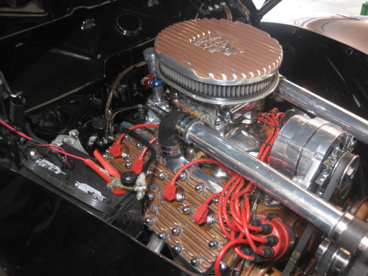

    Holley 4 barrel with 1 inch spacer and mechanical advance distributor works for me.
    Engine is 239 cu in.
    OFFY intake has that 7/8 offset which must be dealt with. Use an intake with centered gen. mount to save yourself from problems. IMG_9115big.jpg

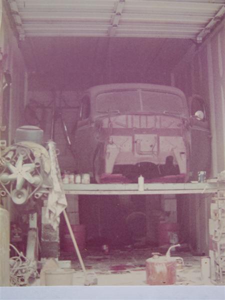

    Garpo, Do you live in a cooler climate?
    Just asking as I'm wondering if that small fan
    will adequately cool your engine,when sitting in traffic and when "on the road".
    I had one like that on my stock 8BA in FL and it would not cool sufficiently.
    You can see it in the 1973 photo.

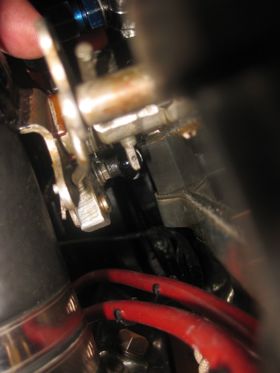

    Does anyone have pictures of their linkage set ups on a Holley 390? My gas pedal comes out on the p***enger side but the holleys hook up is on the driverside

    No pictures, but about 25 years ago I had a 390 Holley on a 276" merc in my '36 3-window. I ran a Lokar throttle cable that looped around the front of the carb and pulled the the throttle lever. It worked OK, but looked kinda weird. Lately, I have been running 2G's on Merc manifolds, which also have the throttle lever on the wrong side and pull the wrong way. I have solved this problem by mounting the carburetor back wards, and the throttle linkage just falls into place. I don't remember enough about the 390 Holley installation, but it seems to me that you should try mounting the carburetor backwards and see how things line up.

    Looks good but I'm trying to avoid going to a cable. Is there any reason you can't run a carburetor backwards?

    Works fine with a 2G; why not try it with the Holley? I admit, I thought there was some reason that it wouldn't work, but when you think about it, the carb sits level and I think the bolt pattern will work, so take a look.

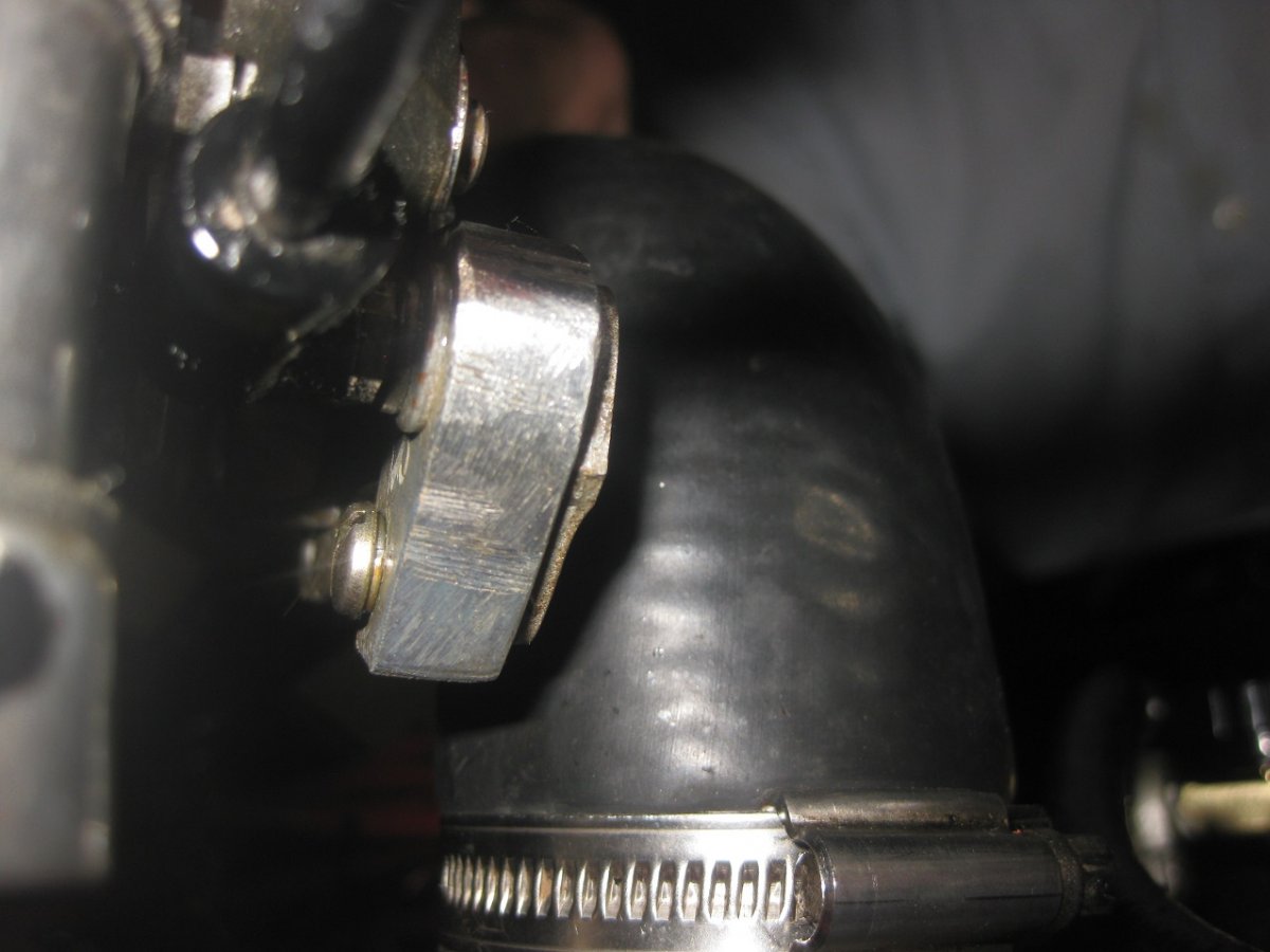

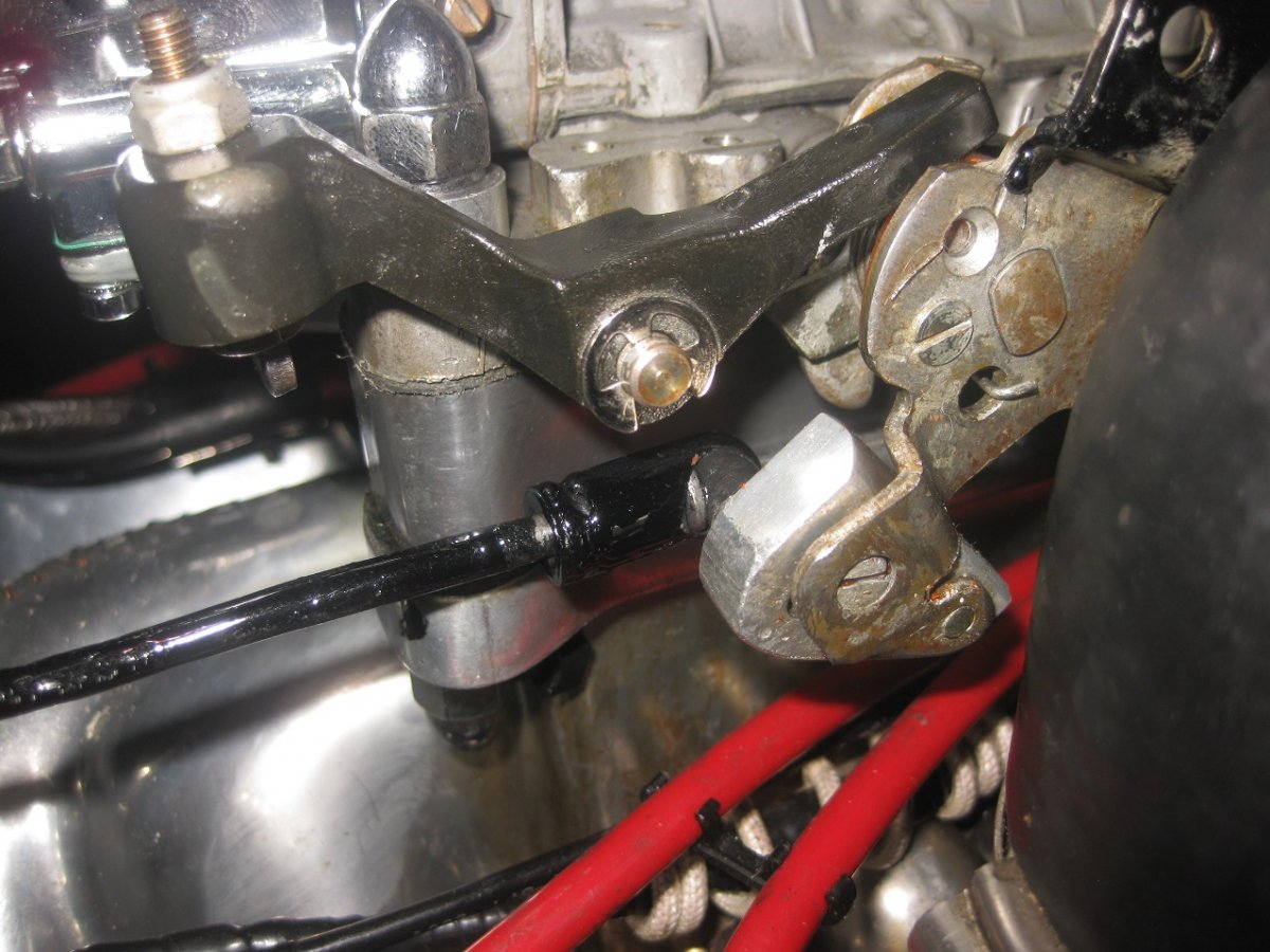

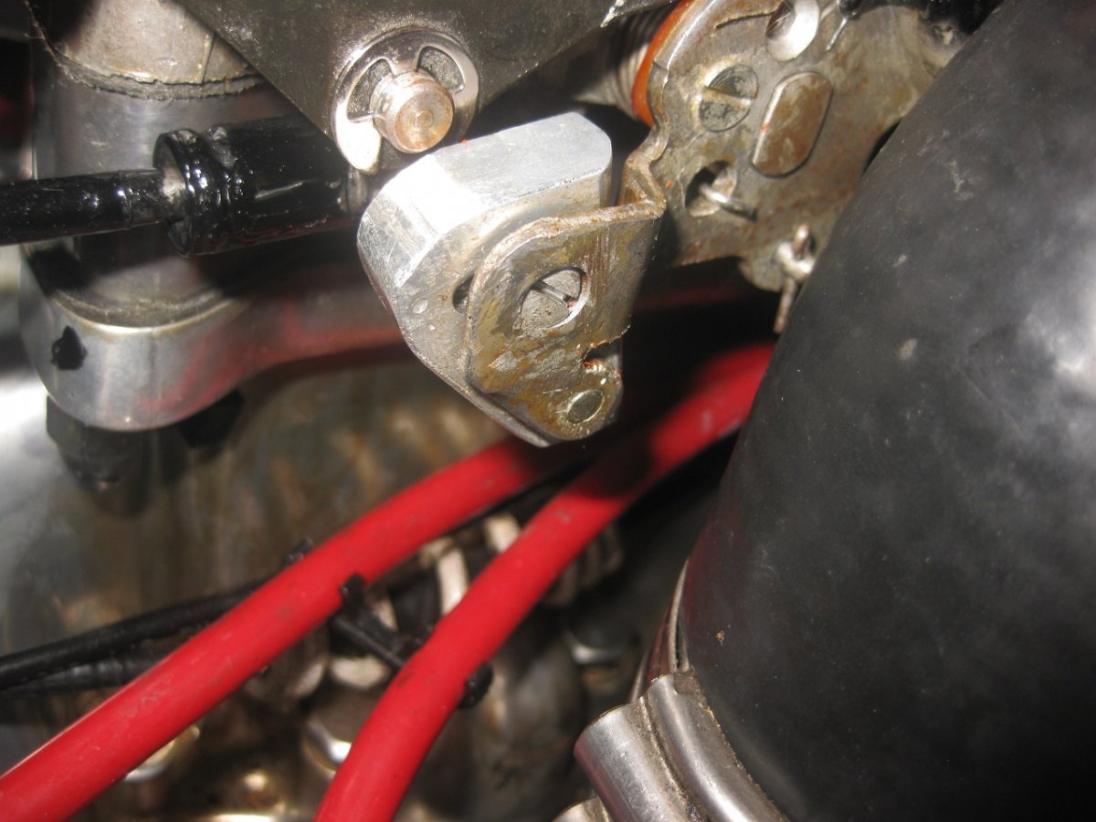

  27. 19Fordy
    Joined: May 17, 2003
    Posts: 8,420
    19Fordy
    Turn the 390 around so the linkage hook up is on the p*** side. That's what I did on my 40 Ford. Make a little turnbuckle to adjust the "throw" of the accelerator linkage. I also made a little aluminum hookup"block" on the 390 carb linkage. No return spring is needed.

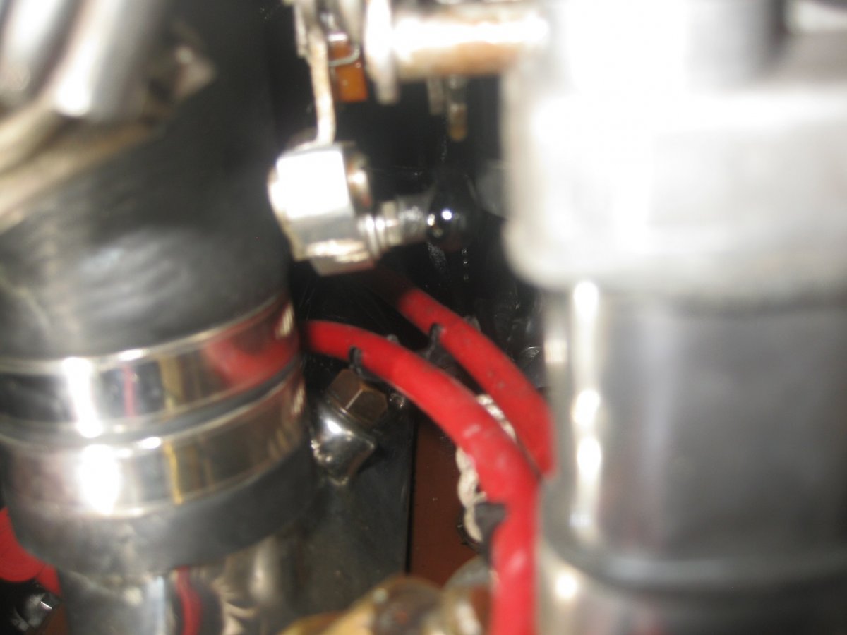

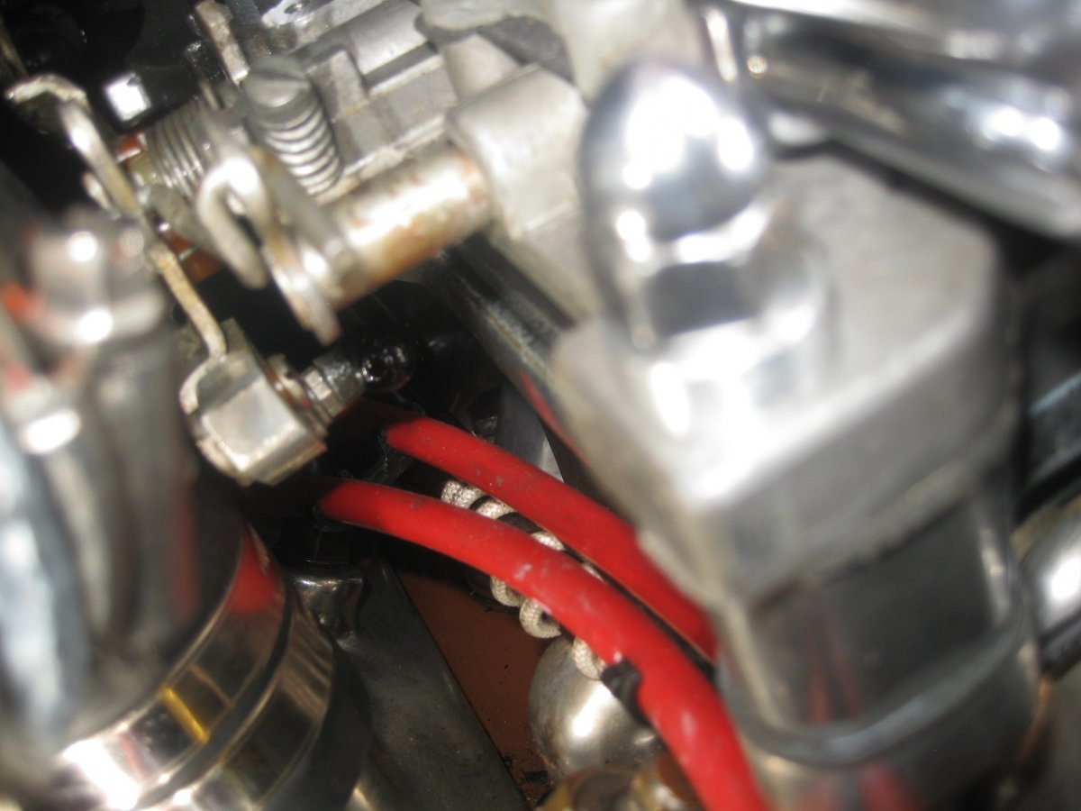

    A little Late to the Party But here is my 390 setup: I was searching Jet Sizes that work.
    I took mine apart. It had 62 in there and it’s too rich so I ordered 50 to 56 to try.
    IMG_4042.jpeg IMG_4043.jpeg IMG_4044.jpeg IMG_4045.jpeg IMG_4047.jpeg IMG_4048.jpeg IMG_4049.jpeg
