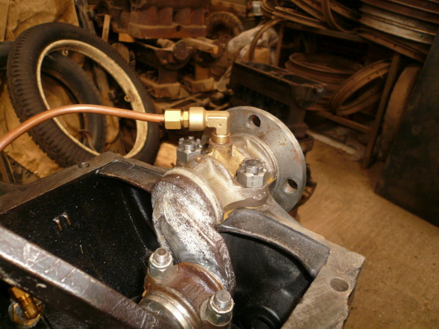

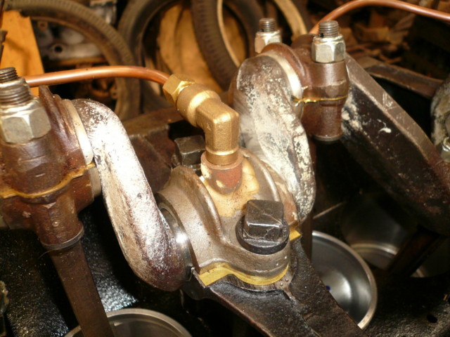

    here are the T photos as promised

    Simon- Two things less than cool about the T pressure plumbing- Copper lines crack from vibration, especially with lengths over an inch or so, unsupported. Mains should have the pressure fed in at the top, this being the side away from the load. A groove cut around the babbitt or better, a groove in the block behind an insert bearing shell to the top of the bearing will do the job. Lots of engines have been run with the oil fed in at the bottom of the mains, but if going to the trouble to pressure oil why not do the best you can?
