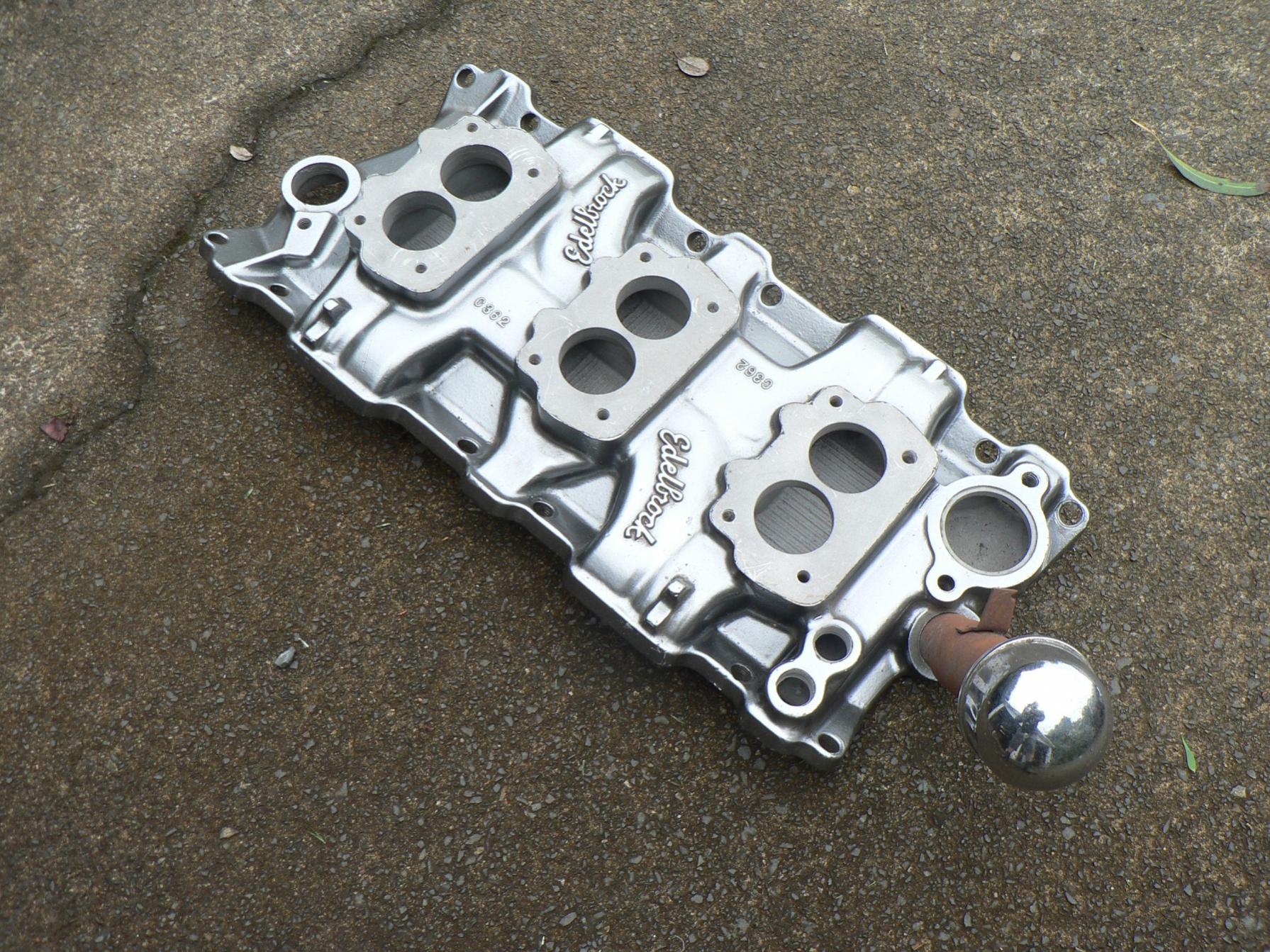

    getting some good advice here. Any one know the difference in the 355 and 357 intake?

  11. Smaller ports on the '55 heads. Maybe '56 too?

    Sorry, the 355 or 357 refer to the numbers on the Elderbrock intakes not the cubes of the motor.

    Does that refer too 3-bolt vs 4-bolt carbs?
  14. Look at the ports on the intake. Are they smaller on the C355?

    According to the catalog:
    C355 fits 1955 and 1956 Chevrolet 265 and 283 engines. These were released two ways:
    Cat # 1860 4-bolt flange
    Cat # 1870 3-bolt flange
    C357B fits 1956 Corvette 283 and 1957 Chevrolet 283. Again, these were released two ways:
    Cat 1925 4-bolt flange
    Cat 1930 3-bolt flange
    Installation kits were available for either Stromberg (3-bolt) or Rochester (4-bolt). The standard installation kit was for simultaneous operation. Two other kits, called combination kits, were available that would allow for progressive installation.

    As Carbking stated, the 355 is only for 1955 and 1956 SBC. It has very small ports and may not work on later engines. I had to swap my 355 for a 357.

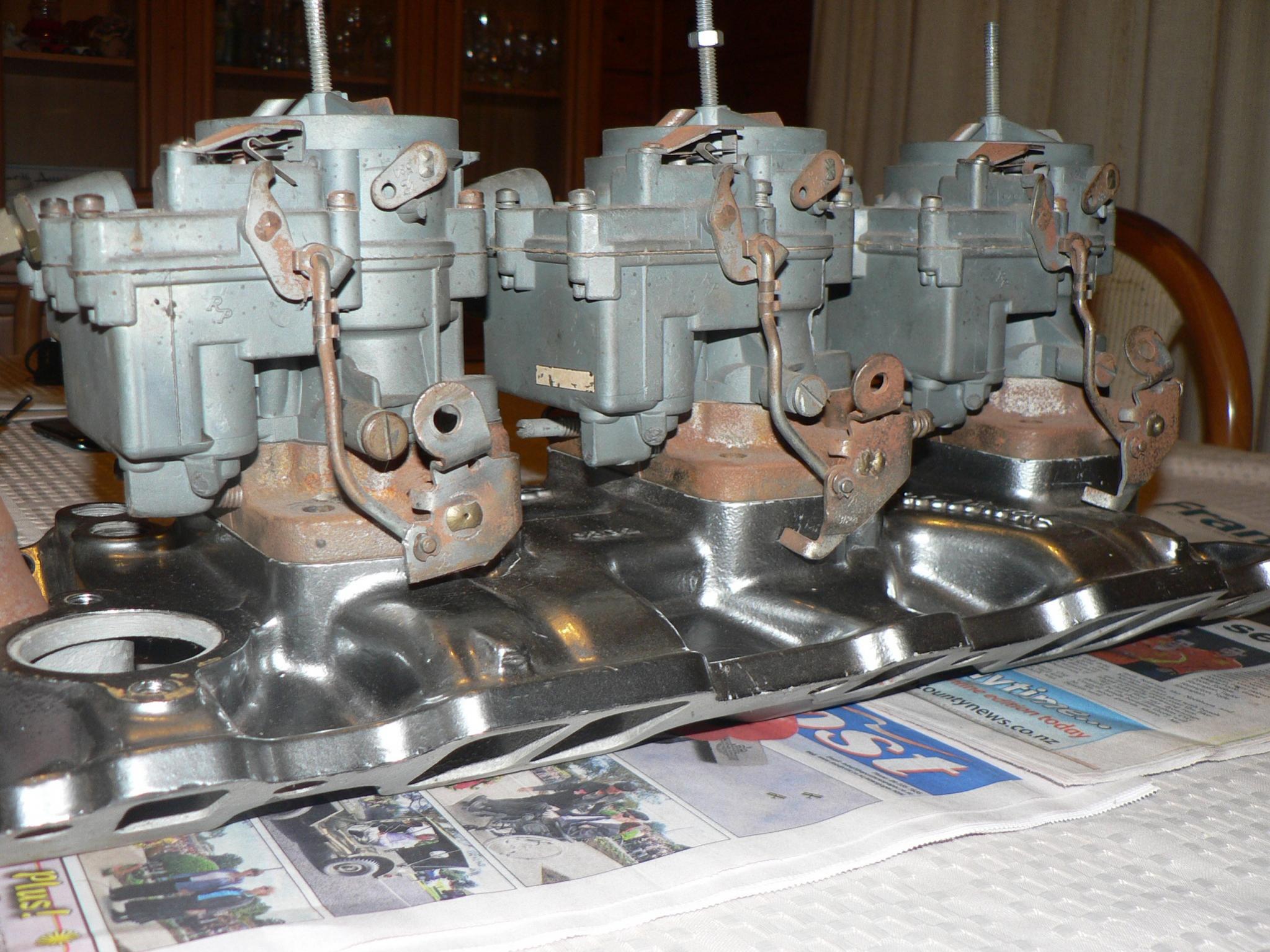

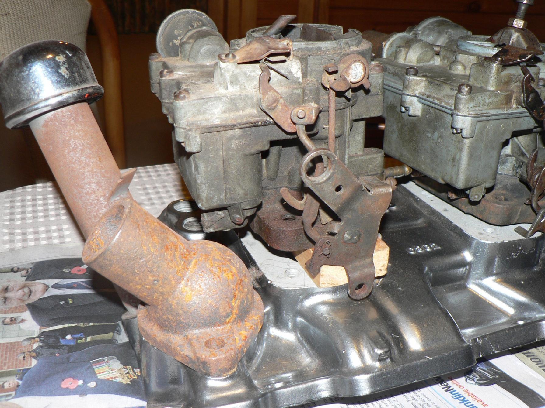

    Sorry to hijack this thread but as there is a lot of information coming out about the manifolds I thought some one could help me with a couple of problems i have. I've got an Edelbrock C362 manifold. This is for the big base Rochesters, the carbs seem to sit a lot lower than a lot of other manifolds I have seen. When the carbs are in place you can't fit the water neck on as it hits the bowl.Was there a special waterneck for these?
    The question is, If the large Rochesters flow around the 350 cfm would running all three be too much for a SB Chev. Can anybody help me with this.

    Do you have a pic of the carbs and manifold? There must be a water neck that fits. Worst case, you could run spacers, I think.

    Here are a couple of pics, what's interesting is that from what I have read is that these manifolds were designed to go on the Vette's and the pads were lower to keep the carbs under the hood. I can't see why they would then put a spacer on as this would stuff up the height. This is why I am curious about the waterneck. Also curiuos about the size of the carbs on a SB. Interested to hear what others think.

    Response to post 25. Turn your carbs around.
