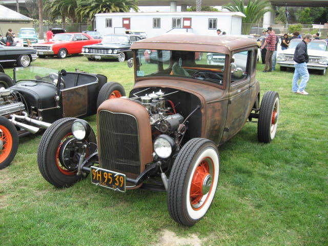

    As dangerous as ***umptions are, I ***ume the "A" in your avatar is the car you are discussing and also ***ume you will be running with no hood. The 3X2 set up will really stand out and be worth the effort to install and tune it. Re: difference in performance: The 4 barrel will probably perform better, but you will still be able to get all the speeding and "unsafe start" tickets you feel you need with the 3X2. Find the thread started by "Dreddybear" on Holly 94 & mulitiple carb setups. Absolutely priceless info and will save you tons of grief, even if you are not running Holleys. I am running a 6X2 setup on a nailhead powered 29 coupster (no hood). I get thumbs up constantly. I even got a thumbs up and big grin yesterday from a motorcycle radar cop. Go for it.

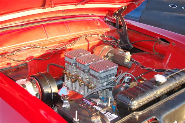

    Interesting. Yes, that manifold has low carb mount decks compared to others I have seen. I'd be really curious to know what they originally ran for a water outlet. Not knowing that, the only think I can think of if you want to run that manifold is carb spacers.

    Now that I look at the pics again, it does seem like the outlet have on there sticks up higher than most. Have you tried some different outlets as well?

    That's an early manifold I believe. Those 2 projections on the fuel inlet side are there to take the hexagon fuel logs of the early tri-power era.
    No longer on the modern day repro intake.
    My old Fenton had those mounts.
    Just an opinion but I believe that someone milled those carb pads along the way. Why? I haven't a clue.
    I don't believe the Corvette story because Corvettes came with high rise 4 bbls from the factory with out a problem. Ford FEs had that problem but I've never heard of the problem on a Chevrolet.
    These are spacers that will lift each carb and eliminate the problem. It was thought to be a HP improvement but who cares?:D Google them.
    Any way I don't think your intake came this way and there is no common answer to your problem.

    I am running all three carbs. I use 2" spacers to give them a little height and use free flow air cleaners for performance and looks.
    They have been on my car for about 5-6 years now with no problems at all. Use progressive linkage and keep the fuel pressure to about 6-7 lbs. and you will be golden.
