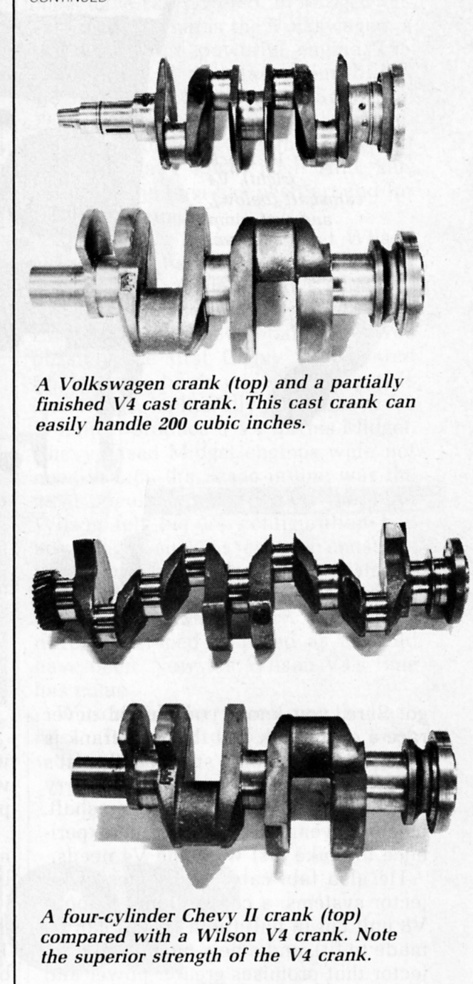

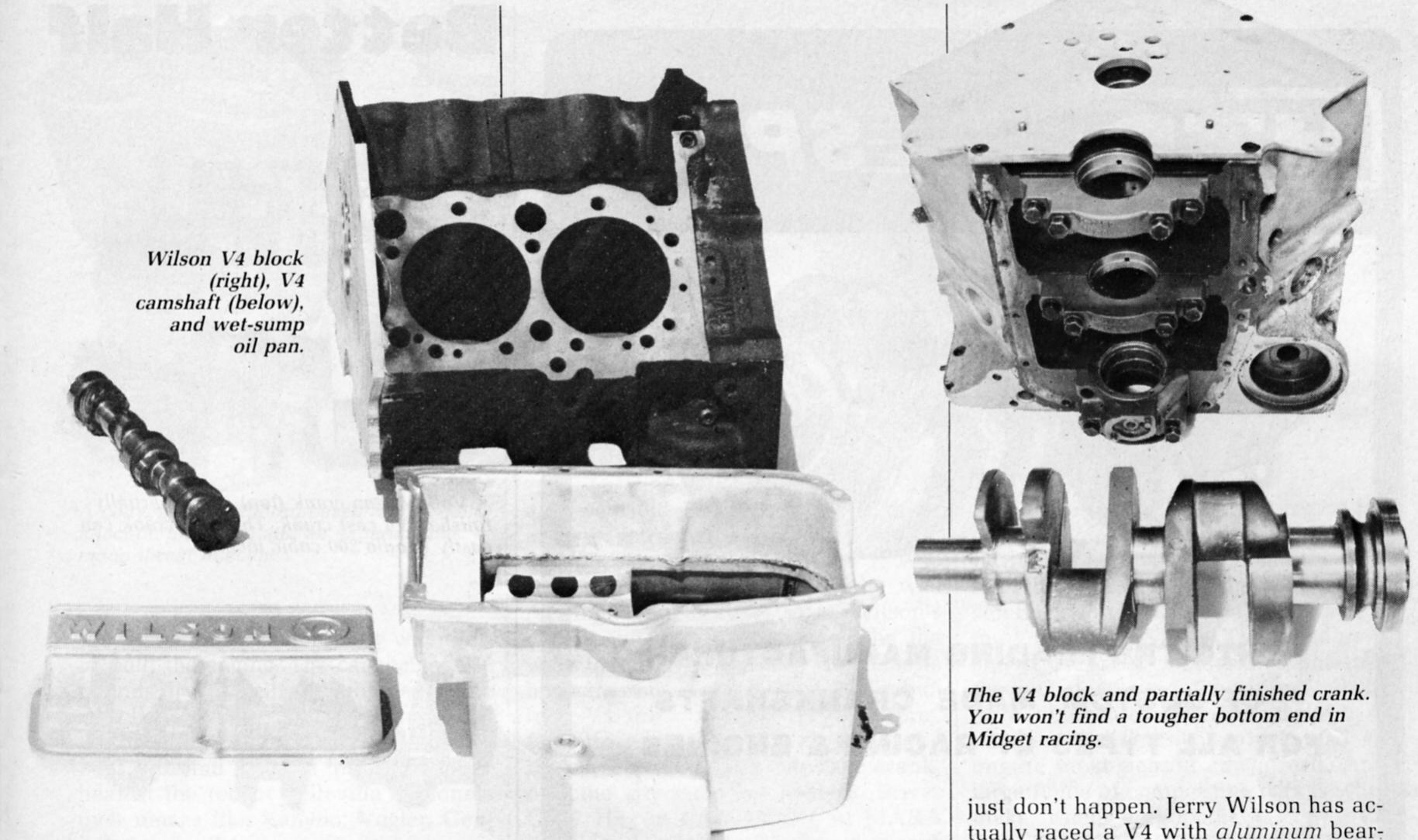

    If this is for LSR racing, where weight isn't a issue, you would probably be time and money ahead just pulling pistons out of a v-8. In oval track racing weight is everything which is why they cut the engines down. Here's some of what it takes to make a v-4:
