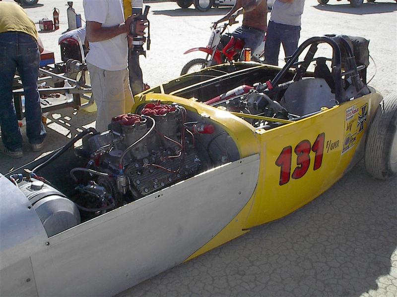

    That's not the Russ Eyres motor or the Bean Bandits car. That's the Hot Rod Works street roadster. Same idea but different setup. The Bean Bandits car is a yellow modified roadster and the Eyres motor has a 76mm turbo with efi. Both setups are very cool.

    the bean bandits car has the cylinders removed, that picture posted is pretty old back when the car only went 146, it now holds a record of 218 at bonneville and 196 at el mirage

    Here is the Bean Bandits modified roadster from a few years ago. It's turbochagred now.
