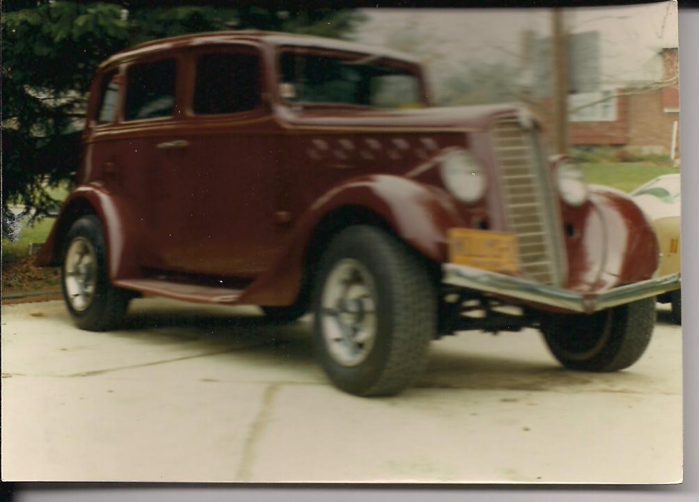

    Those GM 4 cyl. are great motors whether it be the Mercruiser, Iron Duke or Chevy Nova 153 like I ran in my Willys. In fact we are putting another Iron Duke in a 39 Willys PU and I have a Super Duty Pontiac 4 cyl I'm looking for a body to put it in.

  30. The Scout engine is worth considering and certainly the crossflow head makes constructing manifolds much easier. In my case I wanted an inexpensive(that aspect never does work out) engine which is narrow, short so it can be snugged in behind my I beam axle and which bolts to a chevy bellhousing already in my car .
    So it was a little mercruiser.
