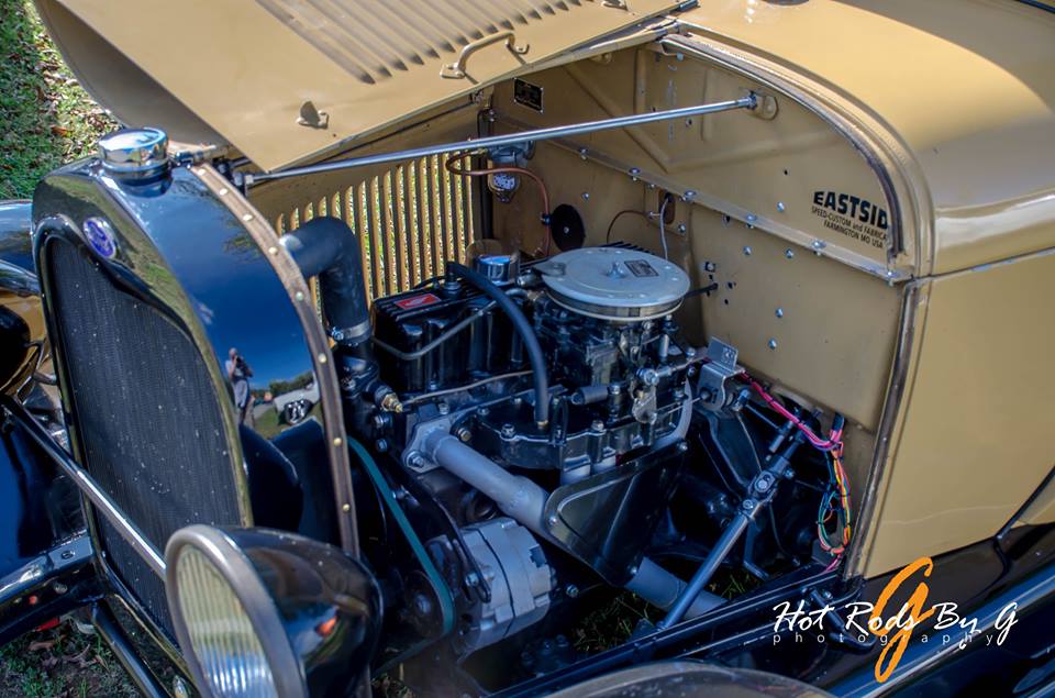

    A little hot rod ingenuity can make that intake work on the 181 head.

  5. 1929CDAN
    Joined: Mar 18, 2006
    Posts: 349
    1929CDAN
    Stock boat intake cut down till it looked like a car manifold. But I made a new top for it and turned the carb so I had room to hook up cables .

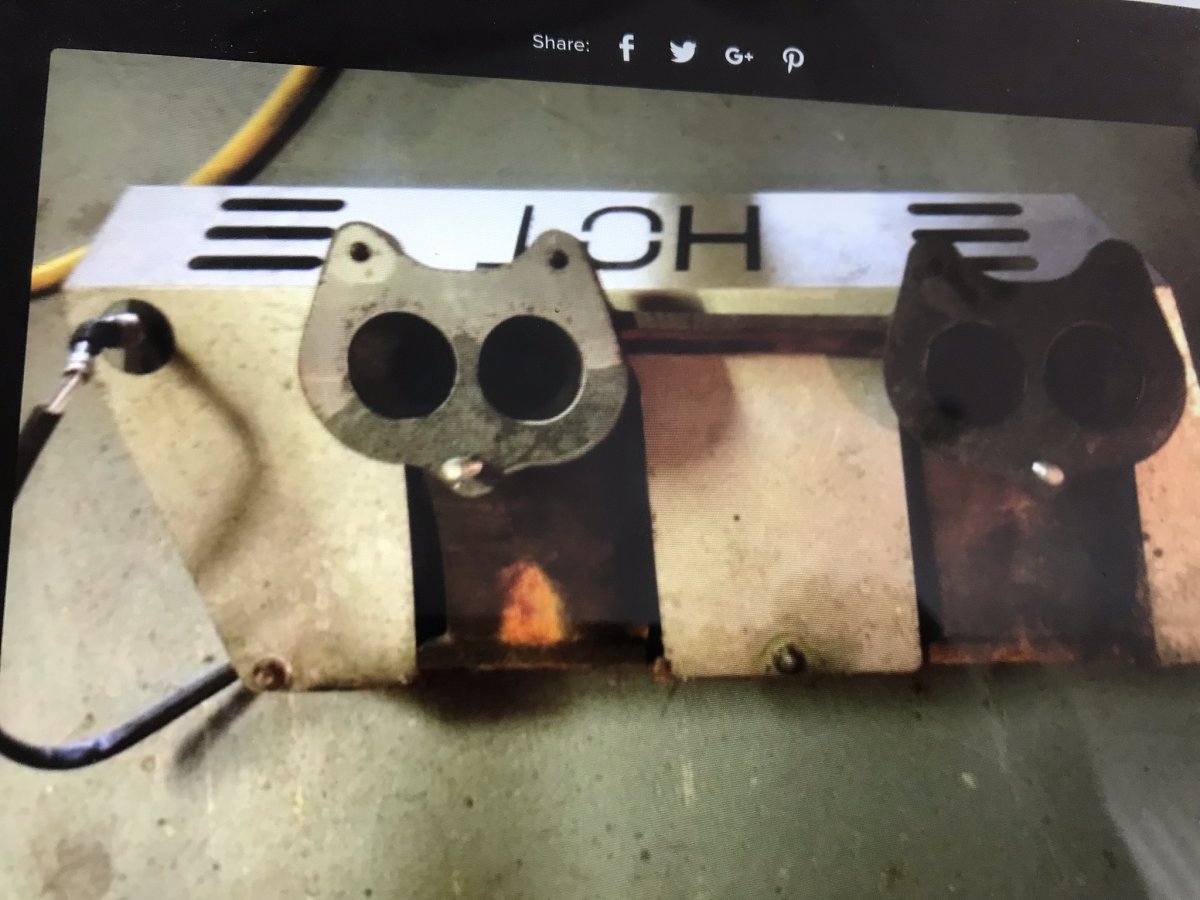

  6. Six Ball
    Joined: Oct 8, 2007
    Posts: 6,978
    Six Ball
    from Nevada
    The mounting holes appear to be in the same place. It would be a simple matter of modifying the ports. Even I could do that.
  7. Six Ball
    Joined: Oct 8, 2007
    Posts: 6,978
    Six Ball

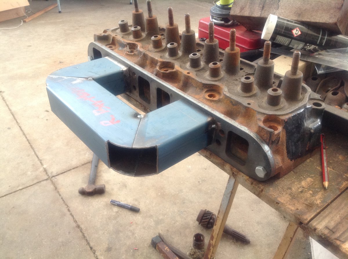

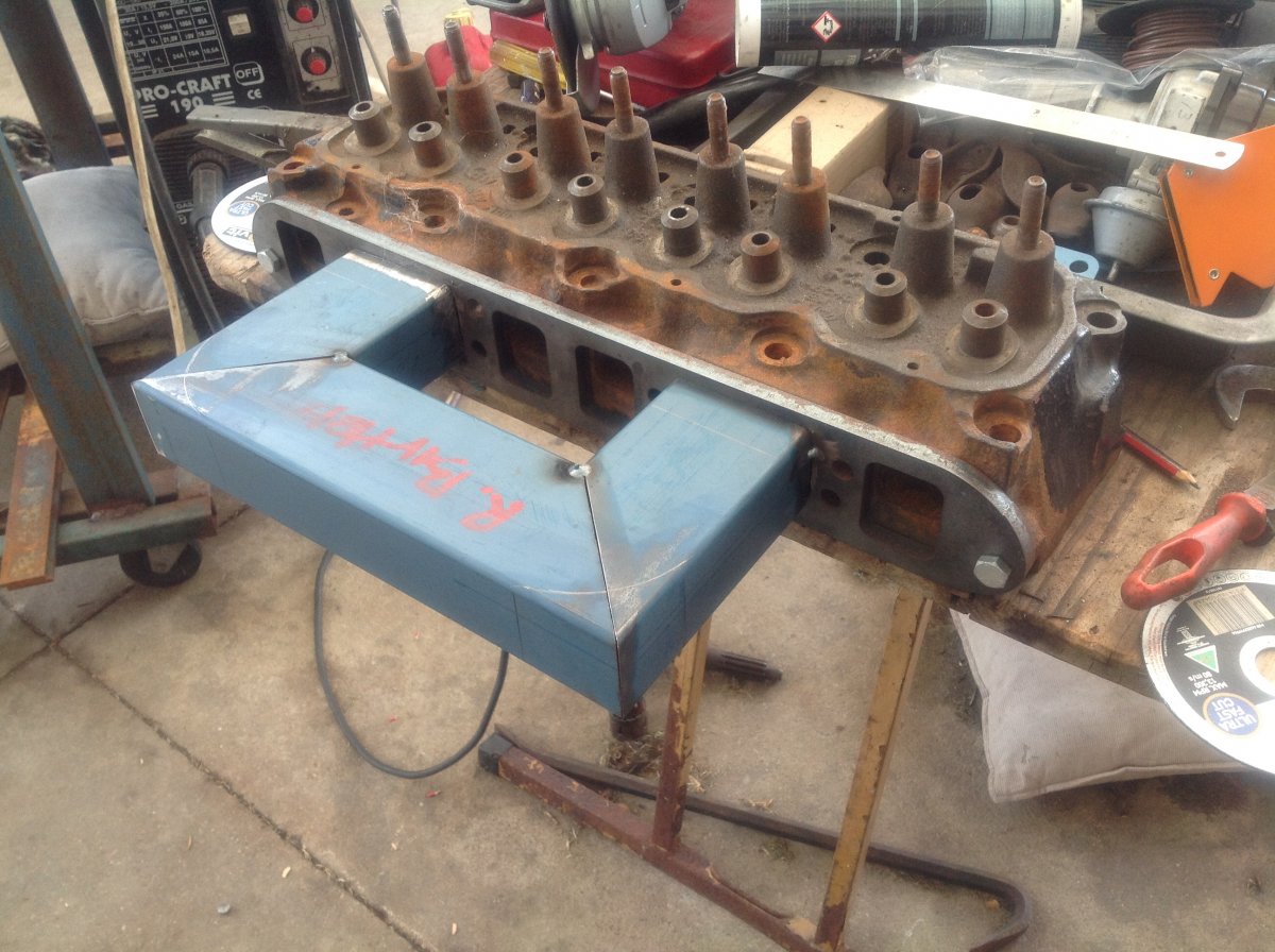

    This is my answer to the 8 port head / manifold problem ,,as I'm in Australia we don't have any of these engines except for boats ,,mine is an ex boat engine ,,the head was rusted out ,Charlie Stephens was very kind enough to sell me a nice bare head and drop it to my shipper ,,I'll have to take my chances with the block it looks ok ,I had some header plates cut at my local laser cutter to the relevant port configuration gasket ,,this is the start of my intake manifold ,,rectangle tube and a grinder ,,I will form some in fills and get it tig welded ,,carb unknown at this stage so will make a suitable plate later ,,

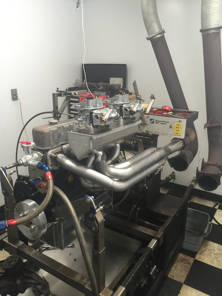

    Here is the intake we had made for our 181 it works real well. chev 4 eng dyno 055.JPG

  10. RoddyB34
    Joined: Oct 13, 2009
    Posts: 542
    RoddyB34
    That's pretty fancy ,,got a few more ponies than mine,,

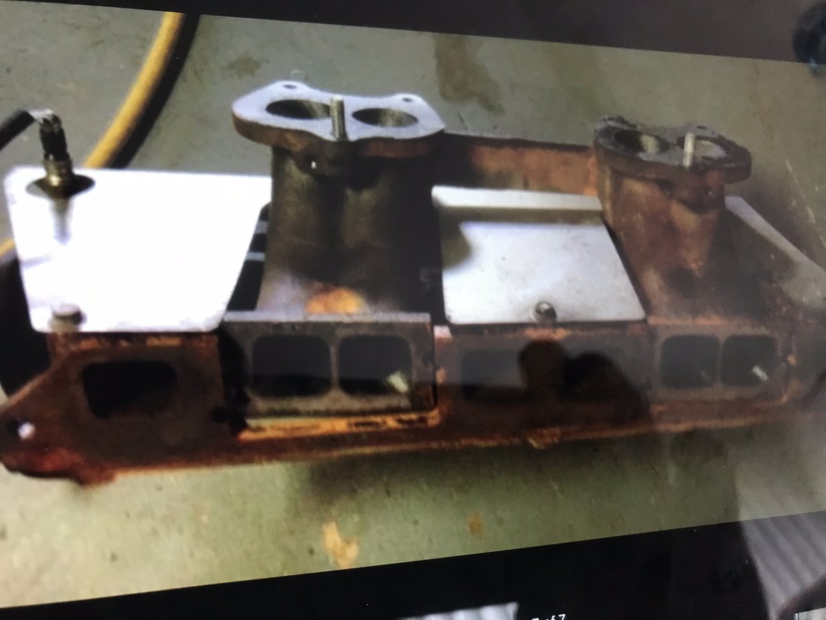

    Impco sells a pricey 181 manifold and adapter to Rochester 2 bbl or 4 bbl or check with someone like Helmarparts.com who sell complete engines for $ of intake and exhaust manifolds. Intake will still be gaseous only so will need carb adapter. 2nd pic is to throttle body but close enough for demonstration here.[​IMG] [​IMG]

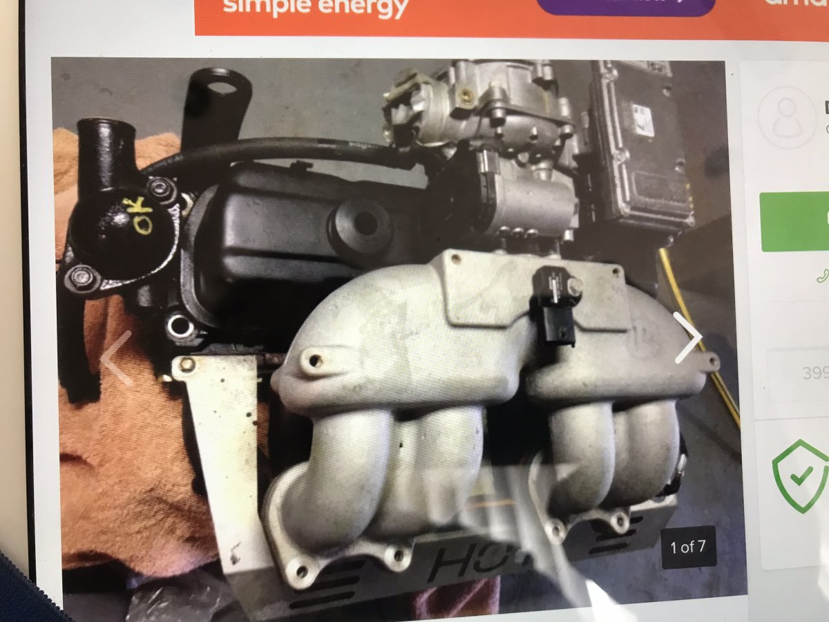

    This forklift LPG manifold turned up on our local Gumtree sales ,,would have been good to run 2 carbs on the 1st runners ,,but I’d already completed my manifold,,
  30. oldiron 440
    Joined: Dec 12, 2018
    Posts: 4,077
    oldiron 440
    I don't know what it makes for power but it's got the look!
