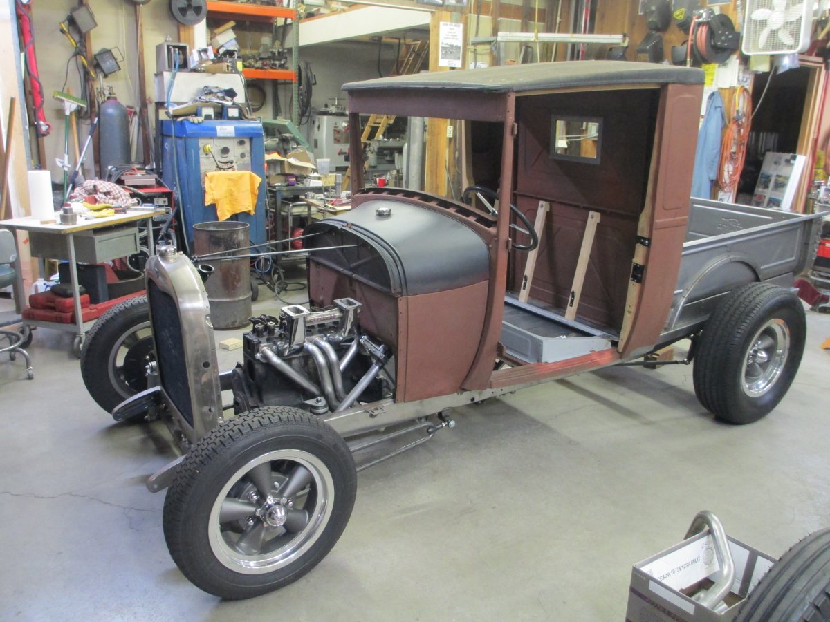

  4. Attached is my version of Jersey's mount in my AVATAR. I bolted a piece of angle iron to the frame and welded the brackets from there. I used the stock GM mounts on both sides of the engine. IMG_5528.jpeg

  5. jersey greaser
    Joined: Feb 21, 2009
    Posts: 216
    jersey greaser
    those big soft mounts are surely helping keep the 4 banger vibe's to almost nothing . nice work There,
    real world it's so simple a motor to stick in A bone , as it simply fits like a factory glove, flywheel back is all stock v8 chevy making matters even easier ,
    Six Ball likes this.

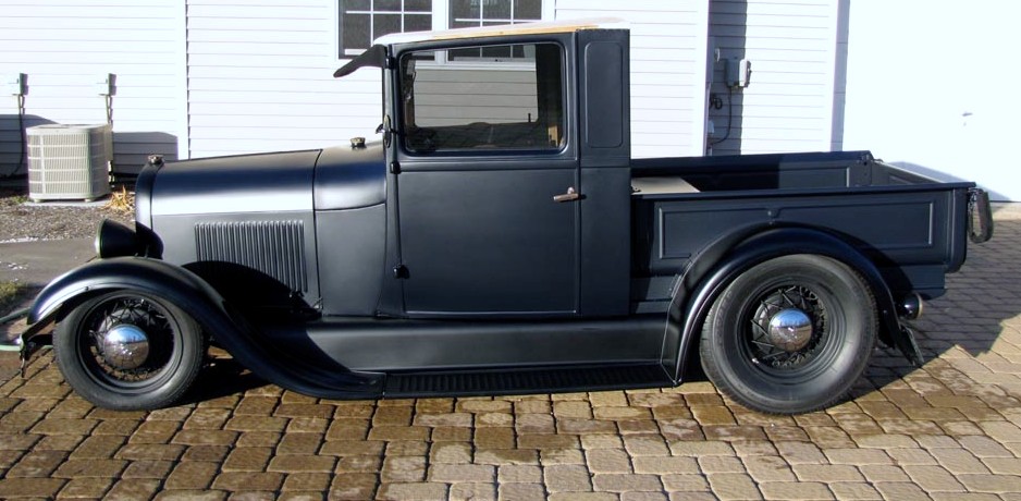

  7. jersey greaser
    Posts: 216
    jersey greaser
    nice but you also need to find the alloy finned lifter cover to help compleat the matched looked.
    yes mercruiser cast a finned side cover for both motors the 4 and 230/250 inline 6's
