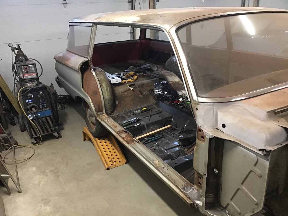

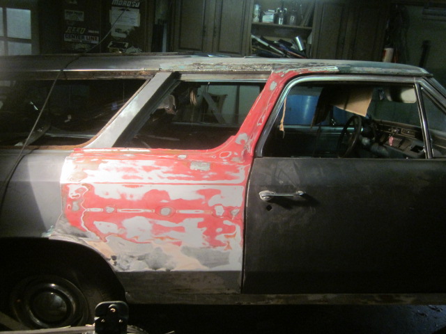

    Many of the early Sedan Deliveries were a coach kit company build on a 4dr car platform that used the shorter 4dr doors. I found this out years ago on my 37 Chevy Sedan Delivery build. Our Family loved that car but we all agree that the 10" shorter doors really needed to be longer. Later year 2dr Wagons did use longer doors making it much easier to get in and out of. For the 2dr Wagon conversion I have been working on, I got myself parts from a 2dr donor car. After removing the doors and B-pillar, I hung the new longer front doors. I also welded in the new B-pillars. The quarter pieces were from the donor and I added part of the inner structure from the old rear doors. In my application I am using ideas from the Tri-five Nomads like sliding quarter windows and 2 piece rear hatch design. This required further design flow modifications along the upper window area of the car to allow use of factory trim and hopefully giving the wagon a one of a kind factory build appearance. Several of my personal builds over the years have included modification and creative ideas that appeal to me. Since the 70's I have done things like modifying my first 37 Coupe into a rumble seat, built a 37 Chevy KingCab Pickup, added suicide doors and other mods to my Chopped 37 Sedan, built a Custom 56 ElCamino as well as a later model Camaro Wagon. In all cases I spent a lot of time researching similar builds, making a toy model of my designs and searching for the parts needed for the conversions. Help from friends is also a big plus. The hardest part for me has usually been that first "no turning back" cut. Best of luck and have fun if you decide to do a build.

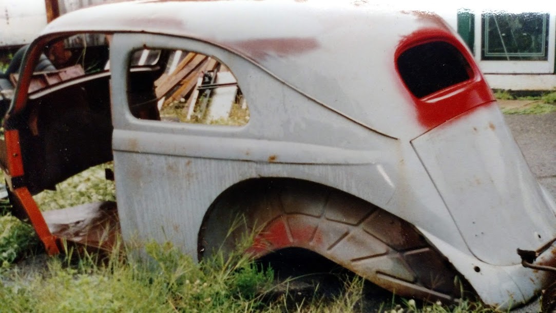

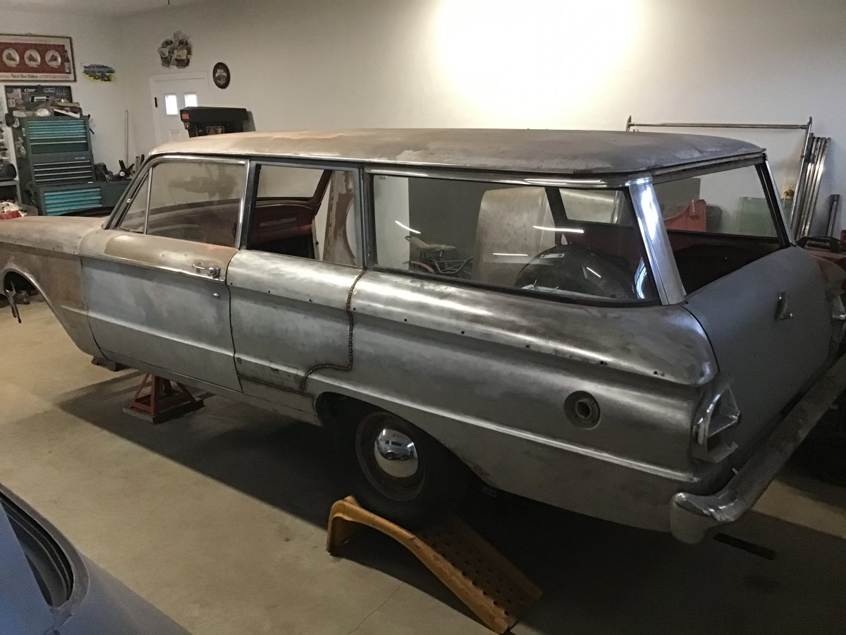

  15. Yes they did...but not too many. They were made in the production years of 1938 & 1939...I have not seen an accurate production number, but they do exist. To get in the back seat the p***enger side seat folded forward. True factory 2-doors had window trim on the inside back seat windows. Welded shut rear doors did not have a removable window trim. Here is a factory body shell for a 2-door sedan. g-willys IMG_20190117_110311548 (3).jpg

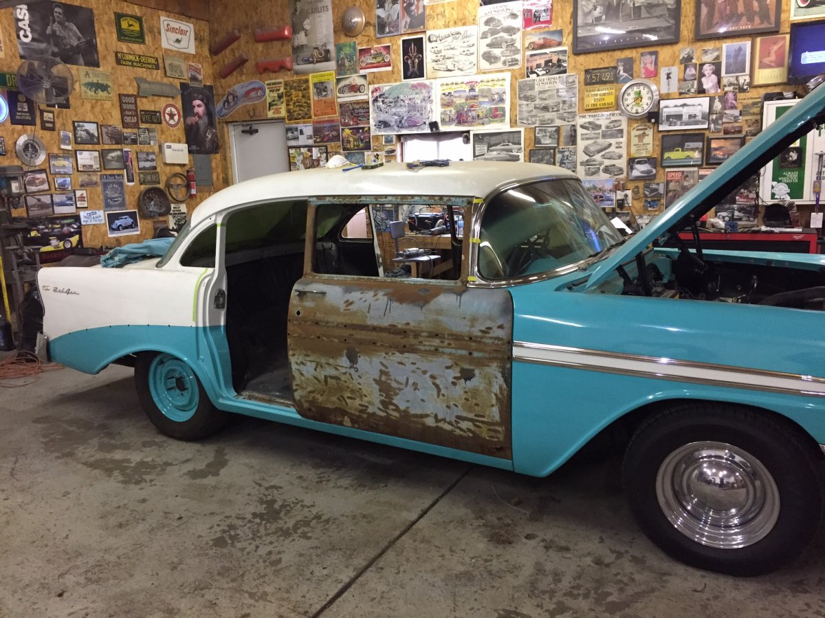

  17. Here’s my quad cab to coupe conversion, luckily i found a 56 belair body shell for all the parts. You would have a hard time finding any signs of the conversion.
    C6385B5A-151A-44C9-B2FD-AFA0A7731F4F.jpeg 5708505B-E431-4300-9C07-7D49CBD727C0.jpeg
  18. ^^^that was posted just to show a good example of how to do a nice conversion.

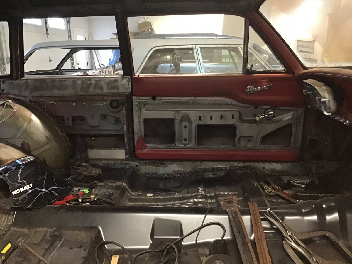

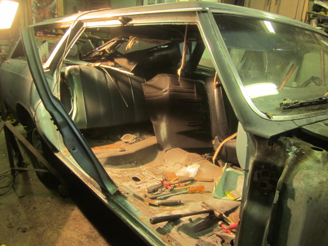

    C9D4ACB8-E7B2-4663-A034-38FFD2FA008C.jpeg 9CD78BFE-D4C9-47CB-B9D0-20543A8DB406.jpeg B617CE13-D4B7-4493-BCE4-387BEC0E47CB.jpeg 0339684A-BB18-4D1B-9A64-BE1034547967.jpeg 9FF488A2-2940-44DC-9ADA-737EC6374319.jpeg Finding 2 door metal definitely makes for a better and easier job. When I’m done it will look like it left the factory as a 2 door

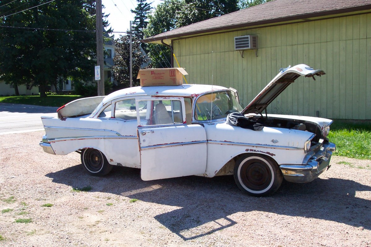

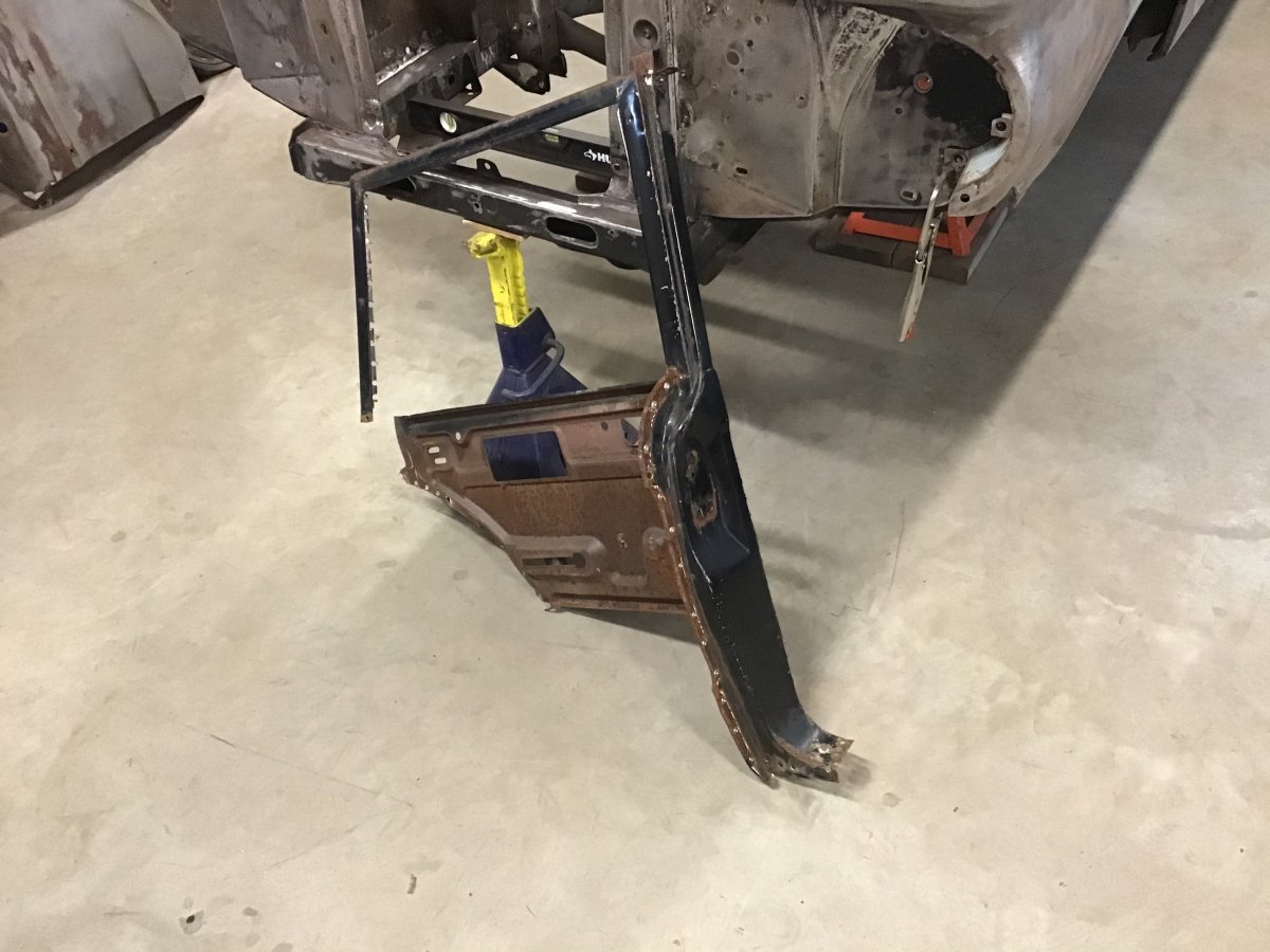

    Here's the '57 I'm working on, which illustrates some points really well. First pic is the day I bought it. You can see that the previous owner (a high school kid in the late 70's) shaved the rear door handles, filled in the rear doors (no welding, the door gaps were filled up with Bondo), and a set of 2 door quarter panel inserts were installed to try to disguise it. But it still looks like **** with the wrong proportions and the extra pillar. I think this is worse than just having 4 functional doors.
    15 years and a lot of lost white paint later, here it is midway through the 2 door conversion, using the longer doors and B pillars from a donor. Same way Scotty T's car was done above, only my donor sections were so rotten that they would not reach all the way to the rockers, a big section needed to be filled in, and for that I used some old door skins.

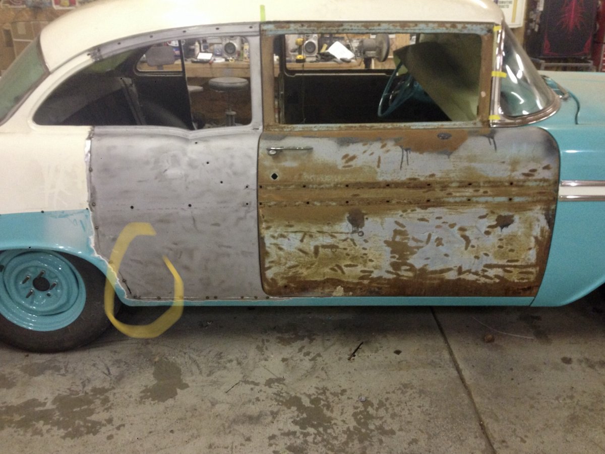

    Here is one with the door skin filler panel tacked into place.
    And here is how it sits today. I don't have the time to paint the whole car yet and it looked very odd with brown doors so I painted the doors to match the rest of the car, for now. I touched up the seams in the quarters once it was fully welded and that's good enough for the time being. The conversion really isn't that hard to do if you have the right pieces, some welding skills, and patience.
