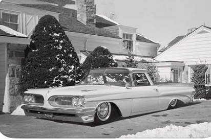

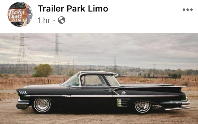

    Cut the back doors off and shorten the whole shabang....we all know how that will turn out

    Hey, I don’t know whether you posted that Pic as an example of good execution or a bad execution, but I’d rock that!
    31hotrodguy likes this.
  3. Good.
    It needs tweaking but I would drive it

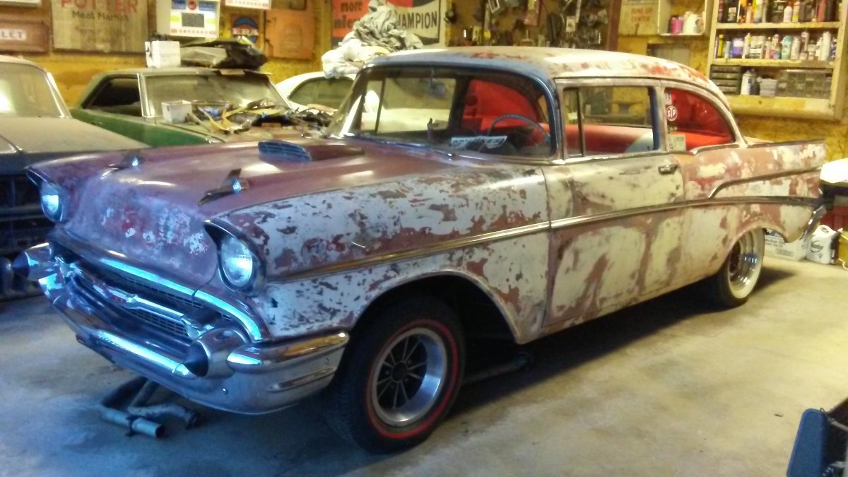

  10. I could be wrong but I think he was saying he wanted to do a wagon LIKE his only get another one that was is a little worse shape.

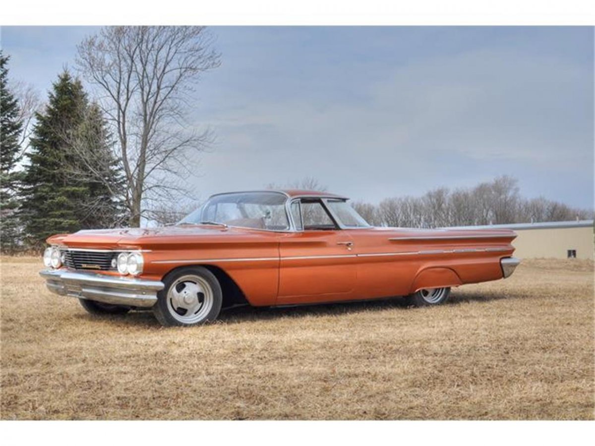

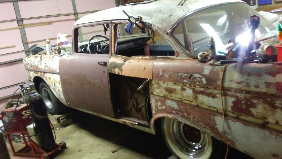

    A 60 OldsAmino would also be a nice project. You would still want to consider longer 2dr doors to get the proportions right. I designed and built my 56 ElCamino using a 2dr 210 Wagon as my donor. https://www.jalopyjournal.com/forum/threads/some-pics-of-my-friends-1956-elcamino.399170/
    In your case a 57 ElCamino roof would be the right width and give your Olds a great design flow.

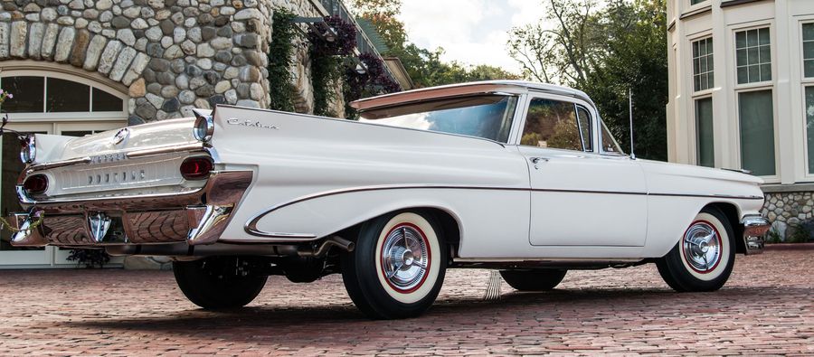

    In 1960 Pontiac actually built the ElCatalina concept but it never went into production. Note the similarity to the Chevy ElCamino and how nice the longer 2dr doors go with the flow of the design. The second picture appears to be a conversion using a 4dr wagon and not replacing the doors. You can see that the shorter wagon doors simply look out of place.
