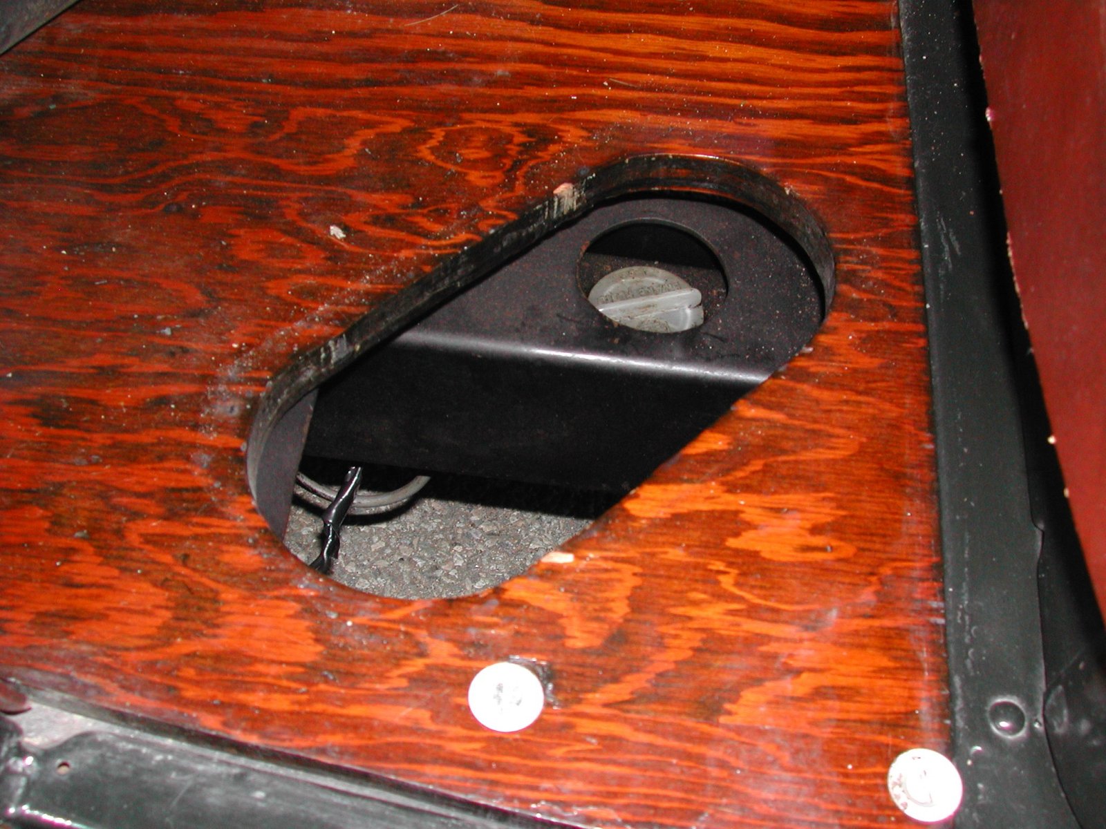

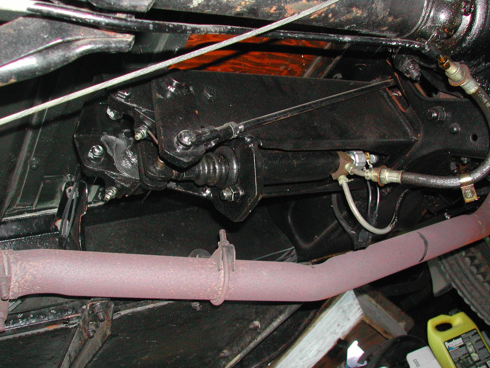

  7. A little off of the topic of your post but save this for another time. Here is the way I set up the hydraulic master cylinder on my AVATAR:
    Card1 032.jpg Card1 029.jpeg Charlie Stephens
