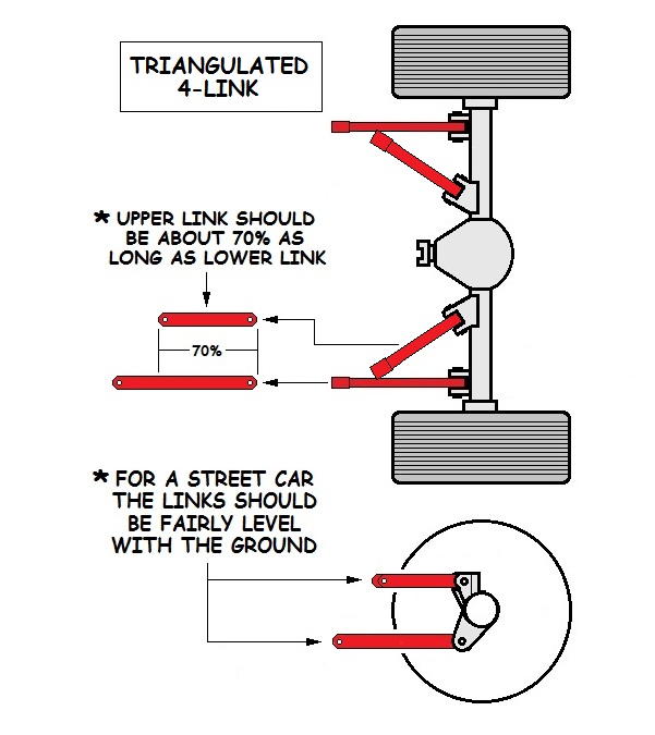

    Unfortunately, If I keep the manufacturer recommended lenght of the lower bars, I cannot do that because when the car is lowered the bar will bind at the X. I do plan on reinforcing that area by welding a support bar between the frame and the X to avoid any twisting and bending of the X.

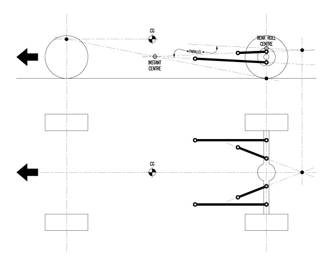

    The X frame can be gusseted where it attaches to the frame [this would be a strong point]
    Presently ALL forward thrust loads are transferred to the frame from the Triangulated links near the centre.[ The wheels will try to Toe-in and bend the axle tube]
    If you raised the triangulated links above the axle tubes, the thrust loads would be shared equally with the outer links [these will need to be the same distance as the outer lowers are below the axle tubes]
    Pinion torque reaction will lessen the compression loads on the upper links , and increase the compression loads on the lower links.
    By spreading the loads over 4 links [over the length of the tubes] will lessen any tendency of the axle tubes to bend
    Picture this: a plank sitting on 2 blocks, If you stand in the centre the weight is equal on each block. But if you stand directly over 1 block, there is almost no weight on the other.
    Thrust loads from the Axle centreline are similar, It is dependent on how far the brackets for the links are from the axle centreline as to proportion the compression loads.

    Thank you. It all makes perfect sense. I was thinking of moving the top triangulated bar mounts to the top of the axle tubes in order be leveled. I will proceed with doing so.

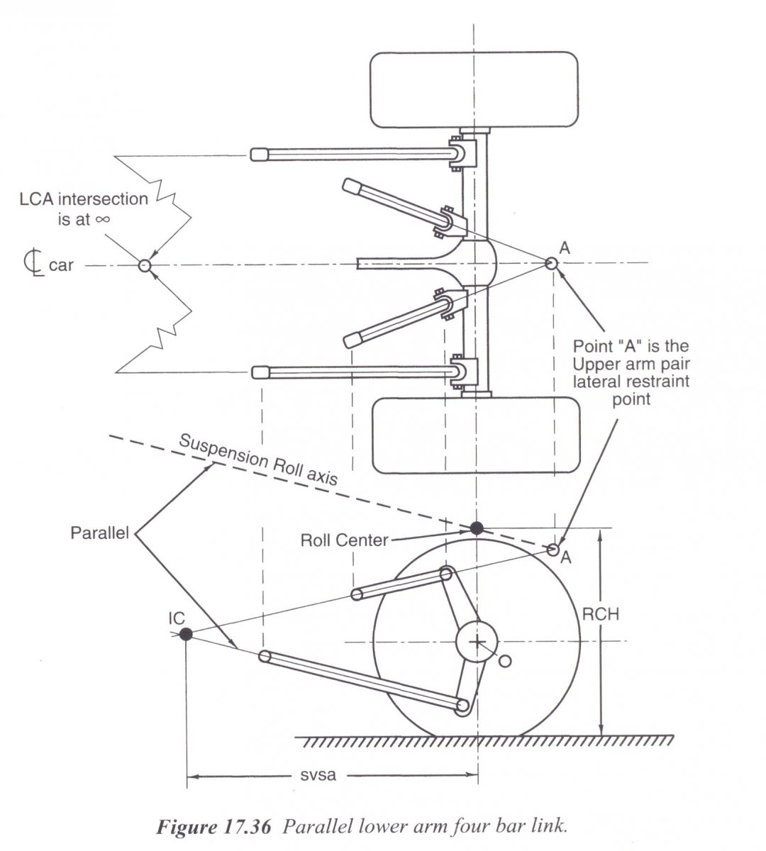

    Where do you apply the 30° to the upper bars? Is it the angle from the frame rail to the rear end or the angle from the rear end to the frame rail?
