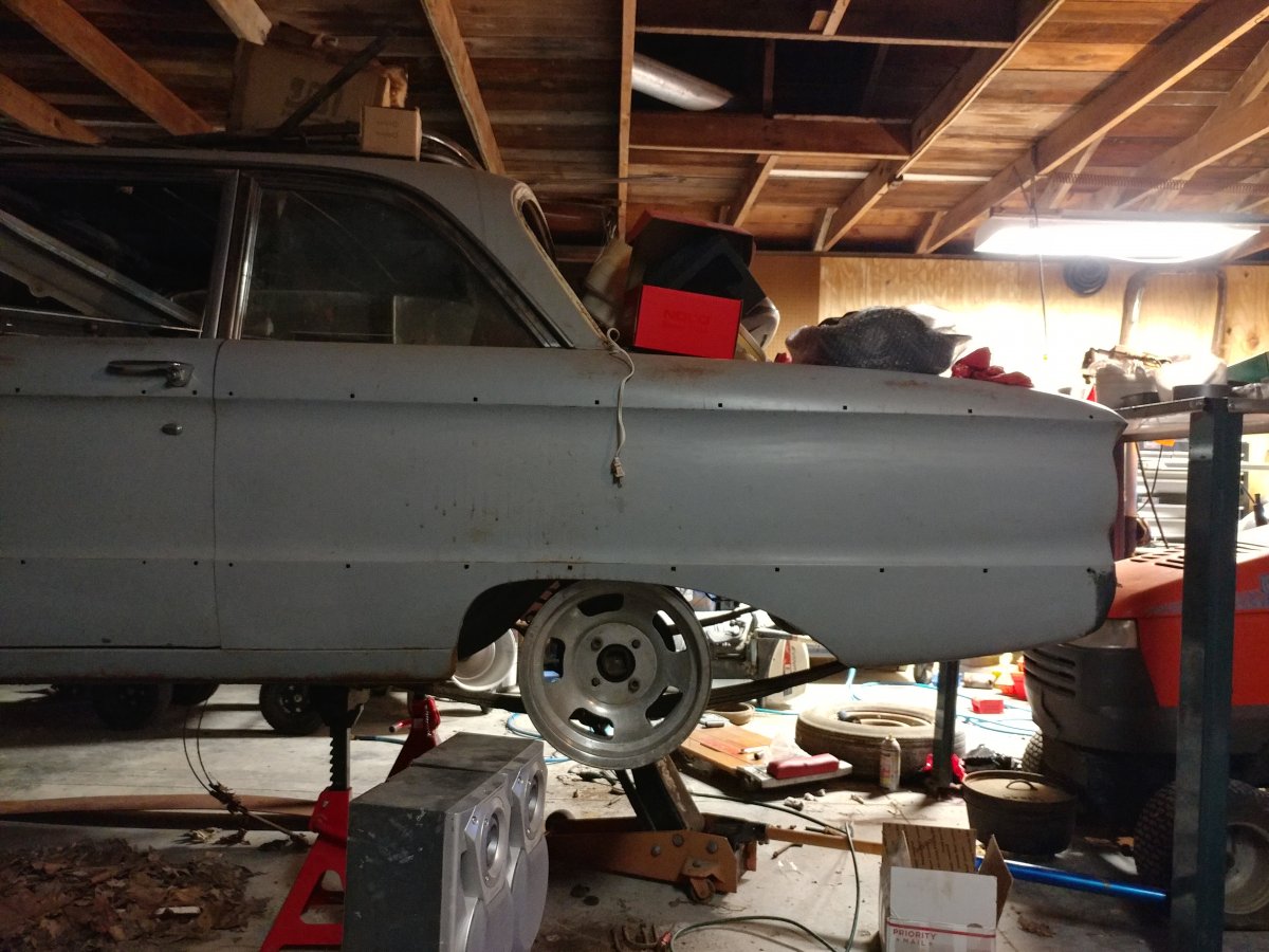

    IMG_2889.JPG IMG_2890.JPG Where can we get nice hot rod style wheels for the 4x4.5 bolt pattern? My Ranchero is original and I don't want to change drivetrain yet?
    I found these wheels. Has anyone seen these 14x7 Cragar Wheels? I want to put them on my Ranchero! They are 4x100 and rated at 965lbs. They have safety beads and are for golf carts! Why can't they make these for cars!

  4. Well, if they're rated at 965 lbs each, that's more than adequate for a Falcon Ranchero. Even loaded, you'll have a tough time getting over 3000 lbs total weight. Or are they specifically noted as not for automotive use? Might be worth a call to Cragar...

    IMG_2865.JPG I looked at the load rating on Torq Thrusts and they are 1400 lbs and weigh 17 lbs each. I think with the lightweight of the Ranchero it may be okay. I ordered one to see.

    If you like those Cragar wheels I would call them and ask about auto use. The static load factor may not be the problem, they may not be able to take the side loading of a Ranchero in a 70 MPH curve
