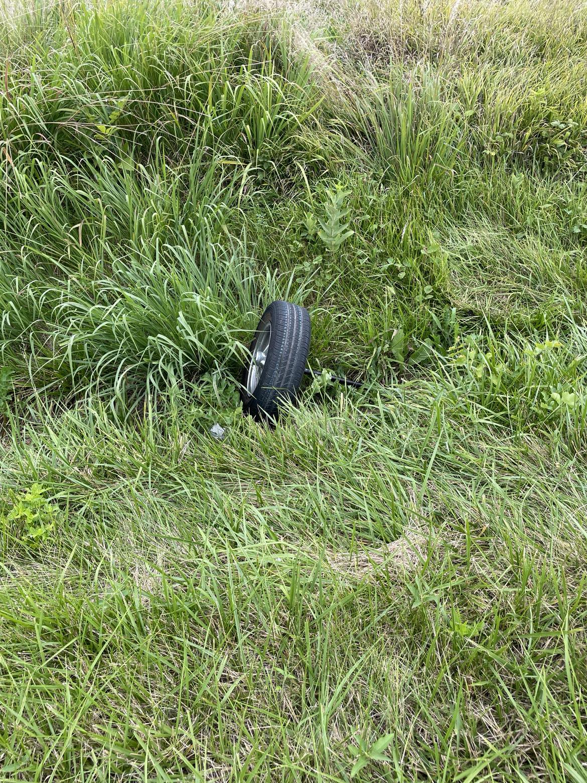

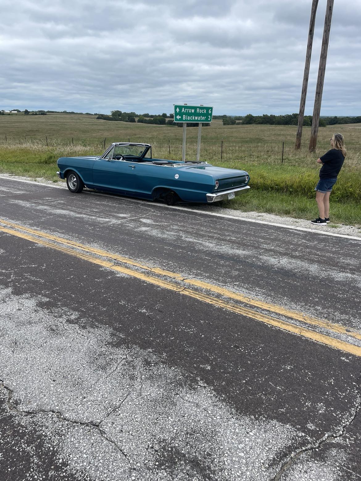

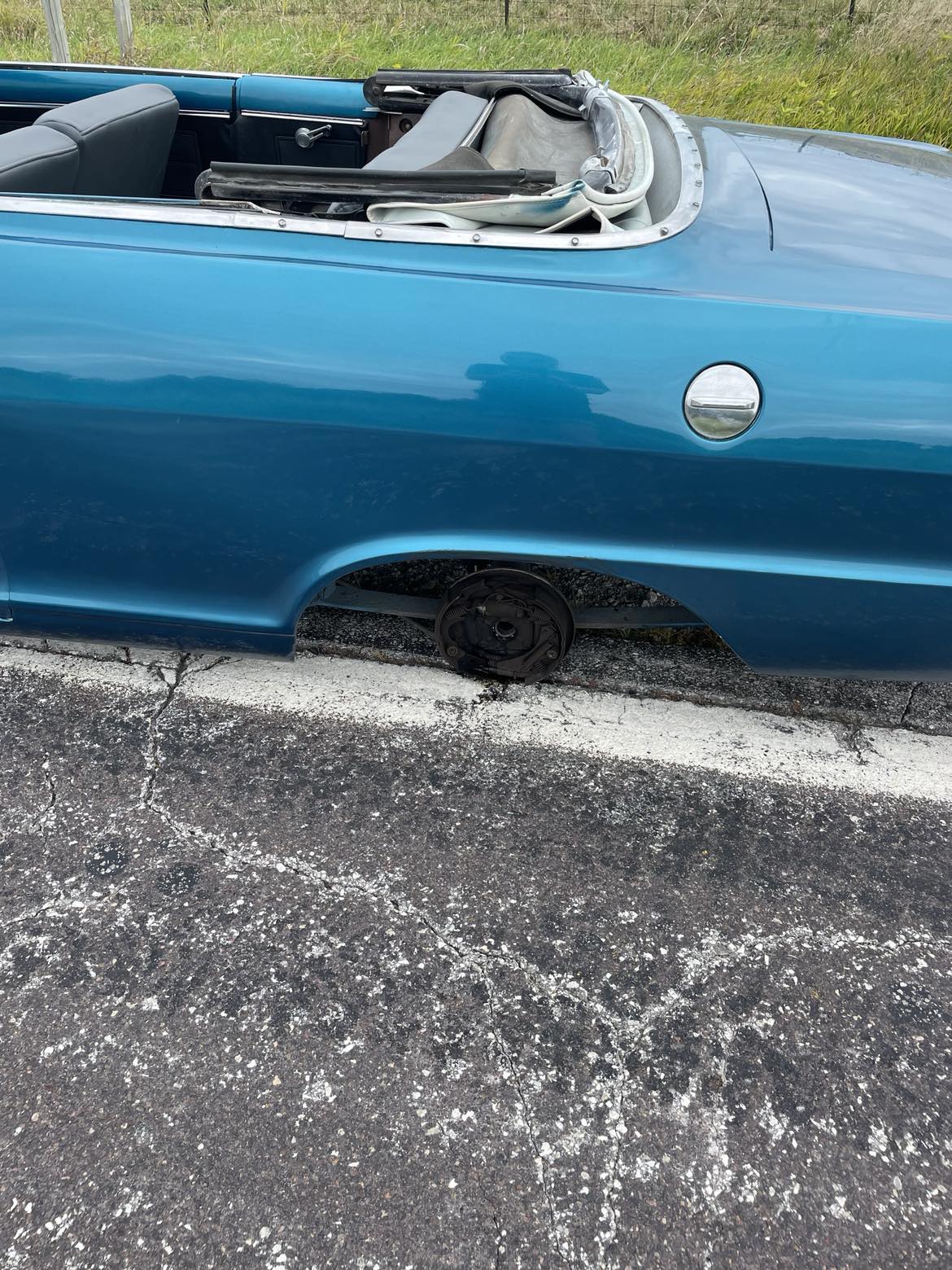

  22. fastcar1953
    Joined: Oct 23, 2009
    Posts: 4,110
    fastcar1953
    The rears have a bad setup. Wheel bearing goes bad axle comes out of car.
    Nice afternoon for a cruise. Lucky nothing hurt to bad.
    Going 5 lug sooner than I wanted. I have the rear end.
    I guess I will do discs and dual master cyl.
    Lost my brakes when it went. 453772506_1854822008328626_3559393494984487161_n.jpg 453782409_1696739644477252_5990176217369131789_n.jpg 453786031_806821954982420_6476626514269972551_n.jpg
  23. Johnny Gee
    Joined: Dec 3, 2009
    Posts: 14,227
    Johnny Gee
    from Downey, Ca
    How in the world did you not mess up the 1/4 panel!?

  25. fastcar1953
    Posts: 4,110
    fastcar1953
    Luck was on my side. No idea how it came out and cleared everything.
    Tire sits up in wheel well. It's like the car bounced up and it slid out all the way.
    I never saw it coming.
    I've drove a lot of old junk several miles over the years , never had this happen.
    We went to town and coming back home. driving about 55mph 452805378_8321727201184826_4267981673910742101_n.jpg
