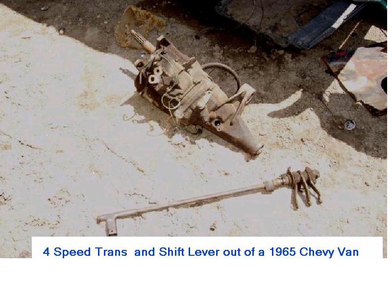

    hotrod primer is correct chevy vans around 66-69 had a factory 4 speed colume shift and it worked great

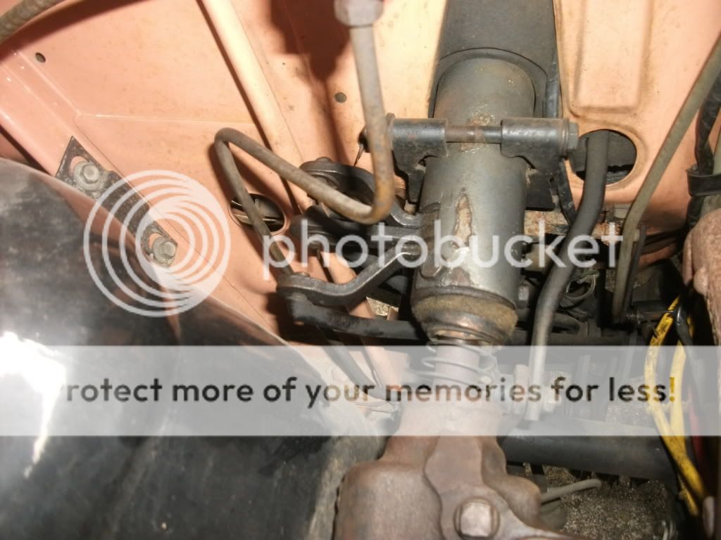

    Here's one I've been running the past 20 years in my RHD '55 Bel Air 4 door. Shifts OK but needs to be kept in adjustment. Find an extra offset lever, thin the section where the shifter tube engages on all three, cut the column out a bit to let them fit. On the shifter tube, grind a bit off the piece where the gear lever engages to allow it to extend a little further into the upper housing, giving slightly longer travel. Narrow the key at the bottom of the shifter tube that engages into the 3 levers. A Muncie 4 speed can go into reverse while engaged in any forward gear. I welded a small plate to the shifter tube half way up that engages a spring loaded ball when in the position for reverse gear, just gives a little resistance to let me know where to stop for first/second (middle lever in my setup). I still hook 2 gears at once sometimes. Car is basically restored Coral/Shadow Grey 4 door, wide whites, looks like a nana's car. Runs a 350 that until recently was dressed to look like a '59 Vette 283, front mounts and generator etc. Just swapped the carbs out for an old single Quadrajet. Catches a few people out.:)

    You're on your own with linkages. I don't know if it would be easier or not on a LHD car, the crazy cross shaft setup we got on RHD cars may allow for more options. A mate of mine converted his '55 to 4 speed colomn shift as well, but he went with cables.

  10. KCTA Chris

    Wow.
    That sees like a great way to do it.
    Thanks for the great pictures, they help a lot.
    The cross shaft is crazy.

    The cross shafts are OE for RHD Chevys, I just made a bracket to take an extra one. I did this 30 odd years ago, when I was younger, more energetic, and not so wise. I wish I had an auto in it now.:D

    This appears to be a T10 with a Oddball tailhousing rear mount [Sag's don't have the reverse lever in the tailhousing]
