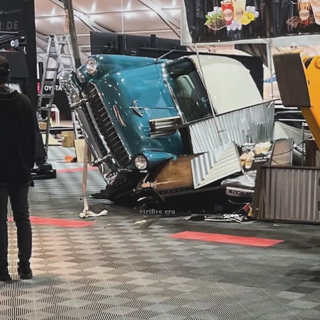

    814D8A3C-ACB9-42A9-8776-0CB5B914724D.jpeg Anyone see the picks on FB where a 55 Chev was laying on its side from a 4 post lift failure? Looks like the post was taken off. One op said it was at Me***.

  3. silent rick
    Joined: Nov 7, 2002
    Posts: 5,728
    silent rick
    did they mount the posts to the floor?
    Stogy, 49ratfink, SOHC427 and 4 others like this.
  4. Operator error??
    Ben
    Stogy, 49ratfink and guthriesmith like this.
  5. Bentrodder
    Joined: Aug 10, 2010
    Posts: 335
    Bentrodder
    from Cotati
    Looks like one of those parking lifts that are on casters. Wonder if they tried to move it with the car in the air?
  6. abe lugo
    Joined: Nov 8, 2002
    Posts: 3,354
    abe lugo
    ****s it happened, but good it happened before the show, that could have smashed some peeps.
    But like posted above maybe it was being moved with the car on? or some safety not locked in?
    I hope they had some Hagerty Insurance?

    According to the Op on FB it happened at Me*** on Tuesday. Obviously a vendor display. Could of been a real disaster if someone was standing next to it when it fell.
    Kelly Burns, Stogy, 49ratfink and 2 others like this.
  8. 05snopro440
    Joined: Mar 15, 2011
    Posts: 3,179
    05snopro440
    Most 4-posts don't need the posts mounted to the floor to lift a car. If they had it on the racedeck I wonder if the racedeck gave way or one post moved enough to destabilize the whole thing.
    Every one I've seen you have to lower the lift onto the casters to engage them with the floor, so moving it with the car up isn't a thing.
    You can't move them with the car up, they're not designed that way. You may be right on a safety not being locked in.
  9. Budget36
    Joined: Nov 29, 2014
    Posts: 15,439
    Budget36
    I wonder if the locks weren’t in and a hydraulic failure happened.
    Edit: seems that idea was mentioned before!!!
  10. hotrodA
    Joined: Sep 12, 2002
    Posts: 7,484
    hotrodA
    Lots of possibilities. Only they know.
    Did a cable swedged end let go?
    Cable pulley break or come loose?
    Weld break ?
    Looks like one corner (LF?) let go and the whole mess laid over.
    Did somebody run into the right side posts?
    Thankfully no one was killed or injured. Poor 55!

    The floor matt would not be a good surface to roll with vehicle up ,
    casters /wheel sink / dig in .

    Someone pointed out that it was a two layer storage lift; you can see the two platforms under the car. The '55 on the top would be really high with the lift sitting on what looks like rubber tiles, sure looks less than stable or wise to do.

    If you look closely all 4 posts are at the top. Something made the top go sideways and the whole works collapsed. Maybe something ran into it?
    49ratfink and SS327 like this.
  27. Mark T
    Joined: Feb 19, 2007
    Posts: 2,187
    Mark T
    I read somewhere that this lift was on blacktop and the blacktop under it gave way.
