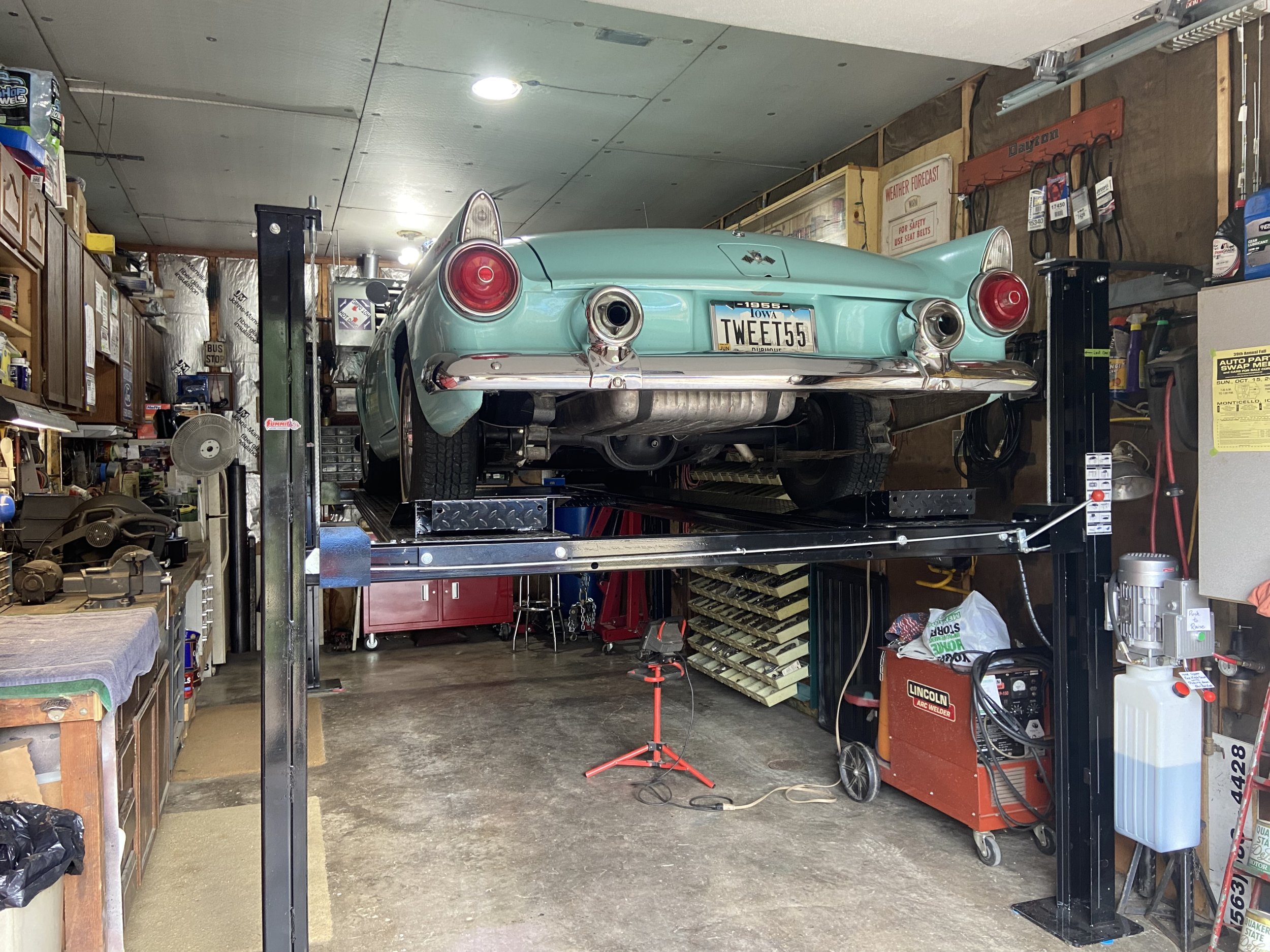

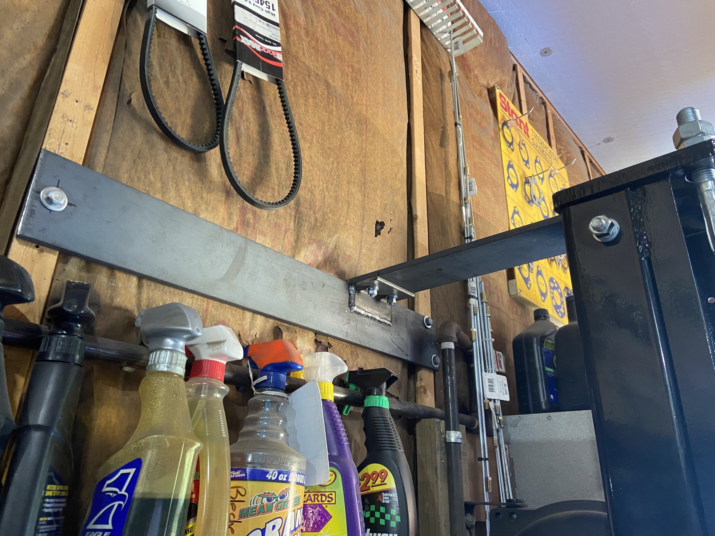

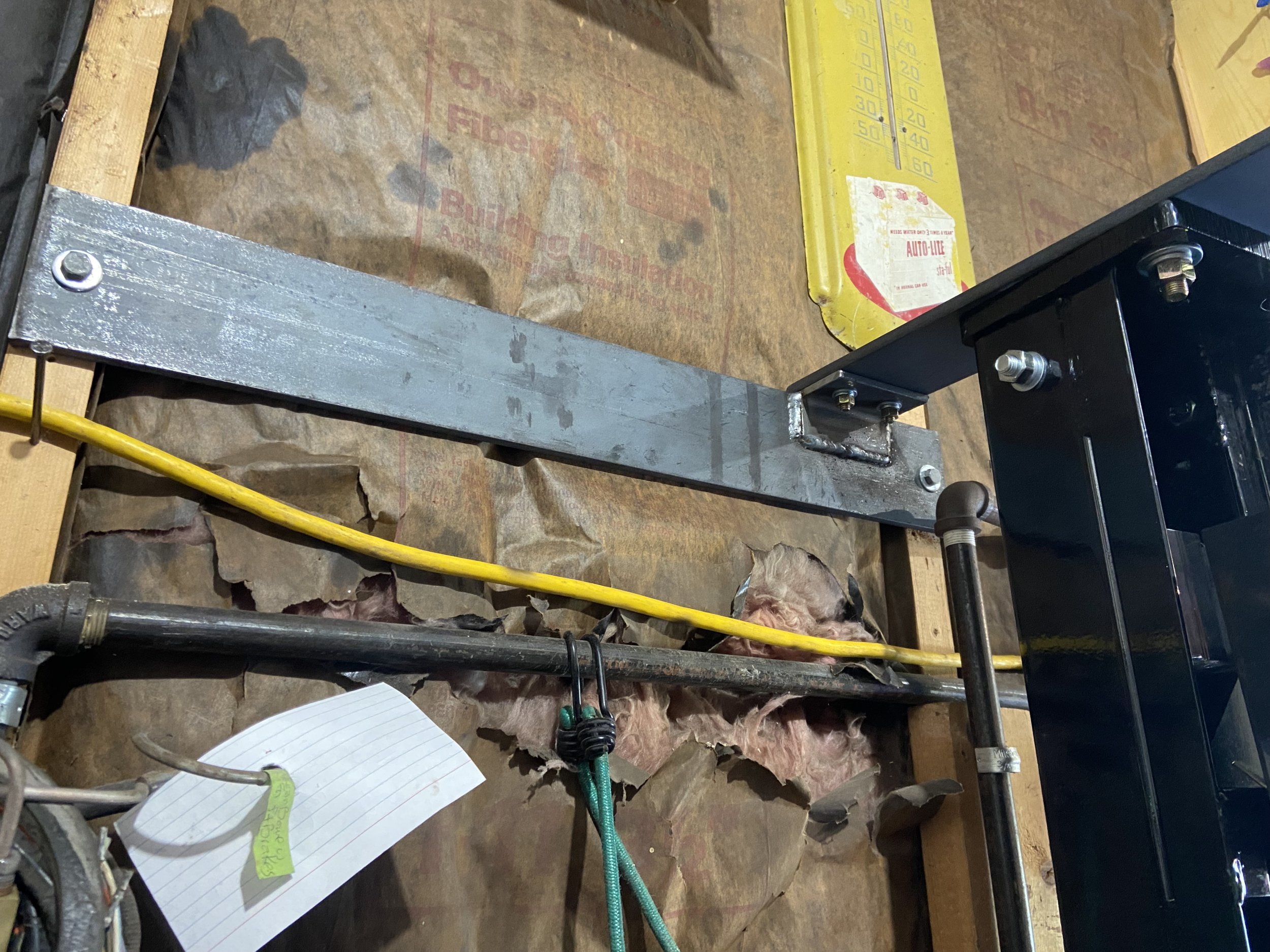

  27. ahshoe
    Joined: Sep 12, 2012
    Posts: 1,096
    ahshoe
    Never anchored mine to the floor. It is close to the wall on one side so I anchored it to the wall on 2 of the top posts. Solid as can be.
    seb fontana likes this.
