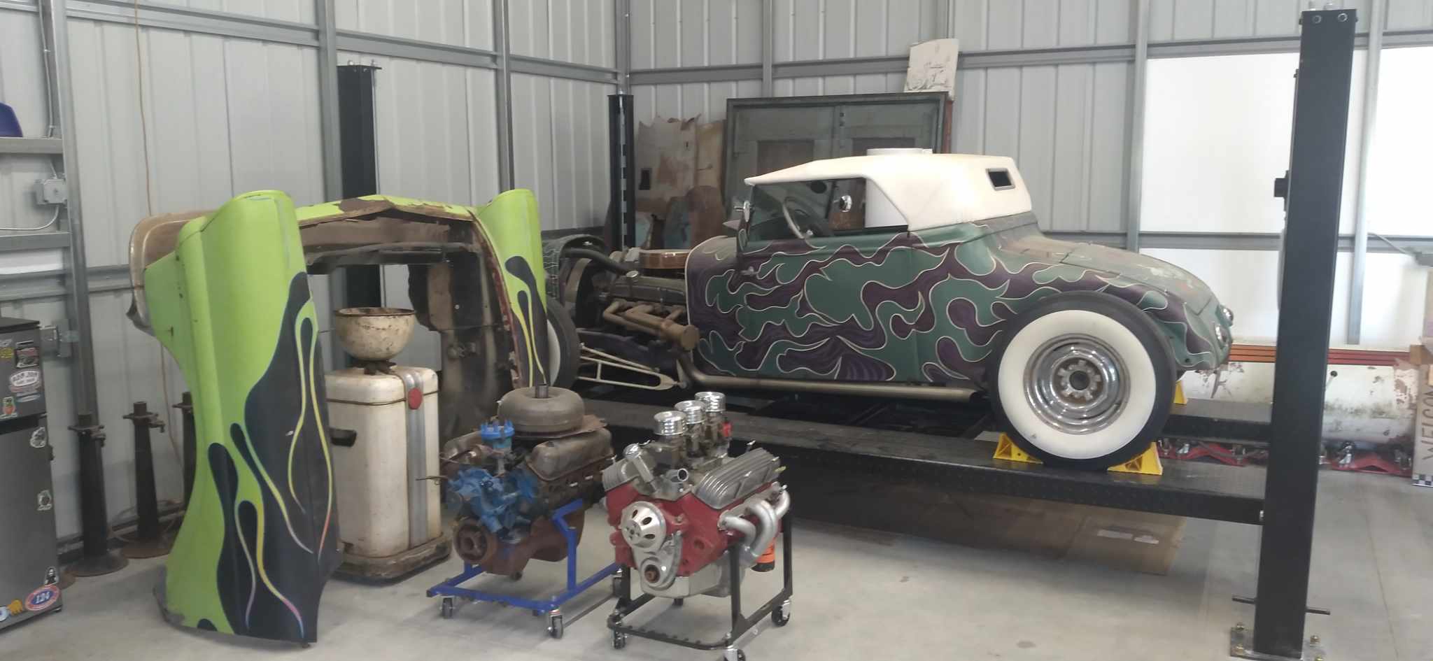

    I have a four post lift, I did not have it bolted to the floor and raised my car almost all the way up. scared the heck out of me as it started to lean. my floor is very level. I now have it bolted down and have no issues with it. 458979677_1559106698319619_2618932775232179093_n.jpg

    See post #48. My lift looks to be the same as yours, at least from picture. No issues.

    Why would it lean if the floor was level? The cables were not adjusted correctly is the only reason I can come up with. Bolting it to the floor only masked the issue.

    First, I want you to know that I don't mean to insult you by what I'm going to say. I've been in your garage. It's very well built, and your floor is just about perfect, but I'll bet that there is somewhere on that floor there is a low spot that water will pool, or it will run off. Either way, it won't be perfectly level.
    Seriously? Have you ever seen a concrete pour that was completely level? The answer is no. A sixteenth low here, an eighth high there and the floor is three sixteenths of an inch out of level. If you truly want a structure level, you start at the bottom and level the bases of all the columns. Then, and only then, do you worry about adjustments to whatever method of raising or lowering the lift that the manufacturer provides. Go back to my post #52 and study it. That is how steel structure is leveled and plumbed, and it's the same principle whether you're putting up a multi-story office building or a two post or four post lift.

    i should have said the lift was wobble until it was bolted down.
    all I know is that it works great now that it is bolted down,
    my other lift was the same way until it was bolted down.

    The lift company has explained what happened and took full responsibility. The style of lift was meant to be bolted down. It wasn't. The floor gave way and it fell over.
