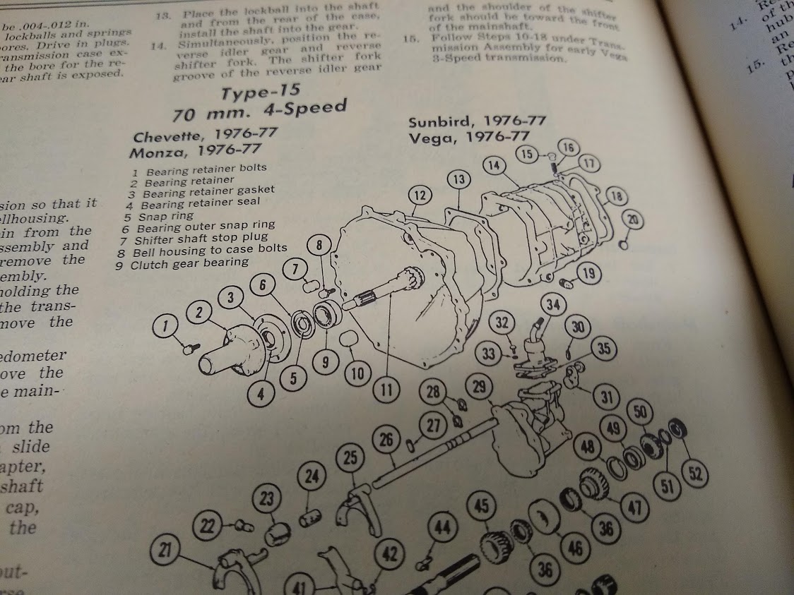

  3. I have a T4, it came in Monzas and such. Nice small ******. Is this what you are asking about? Has standard Chevy botl pattern. I would not put it behind anything with real power but I know a few that were hammered pretty hard by cl***mates back then. Basically a T5 minus the OD.

  5. I see some of them were also T5s and some 4 speed Saginaws?

  7. Jim, from what I have read between phone calls here today they used several different transmissions in these things!
