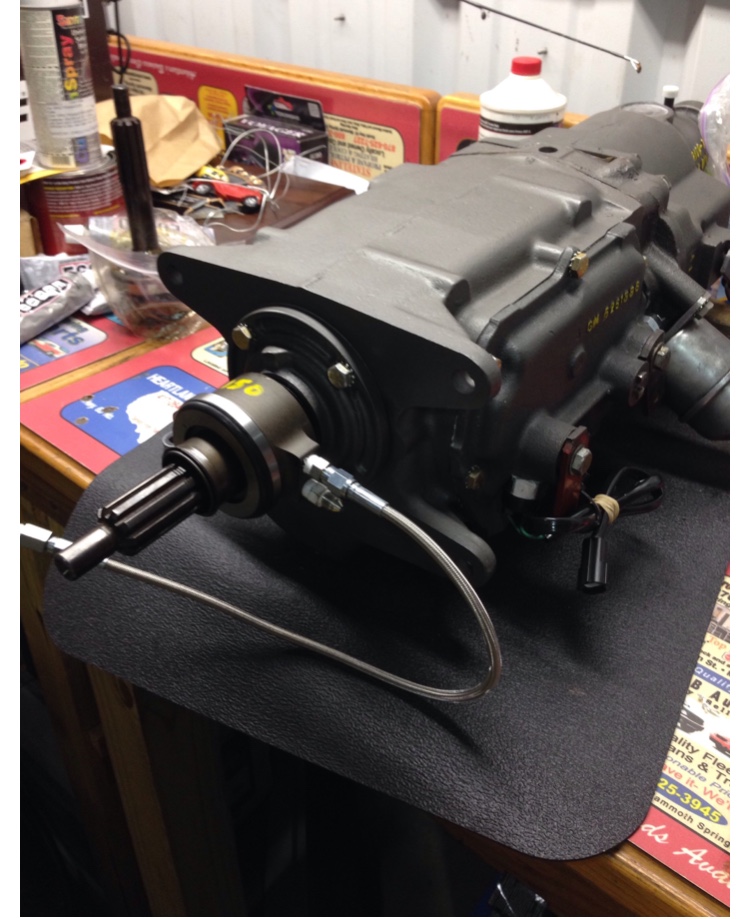

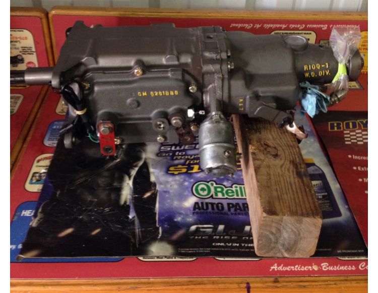

    One of the alliance member here on the hamb ‘s brother wrote this article on it for hot rod deluxe. Garage motor sports shop built it . I too built one after their article & love it. I bought another side cover & he had traced it out so I could cut it out so I could gauge where to weld the new fabricated curve onto reverse lever to engage it & prevent “rolling off “ . Great article titled how to get gone with detailed pics . Flux FCD27458-4B8A-48E4-A1E7-0C19B5FDF02B.jpeg
    79FCB0D1-B0BD-4586-89AD-C3FFB8C70AD8.jpeg If you consider going this route, also be aware there’s no where to mount the shifter. You can go to my slow moving build thread (53 150 Build) to see pics & description of how I fabricated the hurst shifter off a Muncie 4 speed to work on it . Flux
