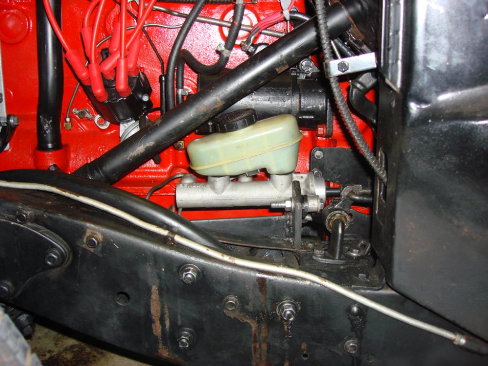

    I just wanted to update this thread and let everyone know the progress I have made on my brake problems. Which is none. I ended up purchasing a 1 1/8 bore MC from mpbrakes to replace the 1" bore I was using. It didn't make any difference and the pedal still goes to the floor. I actually drove the car around the block to test the brakes in a real environment and when the pedal goes all the way to the floor, the car slowly rolls to a stop. I then replaced one of the calipers, same problem, and then replaced the other, same problem. I then replaced the original brake light switch junction block with a plain 3/16 tee and that didn’t help anything either. I talked to Charlie Ackers and he couldn't explain the problem but told me the calipers are from a 1978 Camero and are not low drag. I know it seems like air in the system but I don't know what else I can do to remove it. I used a Motive power bleeder, removed all 4 calipers and blocked them with wood. Bleed a gallon of brake fluid through them while rotating the calipers and tapping on them. Then did more bleed using the standard pump and hold method and the fluid from all 4 calipers seems perfect with never a bubble in sight. The rear brakes again seem fine because if I put a plug in the front port the pedal is rock hard. If I move the plug to the rear port, the pedal is soft again.<?xml:namespace prefix = o ns = "urn:schemas-microsoft-com:eek:ffice:eek:ffice" /><o:p></o:p>
    <o:p></o:p>
    The only thing I can think of is to buy a disc/disc combination valve. I didn't think one of those would solve the issue of no brakes but I am completely out of ideas. I can post some pictures of my setup if anyone thinks that will help.<o:p></o:p>
    <o:p> </o:p>
    Thanks in advance for any advice.<o:p></o:p>
    Brett

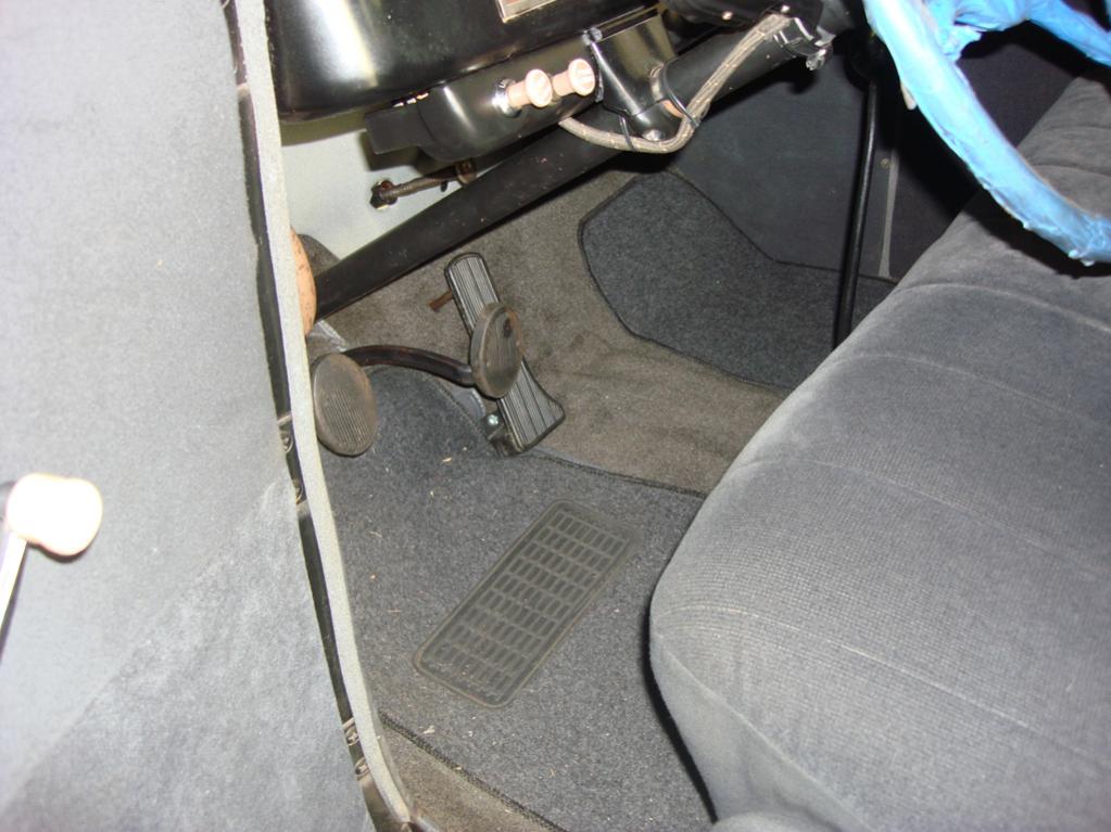

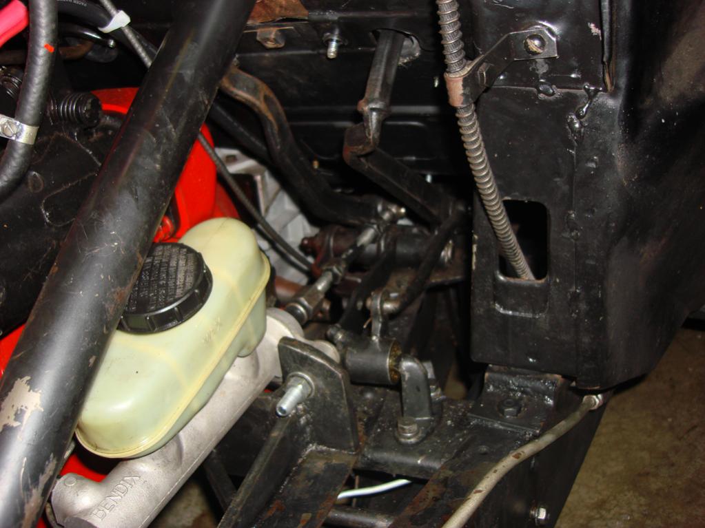

    I just wanted to update this thread and let everyone know I finally found out what the problem was. As it turns out, I was not getting enough push rod travel. Even though when I measured the travel and compared it to my dad’s disc brake setup on his 57 Chevy, it looked like I had enough, but didn't. In the end, I needed about 1/4" more travel than what I was getting. The last 1/4 inch of rod travel is where the brake pedal really gets firm and now I can lock the brakes up with ease and the car stops on a dime. I had to adjust my brake pedal all the way up. I gained about 2” of pedal travel, which equates to about 1/4" of push rod travel. I'm using the original pedal assembly and it is kind of at a funny angle now but at least I've got brakes.
    My setup is odd now but it works so well I don't think I am going to change it. After I ordered the $120 MC from mpbrakes and it didn't solve my problem I went to the junkyard and pulled a power MC off a 1994 mustang with the combination valve, $12 (I have a great u-pull junkyard 5 minutes from my house). After I plumbed it and still had problems, I turned my attention to pedal ratio and travel and uncovered the real issue.
    I've read everywhere you are not suppose to use a power MC with manual brakes but it seems to work fine for me. The other reason I think it will be fine is my dad has built three Factory Five Cobras over the past few years and with those kits you use the MC from the donor mustang without the booster. The mustang MC is a Bendix unit with a 1-1/16” bore. Don't know how shallow the bore is but my push rod will certainly not fall out so I am not worried about that. Attached are some pics of my setup, forgive my peeling paint as I have spilled and squirted gallons of brake fluid around this area.
    Thanks for everyone’s help and suggestions.
    Brett
