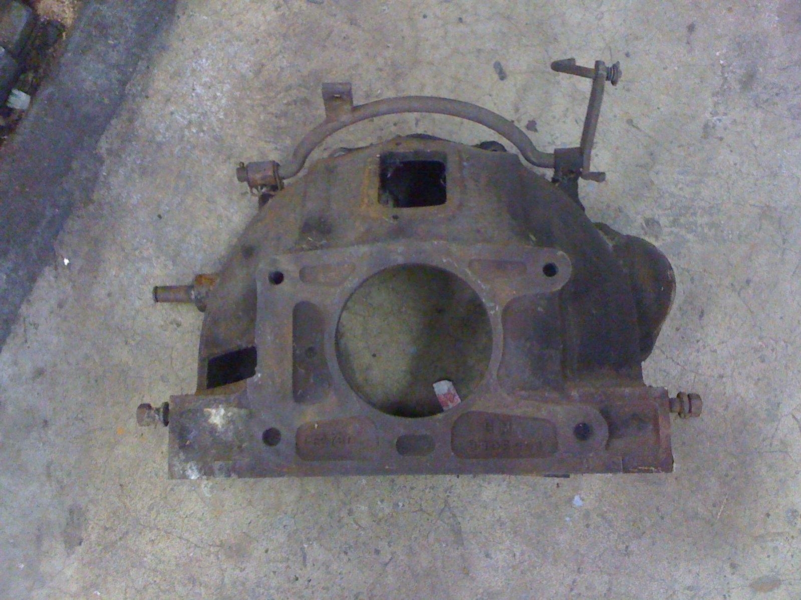

    Here's the new plan after talking with Patrick's Antique Cars and Trucks:
    -270 GMC.
    -270H GMC head (H is for hemispherical.)
    -Dual Carb Intake.
    -Split Exhaust.
    -235 Chevrolet Harmonic Balancer.
    -1948-53 Chevrolet Truck Bellhousing. (Casting No. 3701433)
    -Saginaw 4 Speed (with 2 I.D. ring meaning 3.11 first gear.)
    -1955-62 Chevrolet 1/2 ton Truck rear end (Casting No. 3707340).
    -Patrick's 3.38 ring and pinion kit.
    I went down to a salvage yard yesterday, couldn't find a 1955-62 Chevrolet rear end, but I did find a 1958 GMC 100 with a Dana Spicer 45 rear end. I saw on a few other H.A.M.B threads that the Spicer 45 is somewhat interchangeable with the Chevrolet truck rear end and that Patrick's kit should work with the Spicer (although I haven't asked Patrick himself.) I took some measurements on the Spicer (56.5 in from backing plate to backing plate) and found out it was 2 inches longer than my '40 Chevrolet (54.5 in from backing plate to backing plate.)
    First off, are these measurements right? I didn't have a pencil to write down the measurements when I got them, and knowing my brain I could twist those numbers up real easy. I've been looking around on the internet, and can't find them anywhere. They've got to be somewhere, does anyone know?
    Secondly, if the measurements are correct, does it make that huge of a difference appearance wise? I probably have enough room inside the wheel wells, but I'm not sure how much of a difference one inch on either side makes. Also, are there any easy tricks to shortening the axel length even just a little bit?
    Thanks!
    Pete

  12. The spicer 45 rear does not share any parts with the Chevy rear. It's a completely different animal. The spring pads should be in the same place as a Chevy of the same era (55-59) but other than that nothing interchanges to my knowledge. FYI - Some of those spicer 45s had 3.08 gears in them.
    When you are measuring for a rear diff, you should measure from the wheel mounting surface to wheel mounting surface, not from the backing plate. On the 55-59 rears I think it is 60", if I remember correctly.

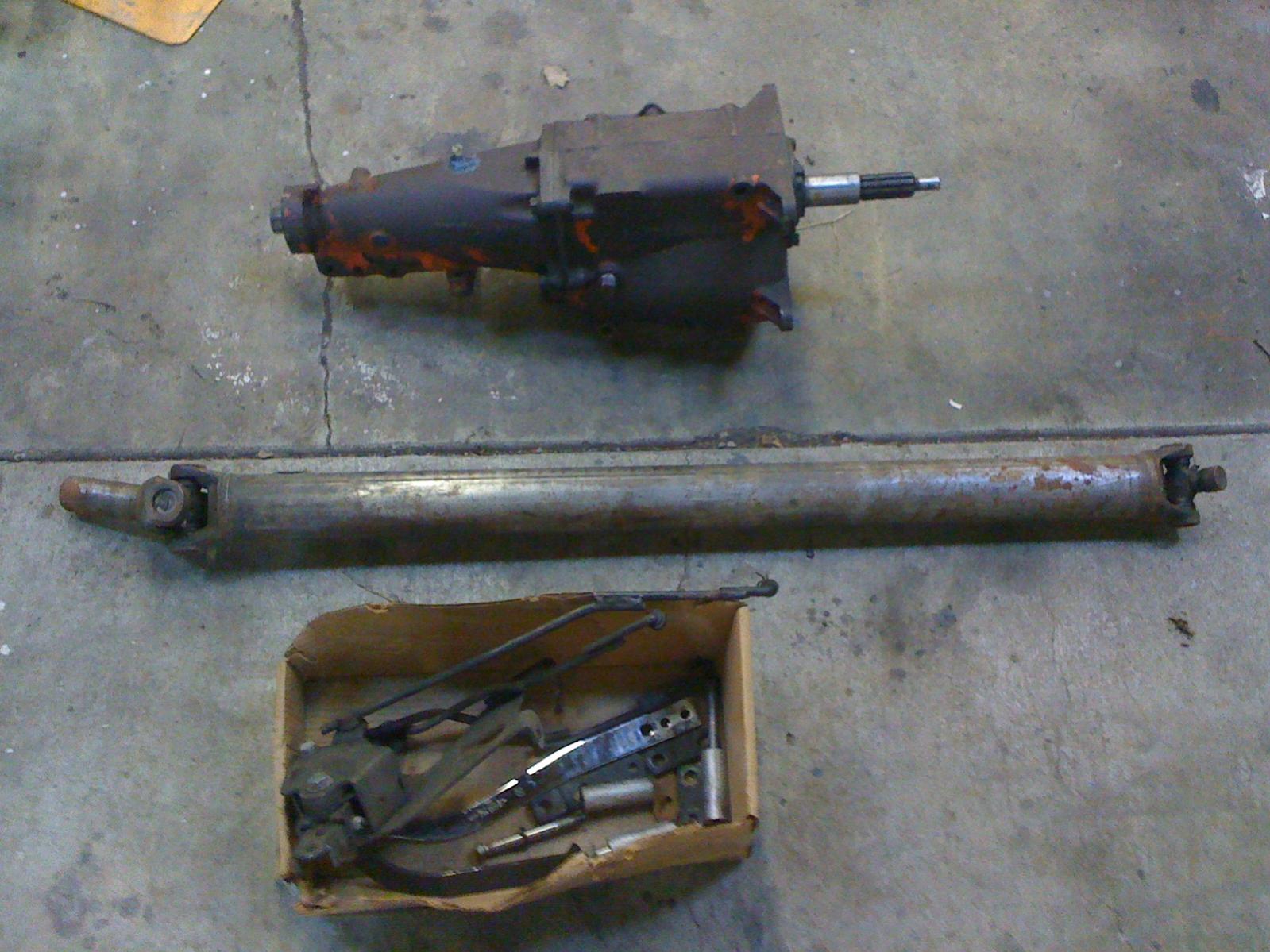

    Another update on the car... I have a Saginaw 4 speed, floor shift kit, and a driveline with a yoke to fit on the tranny. Bought them on the classified ads from Andy52 on this very website!
    Special thanks to Andy, just an absolute prince of a man. My grandpa, him and I swapped stories for about an hour out in the cold, and we could have gone on for the rest of the day easy. Andy, if you ever get to read this message, Thank you!!!
