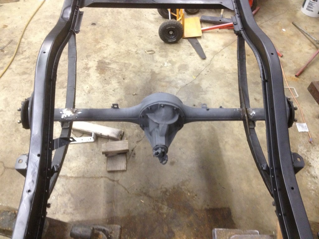

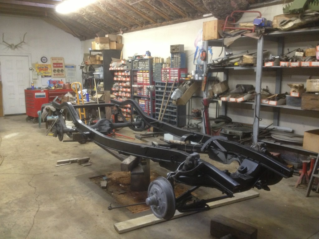

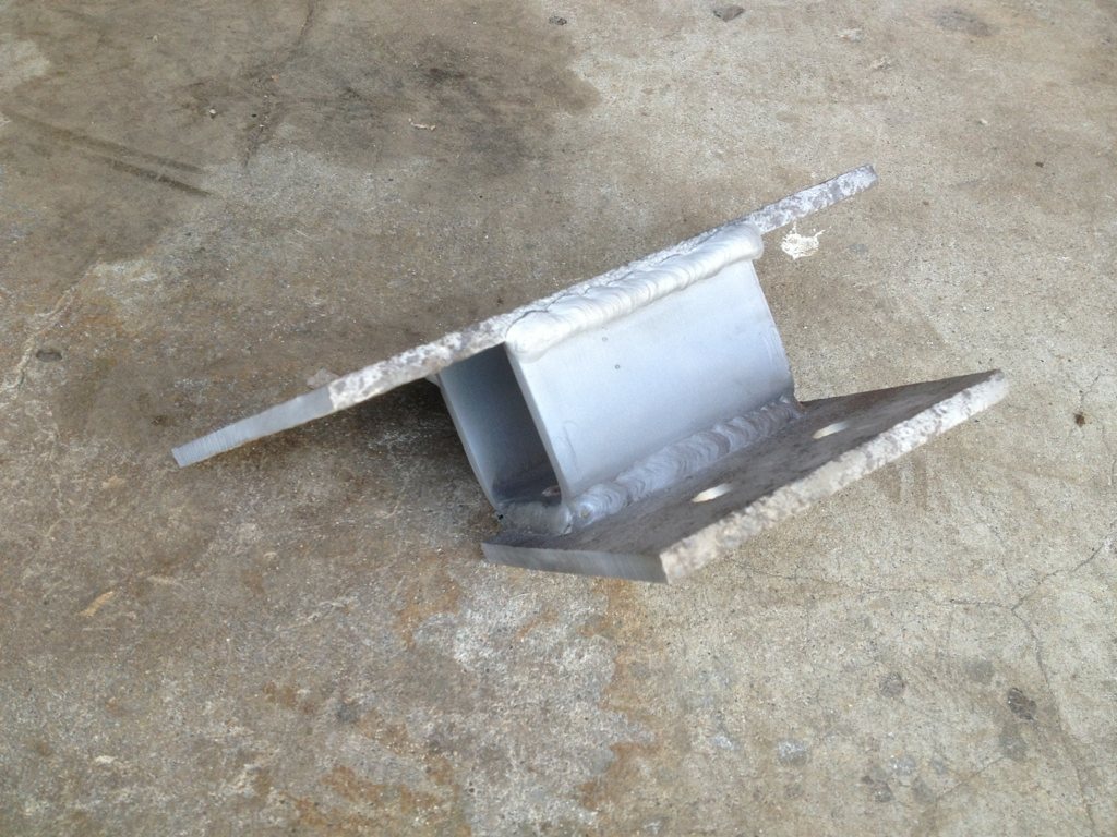

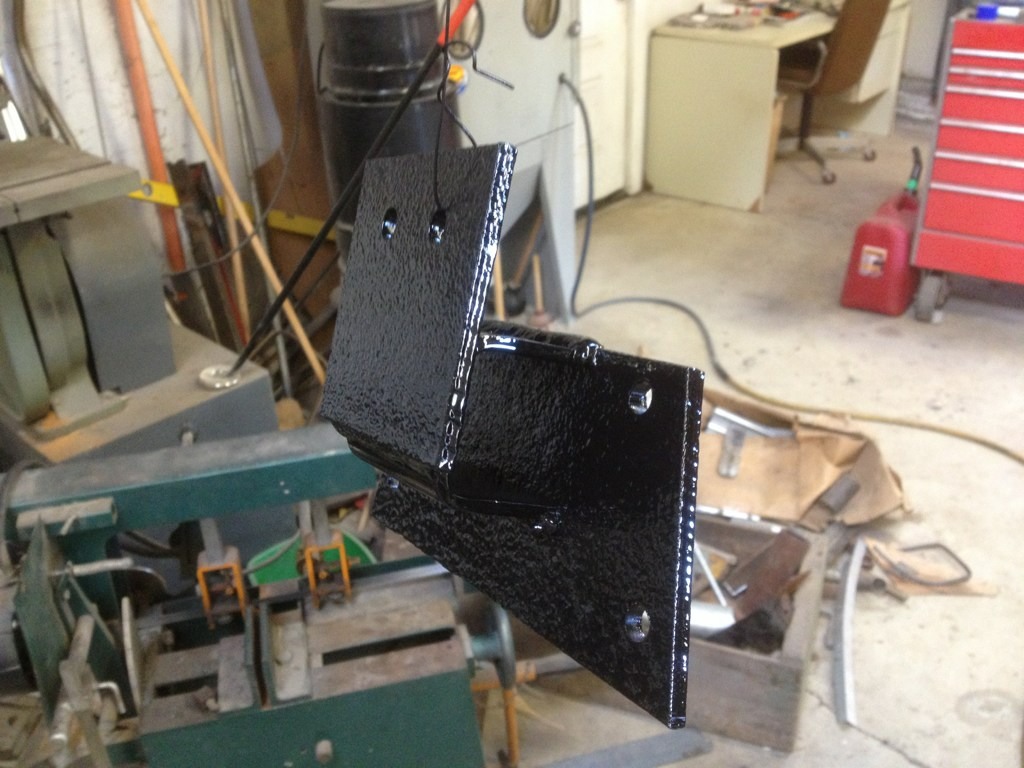

    Progress from today. We faxed in the order for all of our parts. That hurt. Then we put the front end back in. We also welded in the new mounts for the rear end (it originally mounted from the bottom.) I'll let the pictures do the talking from here...
    Thanks!

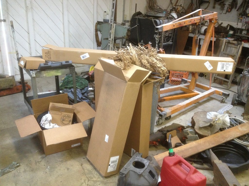

    Parts, Parts, Parts!!!
    Pete

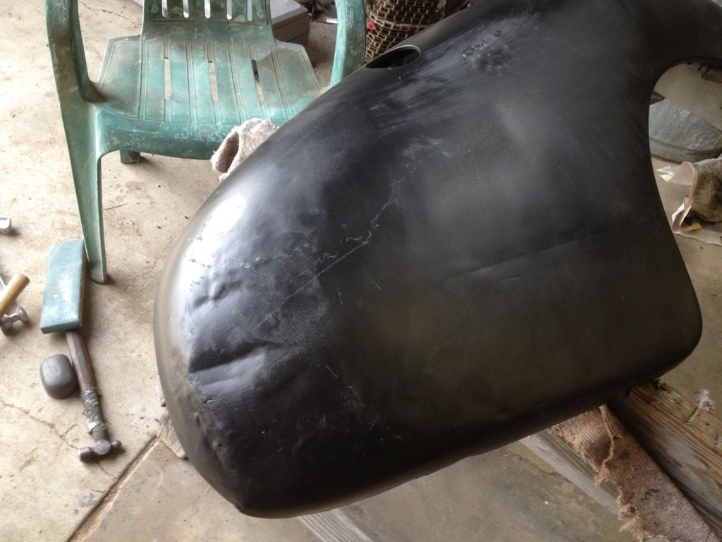

    Things are moving here again! We picked up the body today! Now with all the bondo gone, we wish we had never touched it, but hey at least I don't have to stare a that bare frame any longer. I have to say that whoever did the bondo work on this car did a fantastic job! The car looked laser straight when we got it, but now, it looks like it could have been in a destruction derby! Haha, it's actually not that bad. There is just going to be a day or two of bodywork. I'll let the pictures do the talking...
    I also got to try my hand at "picking and filing." It truly is an art form. My hat goes off to you metalworkers out there!
    Thanks!
    Pete

    Haha agreed! I'm learning slowly... Took me most of the day just to do the bondo work on the rear section of that fender I was beating on yesterday. I'm happy with the result. I still have to do the front part of that fender, but that's just about the worst of it. The rest of the dings are not so bad. They can easily be fixed with body filler. Also, the pistons for the 270 are scheduled to arrive here in the next few days... Might finally be able to put that engine back together!
    Thanks!
    Pete

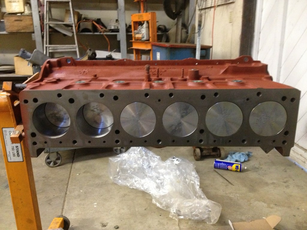

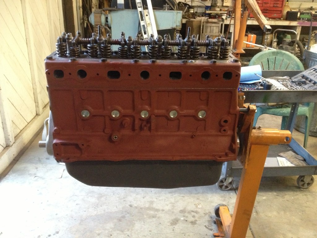

    Let the engine rebuild begin!
    Woohoo!
    Pete

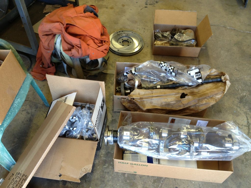

    from Idaho!
    Yesterday was kind of traumatic. We went to put in the crankshaft and realized that we did not have the main bearing caps. Then we tried to do the next best thing and put the cam shaft in. We then realized that the camshaft was too far in. After a few hours of cussing and a trip to Rocket Motors to see Rockey Marino (I think he's on this site) we realized that we didn't have the backing plate underneath, so we put that it lined right up. Then after a trip to the engine builder (Thanks John for coming down after hours!) to get the main caps. Everything flew together in a matter of hours. We're still mising two of the rod bearings, so that's why the picture shows 4 pistons all the way up at once, but I'm sure those will turn up eventually. They're probably up at the engine builder aswell. They're not that crucial now. We can go ahead and put the head, rocker arms, tappats etc. in and bolt up the last two rods on monday. Anyhow, that's where we're at, more to come today!
    Thanks!
    Pete

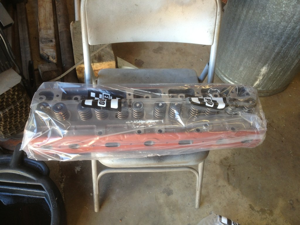

    Today was interesting. We dinged around with the Cam Shaft even more, realizing that there was a little oil dripper above the timing gears. After looking at and reading a few manuals, we realized that ours was different than the one in the manual. Our manual shows that the one end above the timing gear is crimped down to increase pressure. Ours is wide open. What do you guys think? Did what I just say make any sense at all?
    About noon, we got a call from a good friend of ours. He was down at a swap meet in Sacramento, Ca and saw a Nicson 2X1 intake w/ heat for a 270 GMC. He wanted to know if he should buy it. I almost dropped the phone. The guy wanted $375. After some haggeling, we could only get him down to $350. Pretty expensive, but the way I see it, it has two Rochester single barrels on it- throttle linkage and everything. $25 buck a piece for rebuild kits and I see them rebuilt going for $250 bucks on ebay. I think rebuilt with linkage, I'd put them up for $350 and see if I get any bites. That should re-coupe some of the money...
    I then tore apart our two Zenith Carburetors and stuck them in an over-night bucket of Carburetor Cleaner while my grandpa took apart and cleaned up the distributor.
    Oh yeah, and we put on the head. We're still waiting on the last two sets of rod bearings (will pick those up tomorrow most likely.) Then we can put everything else on.
    Man, I'm excited about that intake! I've been looking for one of those for almost a year now! Good timing too!

    Last two sets of rod bearings are in. Oil pump is in too. That's it for the internals! All that's left is to put all the covers and gaskets on and bolt up all the external stuff (oil filter, water pump etc.)
    Pete
  24. BlackJackPG
    Joined: Mar 23, 2012
    Posts: 158
    BlackJackPG
    from Idaho!
    Covers are on, distributor is in, water pump is on, carburetors are part of the way rebuilt.
    Pete

    The H head is good! From my studies, the small port is just fine, but the H is an added bonus! Good for you!
    Engine is in and painted. It sure is bright!
