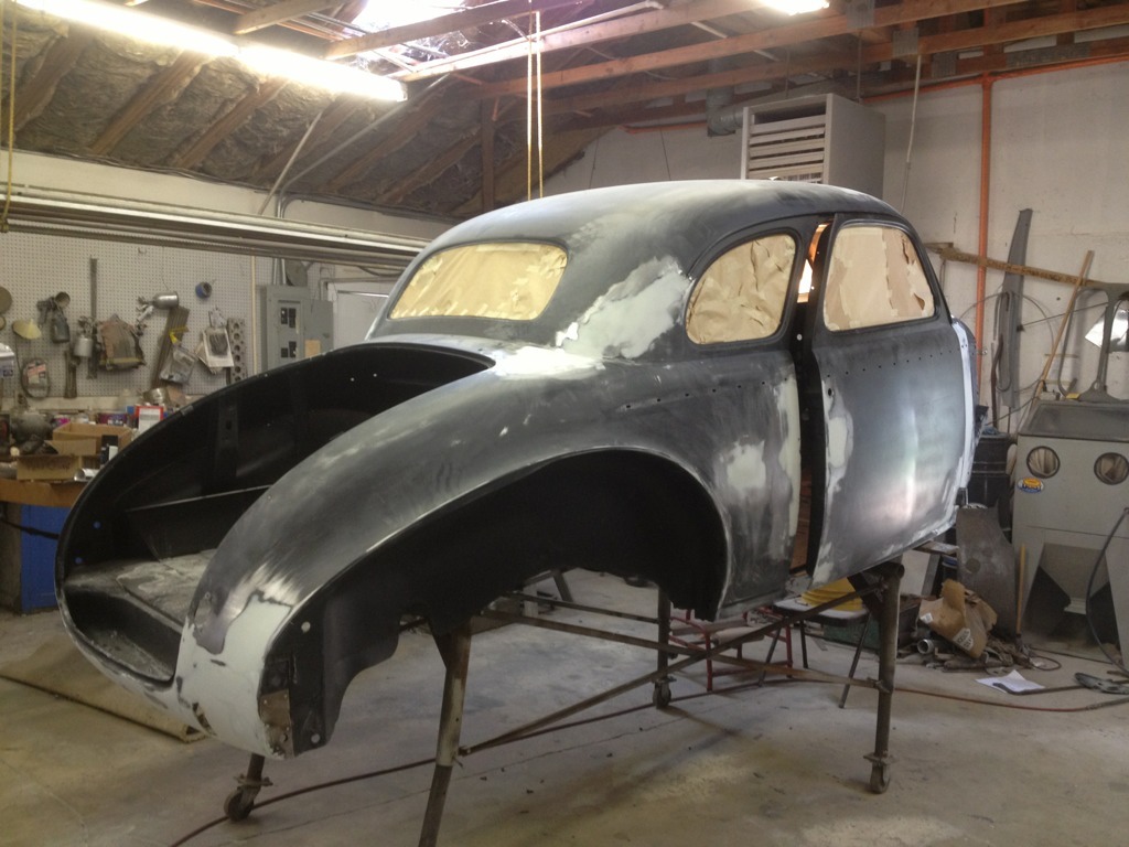

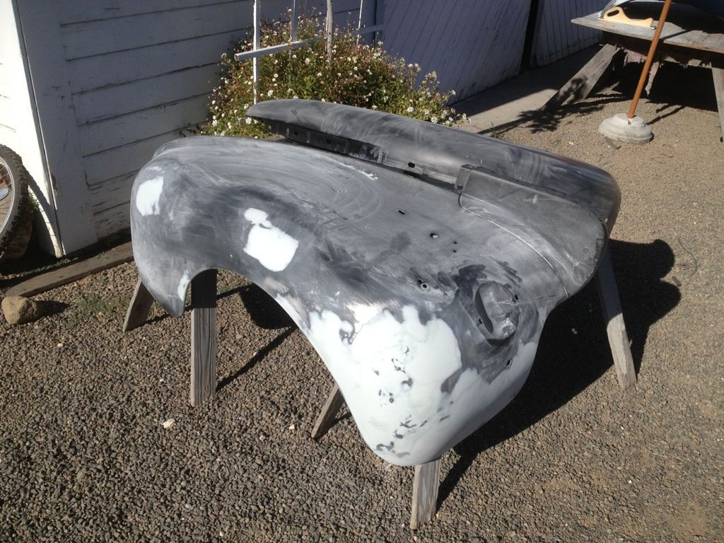

    Sorry for the delays. A lot of personal stuff going on right now. Anyhow, I was able to get down to the shop for a day full of spreading bondo and sanding it off. I've been thinking about the motor idling high the last few days, and was poking around the motor when I found that one of the studs for the heat riser on the bottom of the intake was missing. Vac*** leak!!! Plugged it up, and it is now idling at 900rpm. Good deal!

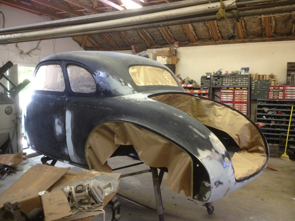

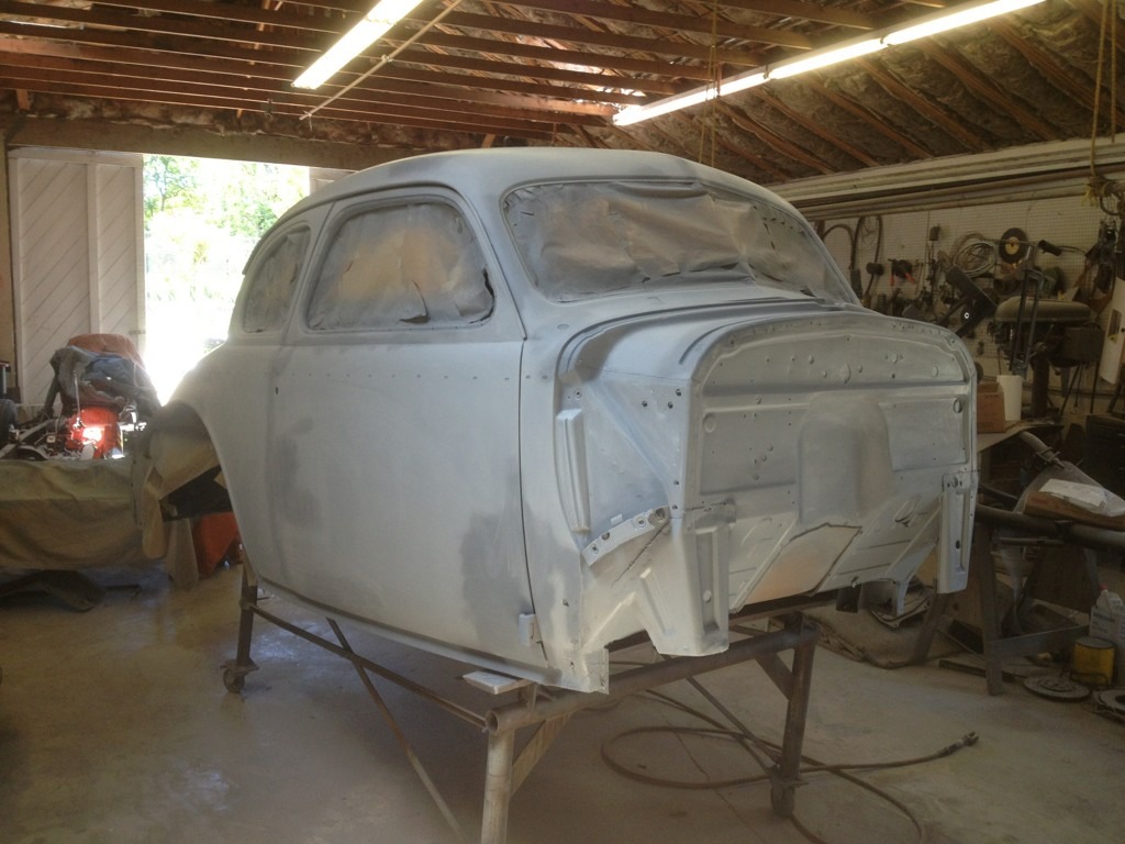

    Just about everything is bondo-ed up! I started taping off all the holes for the first few coats of blocking primer! It's starting to get exciting! We also sandblasted and painted a bunch more parts. I'm just glad to be back in the shop. I almost shriveled up and died from withdrawl the last few days, so it's nice to be back.
    I was having trouble with the video, so it was reposted, new link here: https://www.youtube.com/watch?v=2DJOJct5aAQ

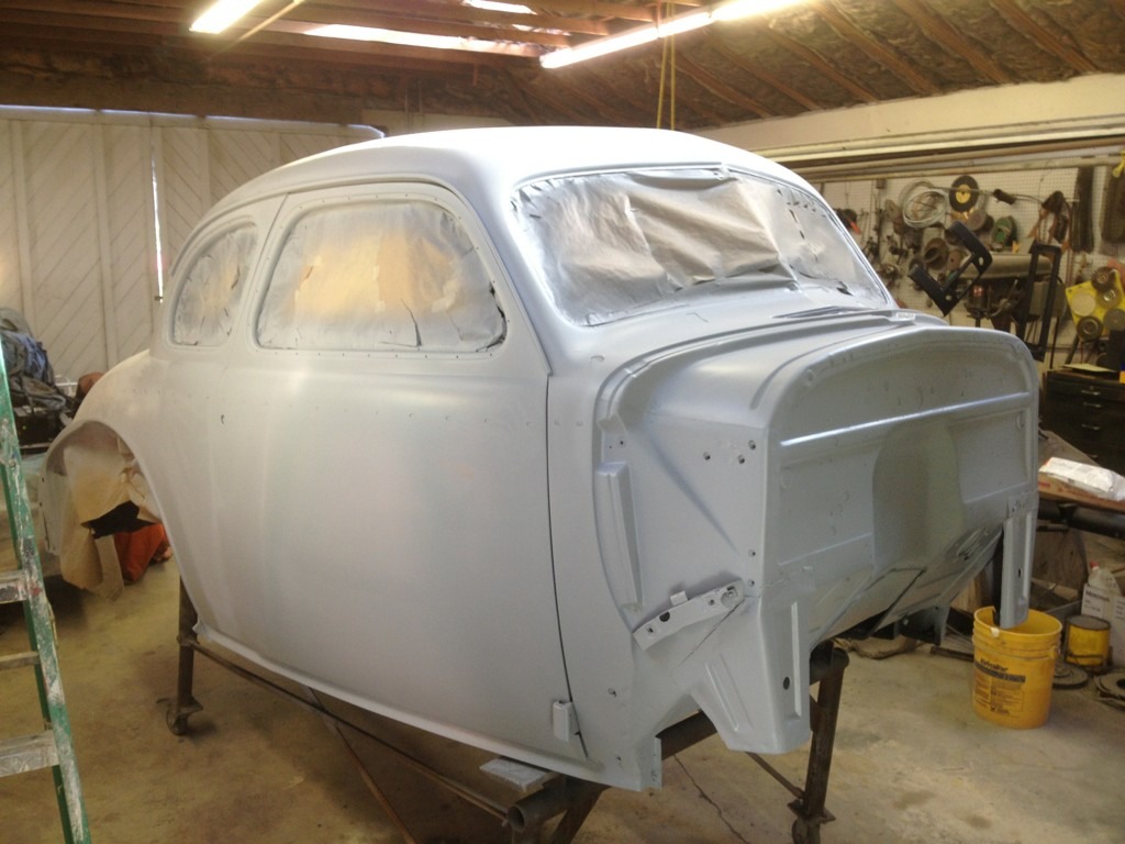

    The car's getting so nervous it might start changing colors here pretty quick! The first few coats of blocking primer are going on in the morning.
    Thanks!
    Pete

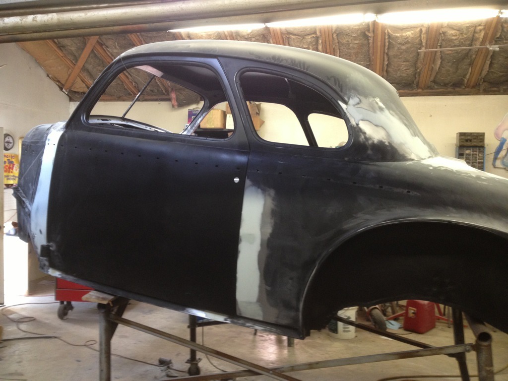

    I spent most of the day sanding the body. I've got most of the bumps worked out with 150 grit sandpaper. We're going to go down to 600 grit, so there's plenty left to do, although it should get easier as the sandpaper gets finer. Boy it's tedious stuff! Not sure if I've already said this, but my hat goes off to you full time body workers. It's brutal. Anyhow, I'm going to spend the next few days up in Indiana doing college stuff, so it should get pretty dull on this thread at least until about mid-week. Hopefully grandpa might get a bug in his **** and go sanding some more, but I don't want him to work too hard.

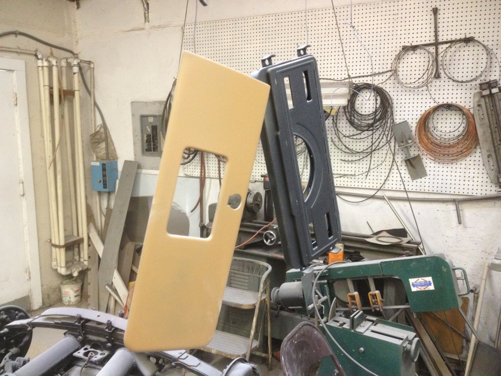

    Also, we looked around at some local hardware stores and found a good color for the dash. It's pretty close to original, so that's good. We'll put it all together, then decide if we want to go the extra mile with the wood graining. I think it looks okay.

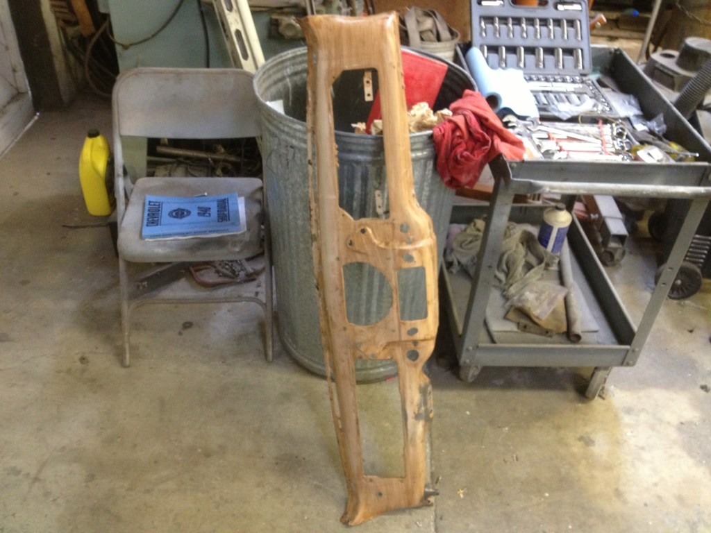

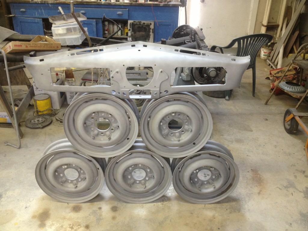

    Progress from today: Rims and dashboard are sandblasted. The dashboard components (glove box lid, instrument panel etc.) are painted. I think they turned out well. Also, gramps spent the day polishing chrome and putting in the new gl***. It really looks great!

    As you know you've got an 8 slot wheel down there on the far right bottom row, that's a more valuable wheel as it's only a one or two year make for the Chevies. I have one, if you find someone putting together a set.

    Wow! No, I didn't know that! I did noticed one was different, but not desirable! We were just going to use it as a spare, but I might consider selling it now. Cool, thanks Cosmo!

    Progress from yesterday: The dashboard is painted. It looks pretty nice, then I was struck by the obvious. Why not just paint it the color of the car? Haha, again we'll see how it turns out, but if worst comes to worst we can always use the left over paint from the car. We also built the linkage for the clutch pedal to the lever on the bell housing. Then we drove to our closest paint store to pick up the paint for the car (about an hour drive.) On the way back, my '01 Jeep Cherokee stuck an exhaust valve and that took a good portion of time to diagnose and fix. These last couple of days have been pretty slow. I hate not getting a lot done, but what are you going to do.
