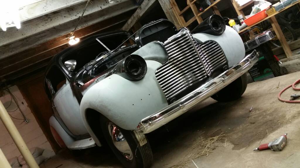

    Nice ridem man. Here is a shot of my 40 early style kustom.
