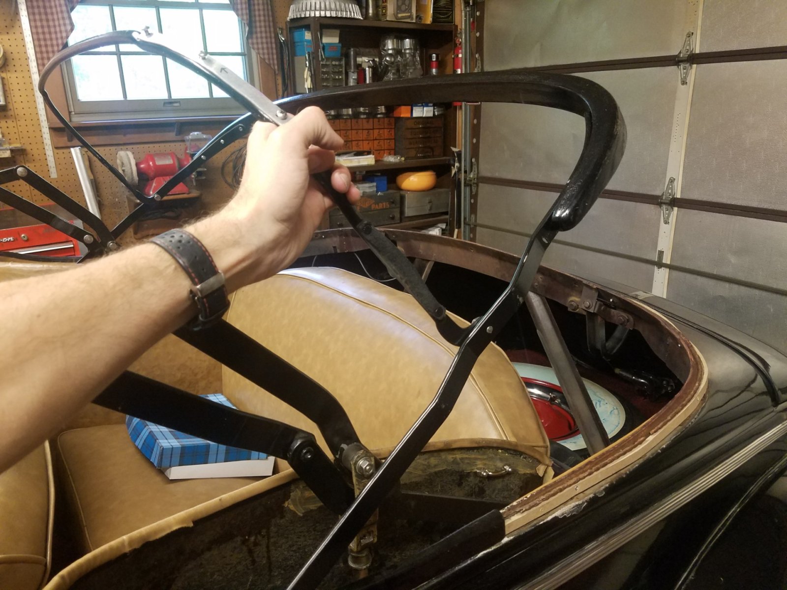

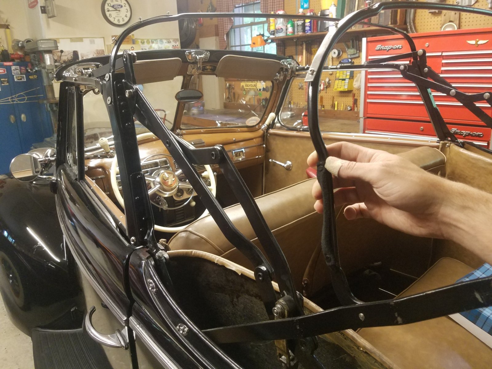

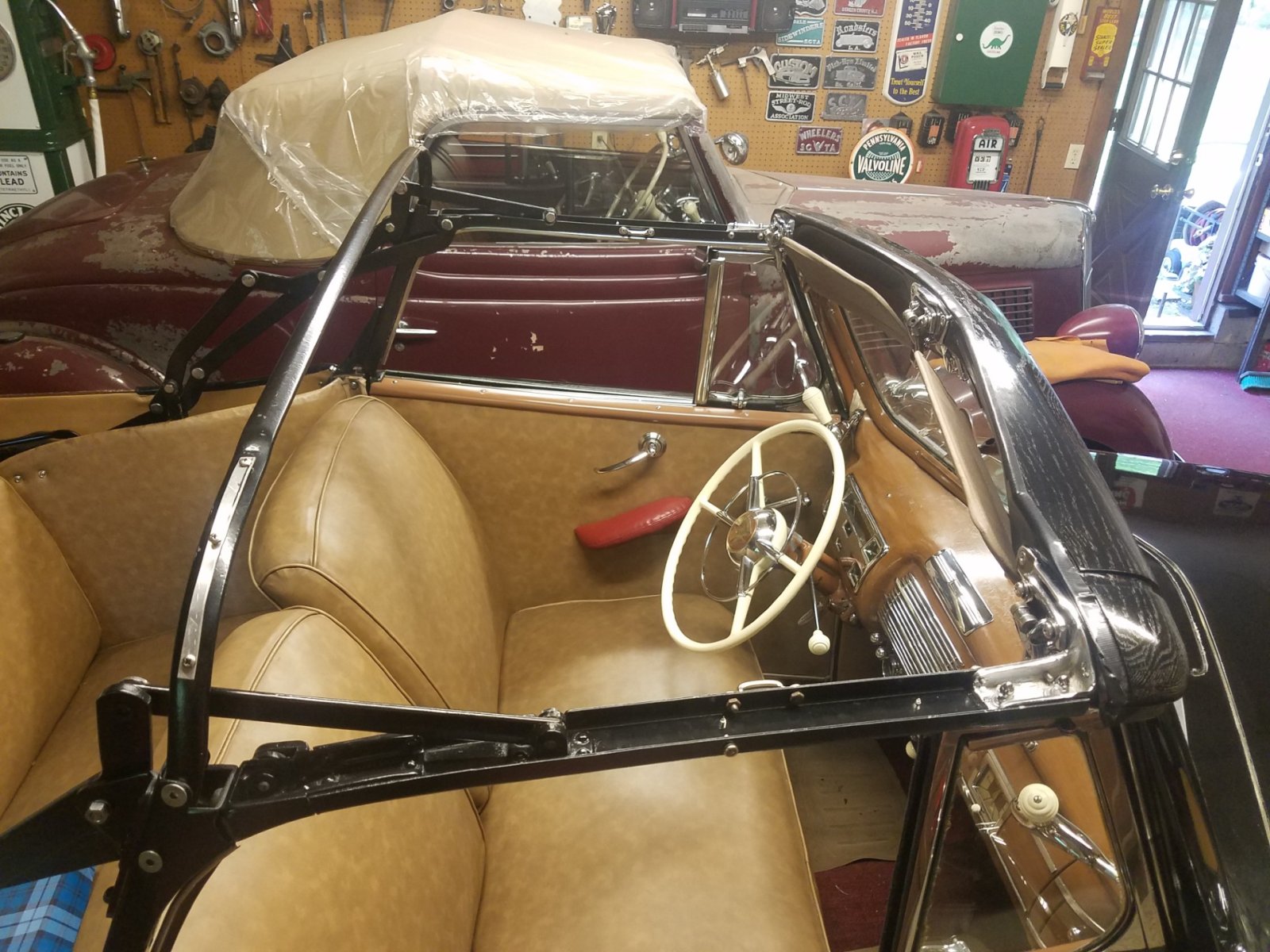

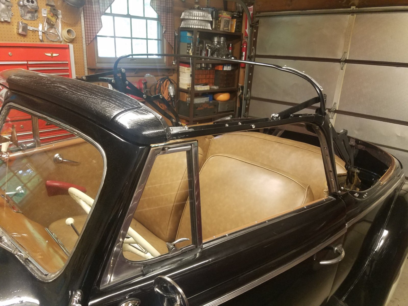

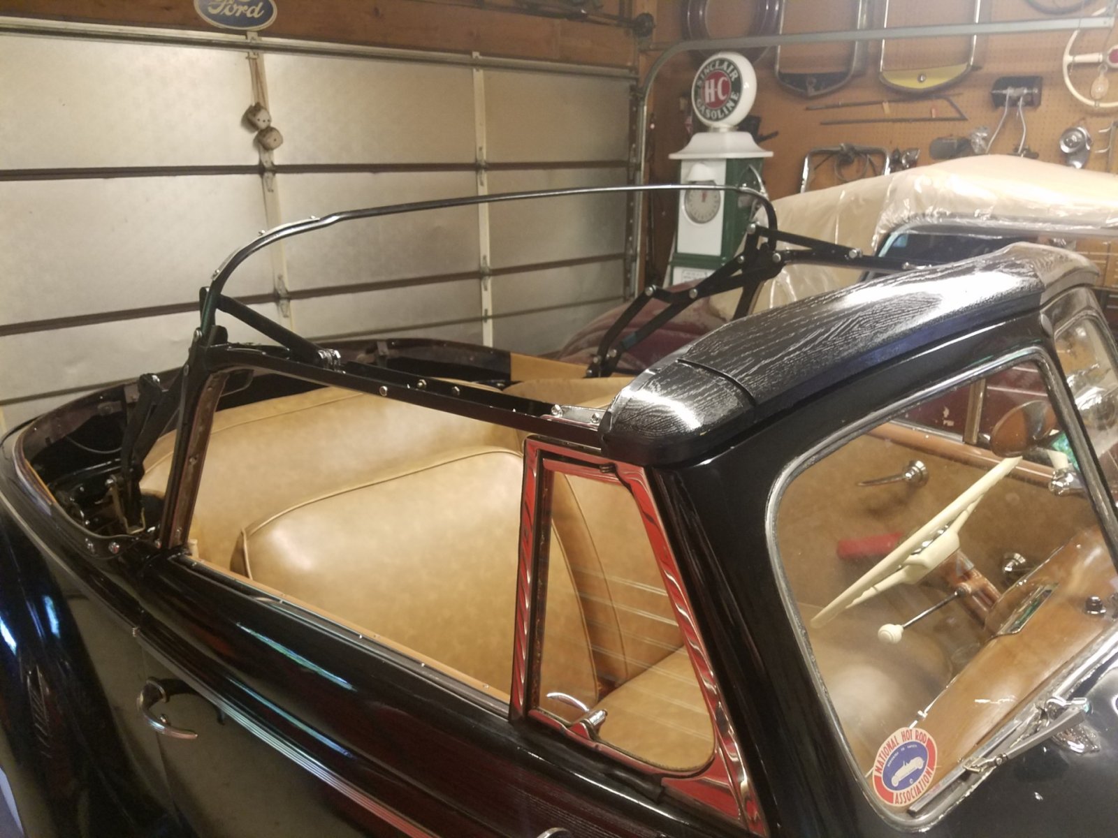

    Could someone post a pic of a 40 ford convertible top irons. i have piece missing and dont know what it looks like. Thank you

    Here's some shots of the top frame on my car after I restored it before it went to upholstery. Hope it helps? thumbnail_20190528_174436.jpg thumbnail_20190528_174450.jpg thumbnail_20190528_174510.jpg thumbnail_20190528_174527.jpg thumbnail_20190528_174611.jpg thumbnail_20190528_174618.jpg
