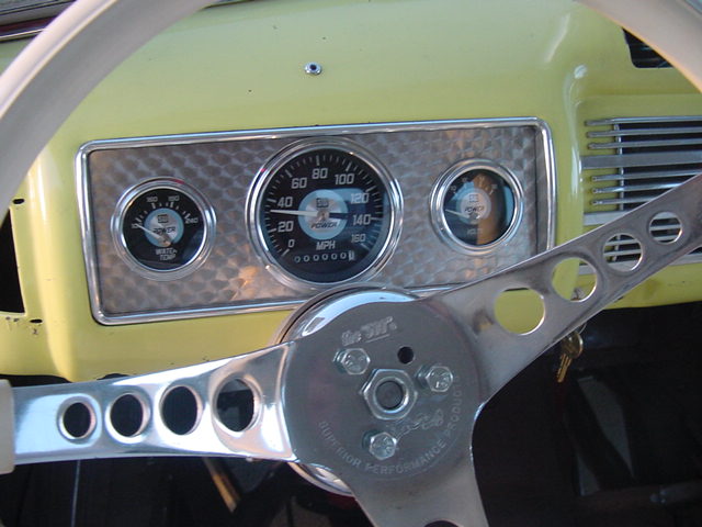

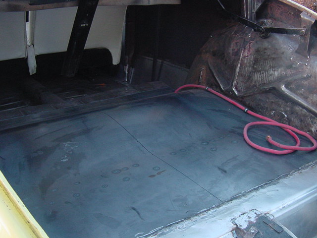

    Since then, got the trunk floor in with a little more help from Hiboy 32 (jeff) Just decided to use sheet metal in the trunk and also replaced the floor pans with stamped pieces from Paul Bradley out of No. Carolina (very nice pieces) the tunnel was good so left it in. The rockers, 1/4 piece's,rear pan and tool tray also got replaced all from EMS. Got the body back on the chassis, had 128 louvers punched in the hood and started mocking everything up. Bolted everything on the core motor to make sure everything is going to fit where it is supposed to. Roadburner1 (Davey) gave me a hand with the custom alt. mount some fab work on the brake and clutch pedal****embly and a cool little column drop. All the plumbing is complete front to back, driveshaft is in and exhaust including speedways new ramshorn manifolds and flowmaster mufflers. Still have to run the dump pipes. New walker radiator. a kick**** gauge panel from Karl Knecht @ Knecht equip Co. in Arlington Tx. holds the speedo,volt meter and water temp. a matching panel will hang under the dash and hold the oil pressure and fuel all by S.W. The tach is vintage, found it at the Pile-Up swap along with the white superior 500 wheel. The real motor is being built in Sioux City Ia. and should be ready by the middle of Feb. 283 sbc, bored 30 over nice little bump stick, double hump heads that have been milled, ported and flowed, roller rockers forged crank and pistons. I'll run either the 4x2 set-up in the pic's or a vintage low-rise 2x4 intake with 2 500 edlebrocks. The plan now is to take it to the body shop where he will pre-fit all the panels and gaps, then take the body back off the chassis so he can continue the body work and I can bring the chassis back home blow it all apart, paint everthing and re-assemble it for the last time. Then I'll take it back to the body shop where we'll put the completed shiney black body back on the chassis and Tom will re-assemeble all the body panels. I'll still have alot to do when I get it back ( wiring, interior, trim, glass etc.) but really want to be driving it this summer, maybe at the HAMB Drags. Heres a few pic's. Gary
