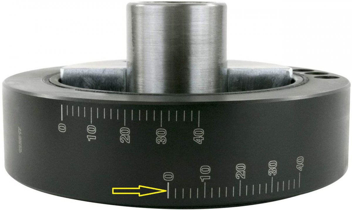

  28. Penetrator
    Joined: Aug 25, 2011
    Posts: 514
    Penetrator
    from SK CAN
    What it most likely means, is you have the wrong pointer location on the wrong "zero". In the example below, one pointer's zero is 32 degrees ahead of the other pointer's zero.
  29. Jimbo Nettles
    Joined: Jan 31, 2021
    Posts: 42
    Jimbo Nettles
    Thanks for the explanation! Yeah I'm getting it from number 1... It just baffles me.
  30. Jimbo Nettles
    Posts: 42
    Jimbo Nettles
    This looks almost exactly like my balancer! Ok so how does that compute with me getting air pushing past my finger when I come up on the zero mark that I highlighted with the paint pen? That's what I don't seem to understand, if I'm not mistaken there's only one spot on the balancer where my finger will get pushed out by air and the piston coming up on top dead center
