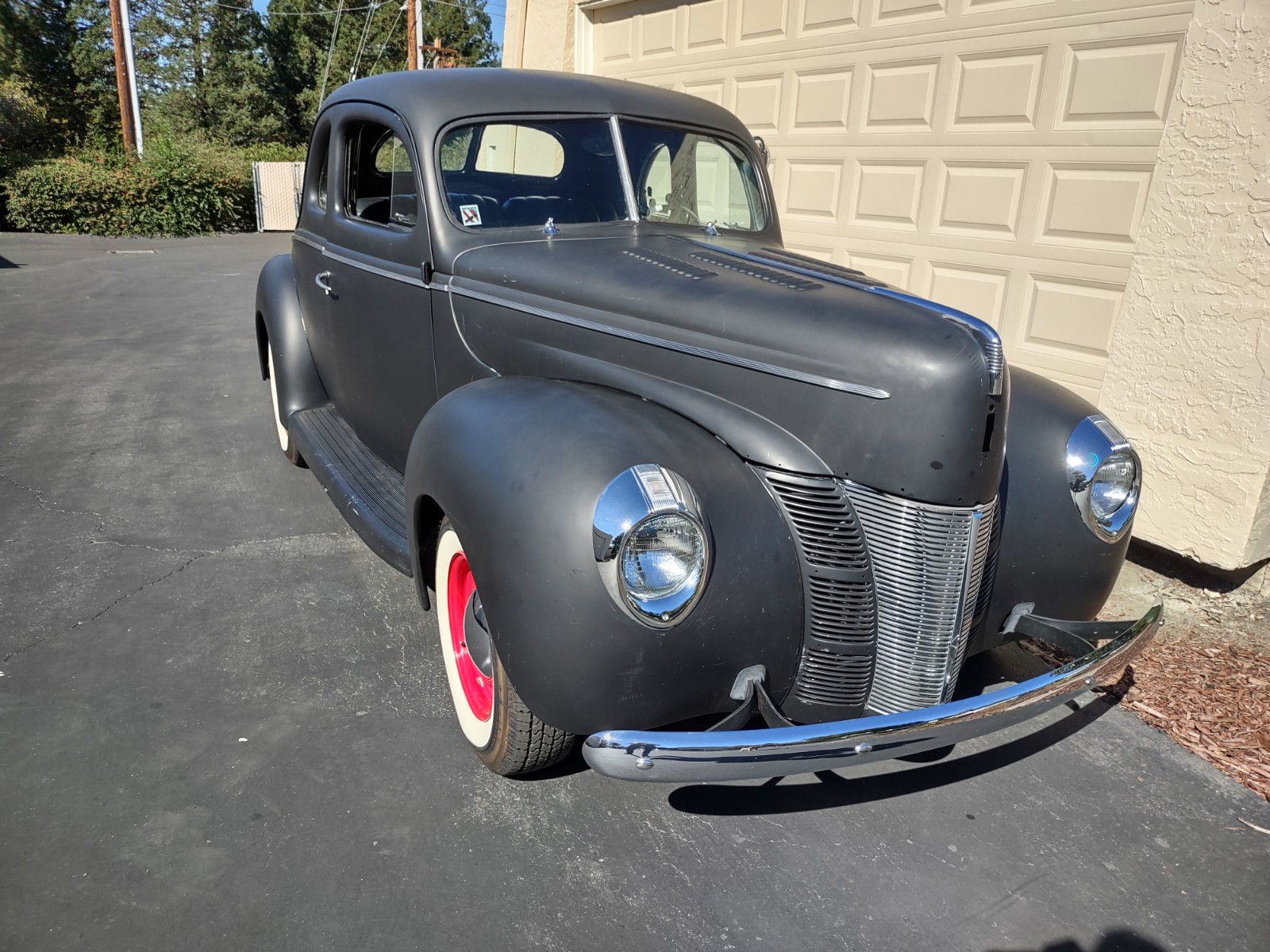

    Sweet '40. You can avoid thumbnails by hitting the FULL IMAGE ****on before the REPLY ****on. IMG_20221023_124642278_HDR.jpeg

    That's great. So now you are in a "good Moog?.
    Question: Your louvres look really good. How do you prevent water from
    dripping down onto the engine. Just curious.

    Ya don’t, when I wash it which is rare, I cover cold motor with plastic tarp,try not to drive in rain but I have, ya go fast enough water just rolls off ;)
