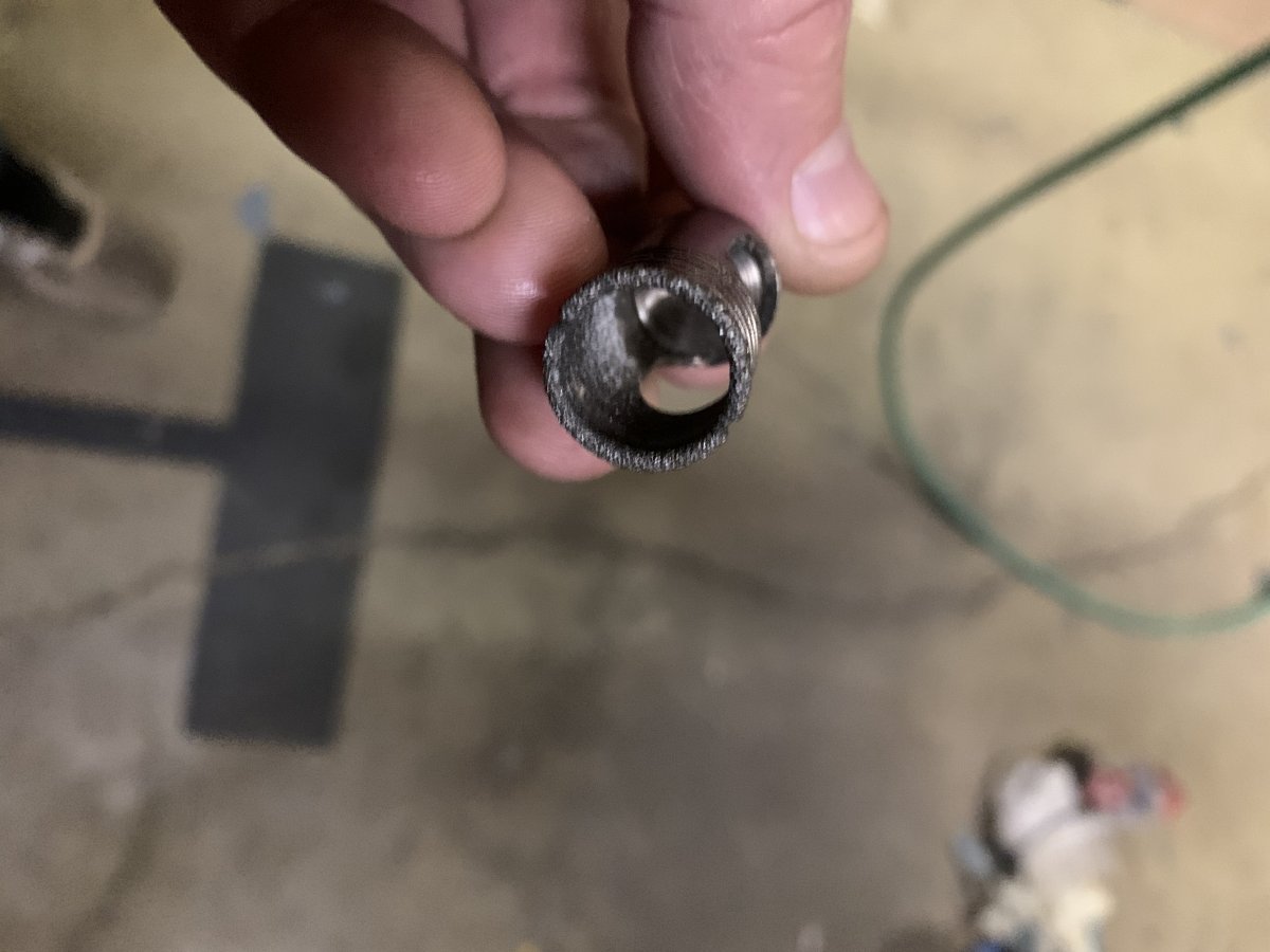

    I use this Diamond hole saw from lows on my 40 drums ,all 20 studs.
    I then used a air hammer to knock out , I used a modern replacement stud from Dorman
    ( cannot remember part number )needed to cut 1/8-1/4 of the flange off the head one side to clear hub taper , them press studs back in FD8975EC-F5F5-4356-95DF-2851B9AA1D6C.jpeg 79880CA3-9B66-47EA-A92B-DD44C735FC79.jpeg
