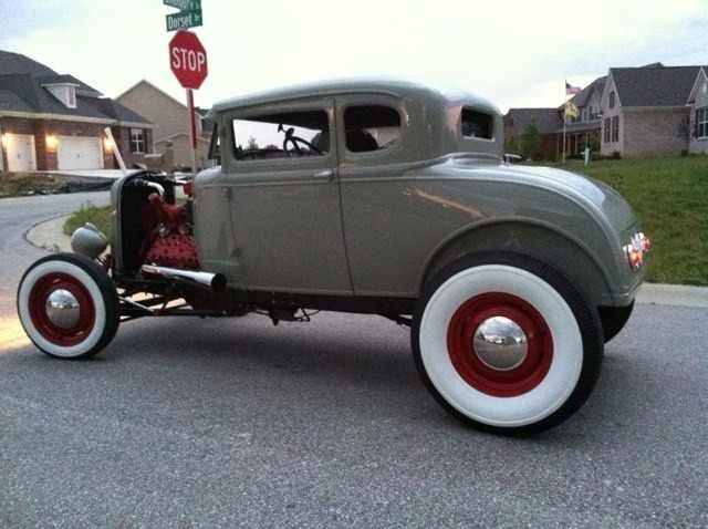

    I've reluctantly held back from intervening but here is my take on this. First there really is no problem with 40 brakes on a Model A if done correctly. After reading all the posts I seem to agree that the issue with the brakes seems to center around a lumpy set of drums. If the drums were turned correctly they wouldnt be lumpy so somewhere somebody screwed up. Next the Lincoln style brakes wont cure anything with lumpy drums other than make adjustment a slight bit easier. Yes you need to arch the shoes but first you need to correctly adjust the brakes according to the recommended procedure for the style backing plates you have. As I've posted before the best book you can have is an old Motors Manual pre 1955, these are less than $20 at the swap meet and have all kinds of service instructions and specs. Now if the drums are turned excessively like .060 over size or more the drums are borderline useable even if you arch the shoes as the wheel cylinder travel is about maxed out.
    After you posted the picture of your coupe the striking point is the low position of the master cylinder. This would lead me to think that most of your problem is not with the brakes themselves but the poor pedal ratio that you are trying to use to get the brakes to work. The ratio should be between 5:1 or 6:1 and I guessing yours is more like 3:1 with that low hanging cylinder, thats why it stops like crap and you have to apply excessive pressure to even feel like its working.
    My suggestion is to search out some bettter drums, take a tape measure and check that they are close to 12" dia before you shell out any $. Then Check your pedal ratio by measuring from the center of the pedal pivot to the center of radius of the pedal arc and then measuring from the center of the pedal pivot to the center line of the master cylinder push rod. Divide the master cylinder measure into the pedal measure for your ratio and see what you get? example 10" pedal arm/ 2" master cylinder arm is 5:1. Whats yours?
