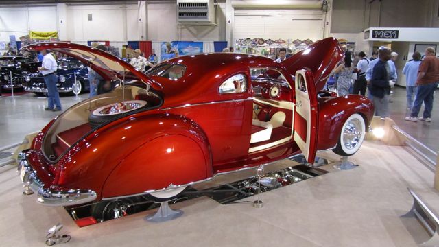

    I love cars of all types but the 40 ford coupe, done correctly with a slice out of the body also looks great... John McNally did two before he died.. much like the one in the pictures on this thread... Posies had a T-shirt years ago that had an ole country boy leaning on a chain saw and it said "If it ain't cut.... it ain't ****".... anybody can restore one. If you wanna cut it have at it :) I attached a couple of pictures of one done right... sorry to repeat but wanted to demonstrate what I meant by "right"...

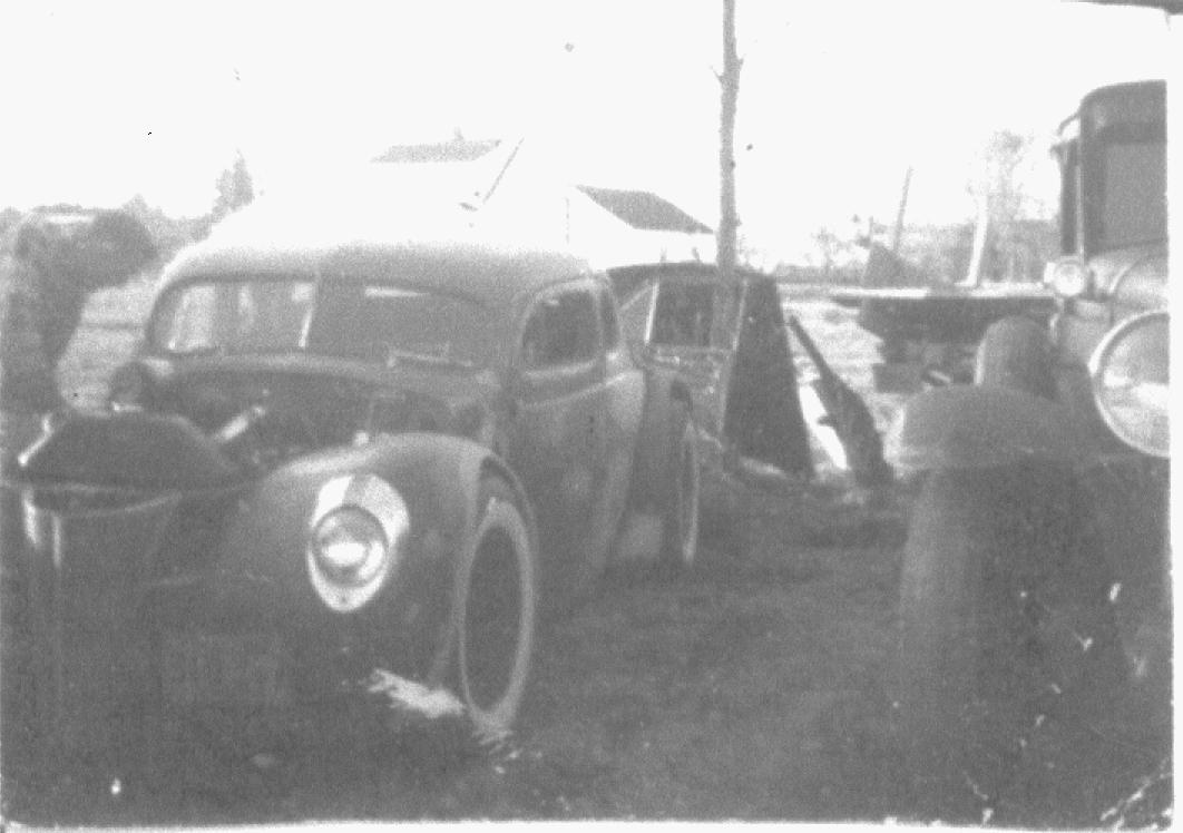

    This one was choped in the early 60's and has not been seen in the past 50 years. We would like to find it or what happen to it.
