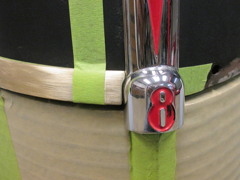

    Here are some more pics of the trim in the fitting process. The curves were bent by hand. Shaping them the flat way was fairly easy compared to bending it the wide way using a vise and a pair of welding gloves. The edges are very sharp. After they were shaped to fit the contours of the body they were marked for drilling an1/8"+ deep hole to fill with silver solder. I cut off 3/4" br*** machine screws to use for studs, and wrapped a heavy rubber band around the handles of my needle nose pliers to work like a spring. I used the pliers to hold the studs till the solder solidified. IMG_0354.JPG IMG_0355.JPG IMG_0356.JPG
    I also sectioned the grill and lower chin by about an inch, removing two lower grill bars

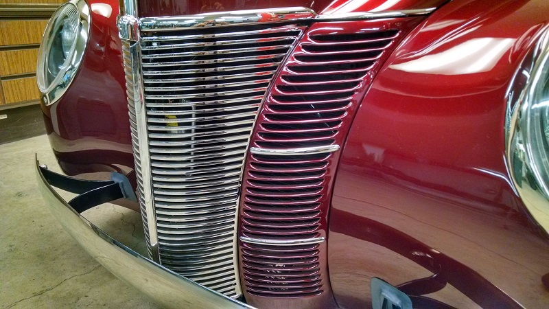

    I am getting to that point and since the car came back for a minor repair I can get more pictures of it. IMG_20141231_080111573_HDR.jpg IMG_20151027_080202954.jpg
    Specialty Plating in Mt Vernon,WA. does our plating and polishing. They filled the back side of the bull nose piece with solder and smoothed off the ribs out of the face of it before replating it.
    IMG_20151027_080225512_HDR.jpg IMG_20151027_080231271_HDR.jpg IMG_20151027_080239064_HDR.jpg IMG_20151027_080247429_HDR.jpg
    The front bumper was also tucked in closer to the front and shortened on the ends.
