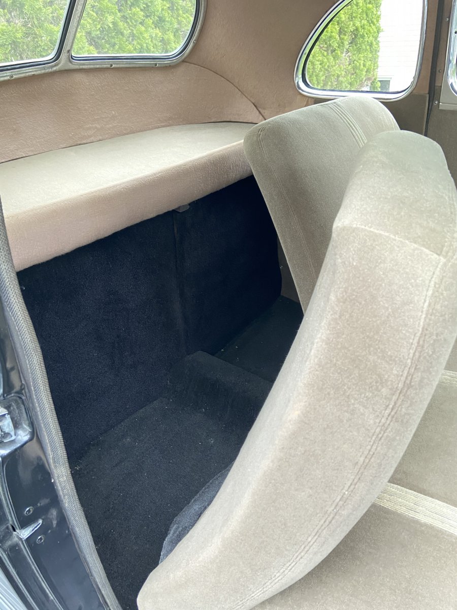

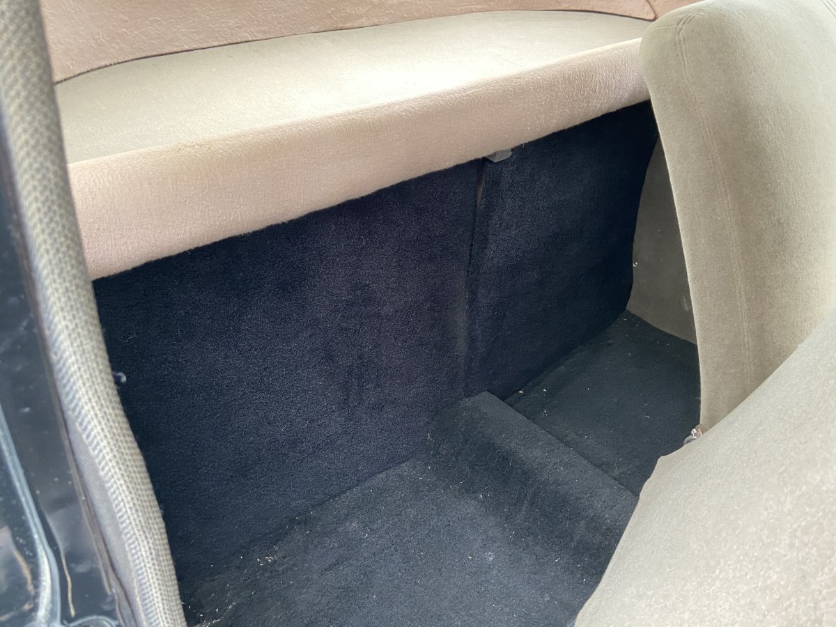

    Do you have the seat back that flips up from the bottom for access to the area under the package shelf? Those were hinged at the top. Or do you have the seat backs that fold forward like the coupes that had opera seats? If you have the former, it will be difficult to access the rear seats when you add them.

    Arkie, I have the folding seats. Here are some pics of my interior.

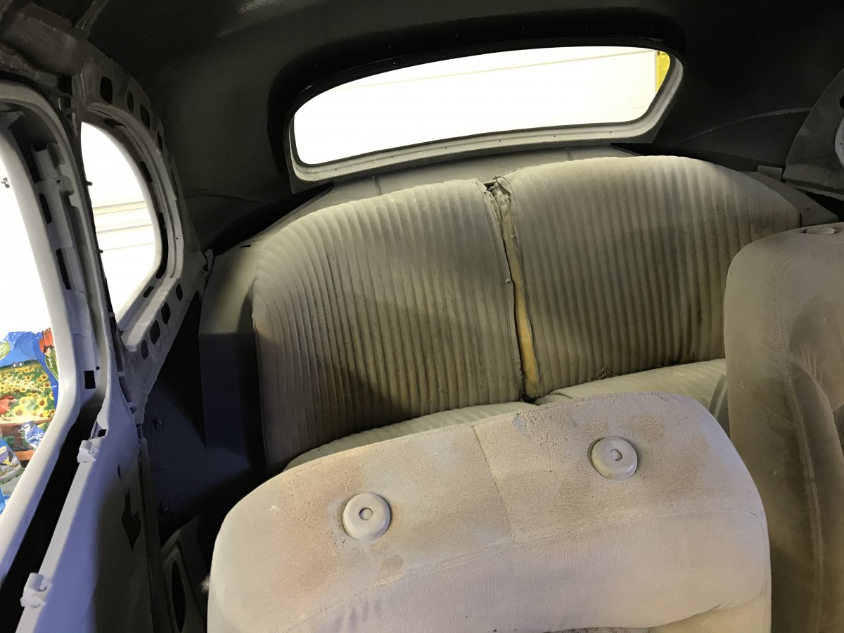

  19. OLDSMAN
    Joined: Jul 20, 2006
    Posts: 2,422
    OLDSMAN
    I am using the same seats in the 42 Chevy coupe I’m building for my daughter. Here is a picture of them in that car AC99B15B-C66E-4C43-9DB7-17D78E3EF235.jpeg
