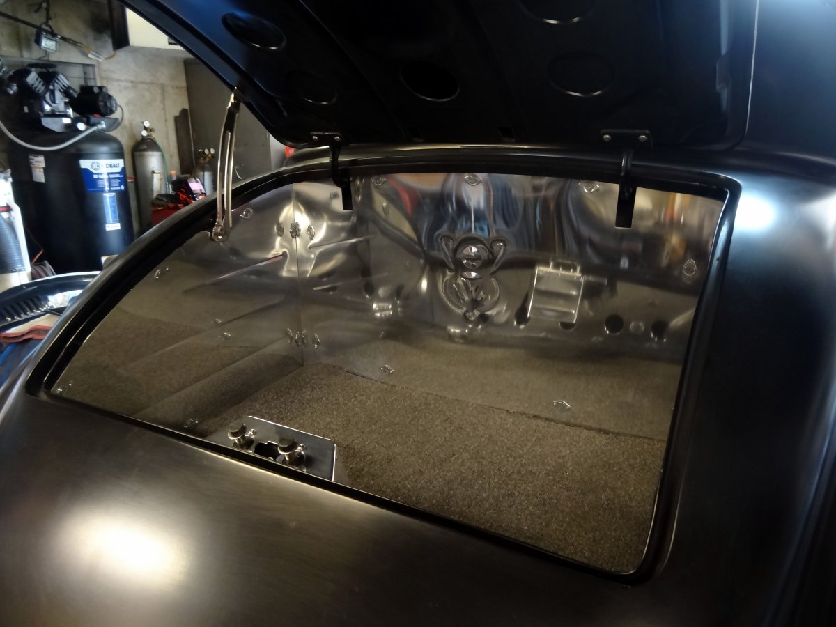

    In my case, I wanted a remote latch for my '35 and didn't want to worry about a dead Battery to open, so I made some brackets to hold my Latch (and Poppers, as I wanted it to open an inch or so as I didn't want an outside handle)-I also used two Cables (in case one broke-one is inside the car, one under the back) it may not be the most elegant, but it works!

    Wow, nice setup...sweet metalwork.

    Thank you, and I think you put a lot of thought into your Latch-nice work-
