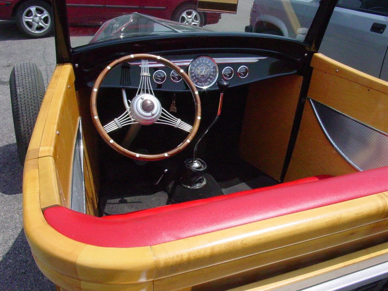

    Here's a few more pics of the wheel...
  11. tommy
    Posts: 14,757
    tommy
    It looks exactly like the one I made in 78. The spokes and hub are 39 Ford but the wood rim and the steel sandwiched between is an after market 3 hole Grant style. The holes are the giveaway. It's a home made wood wheel.
    The wood was riveted to the steel center. Drill out the rivets and cut the spider out of a 10 dollar flea market wheel and weld the shortened stainless spokes to the rim. I used brass machine screws to reattach the wood. It looks like this one has the holes plugged after the wood was reattached. I notched the rim so that the weld was hidden up under the wood. Then the wood was hollowed out enough to clear the weld. The last time I saw my old truck, a year or so ago, it still had the wheel.
    Believe it or not I saw the 39 donor wheel at Carlisle. The rim was sooo bad that the vendor said if you can use it you can have it. So the whole wheel cost me less than 20 bucks including the varnish:D

    '39 Ford banjo cut down with a Superior Wheel wood rim grafted to it.
    I have one for sale, Check my posts.
    TOMMY explained it best. Good way to save a banjo wheel that the outside is to far gone to restore.

    The wheel is an original 39 DeLuxe banjo with the spokes cut down to the smaller diameter and welded to the wood-trimmed rim plate.
    The horn button is an original 39 DeLuxe horn button/light switch rod which has had the rod modified. Does it have wiring to honk the horn?

  19. I had a cut down banjo with a Grant wood rim on my '32 Woody roadster pickup. Not quite as rare piece as folks might think.
