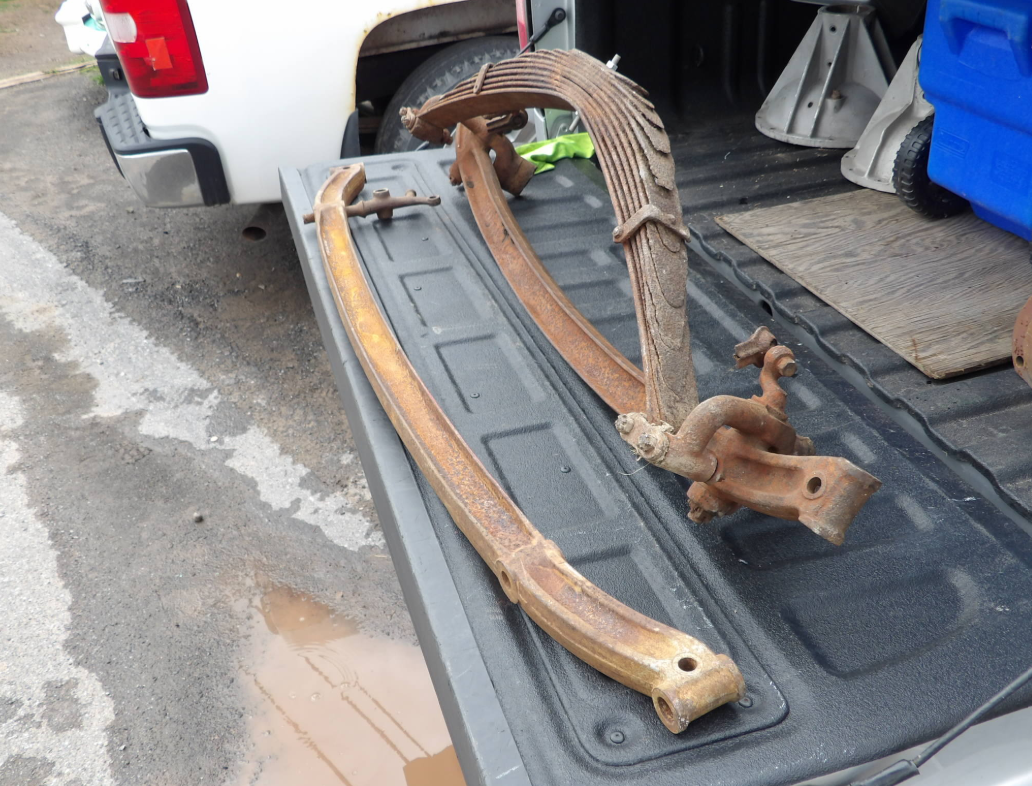

  10. tim troutman
    Joined: Aug 6, 2012
    Posts: 1,238
    tim troutman
    What Moriarty & Weedburner 40 said my 40 unsplit bones reversed spring eyes image000000(4)[1].jpg
  11. Funny I had no issue figuring out what the original poster was asking.
    Ford axles have several widths and variations on the wishbone boss to king pin boss width.
    The 37-40 the have a very narrow (short width) wishbone to king pin which make it difficult to get a large amount of drop.
    He is asking which axle can be used to give him the most drop but will not effect tire to frame clearance
    Note the difference between the 37-40 in the rear vs the 33/34 in the front

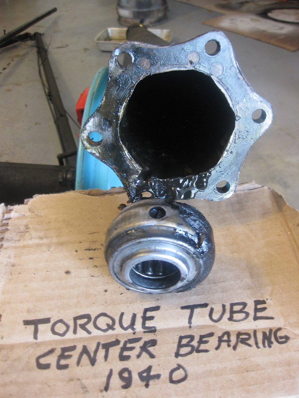

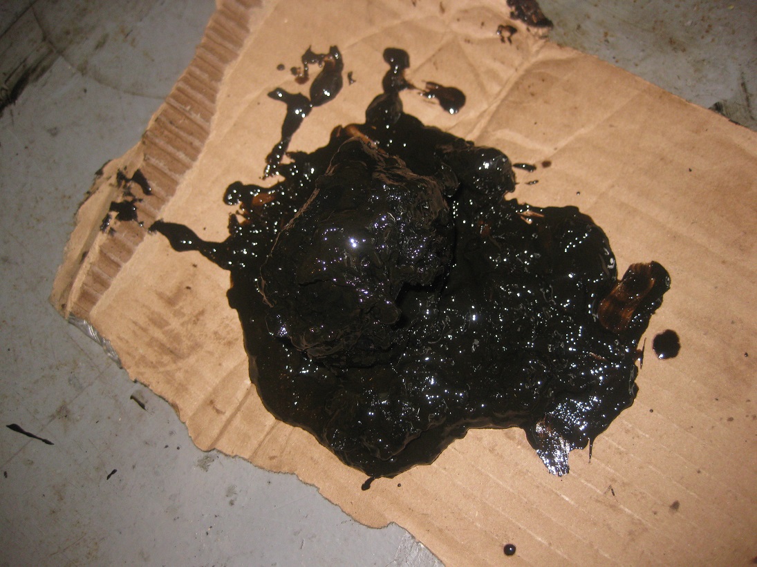

    ONE MORE VERY IMPORTANT THING I FORGOT TO MENTION.
    When you rake a stock 40 Ford the gear lube in the rear differential runs down into the torque tube, eventually
    reaching the rubber encased torque tube center bearing. Over time..........this gear oil dissolves the rubber surrounding the bearing causing it to come loose and the solid inner drive shaft to "whip" and vibrate. Because of this, you must keep checking your "rear differential" fluid level so you don't burn up your rear gears. There was a fellow in TX who made a special torque tube seal to prevent gear oil from running down inside the torque tube. Also, Skip Haney on Fordbarn was making a replacement bearing.
    Read all the tons of info. in the links in this thread.
    Torque Tube Carrier Bearing - The Ford Barn
