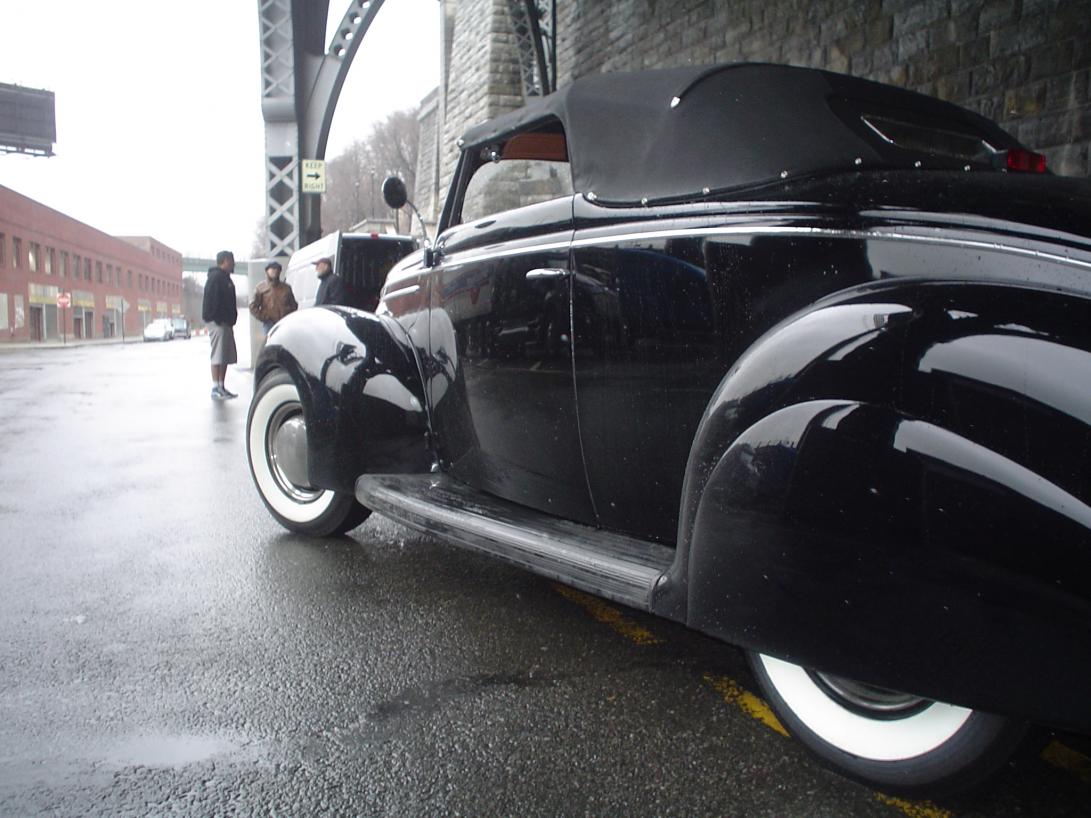

    Update: well I got the car home 221/85hp.. so much for the 6 or 7 year resto.. it's sat for that, was resto'd in the mid 90's but I like it all the same.
    I'm thinking 4" dropped axle, Big-n-Littles, Suggestion's: wide whites with tan smoothies & caps & rings or tan wire rims with polished spokes, any feed back? Haven't decided on the engine yet... which of the aftermarket heads runs the coolest on the street? also now thinking about a 2speed rear might like to drive this to Cali.. from the NW this coming summer.

    That's a nice looking car.
    You won't be able to tell much difference from any of the aftermarket heads. Be wary of used heads.
    The Columbia would be a very desirable option on that convertible...get as complete a setup as you can afford and have it bullet-proofed by one of the Columbia gurus.

    leave it how it is and enjoy it. the columbia would be a great addition down the road.

    Since you asked (always dangerous) I think your spoke idea would be very bad. Especially the polished spoke variety. Be careful, they are one of the best looking cars you can get so don't try to 'improve' too much. What's so wrong with the stock wheels?

    What a beautiful car.The wheels that are on it are sweet.Maybe you should have two sets of big and littles and change the look with your mood.With a car that nice either of the choices you mentioned are going to look very cool.

    When I bought my '40 Coupe 11 years ago it was a lot like yours.Older restoration with a fresh stock 221".I did the Eddie Meyer heads and intake with 2 Stromberg 81's.Mild cam,Fenton headers , bearing not bushing water pumps and pressure oil system.My car runs cool all the time and with the Columbia rear end can drive down the road.......Your '40 looks very nice and I hope to see it at some of the NW events..........Z.D.

    Pretty car. Don't put wires on it; they will look out of place.

    if you change something up.. I would love to buy your stock wheel covers caps etc for my 40 project
