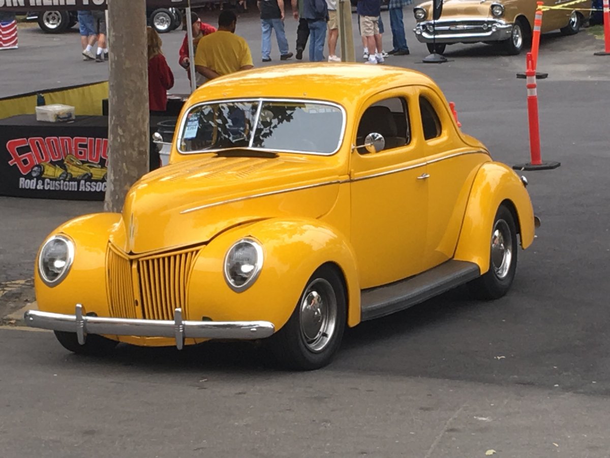

    Joined: Sep 29, 2005
    Posts: 152
    barebones32
    Thanks to everyone who posted. I appreciate it very much. You can see why I wanted this info. D1E61279-2BA5-48D7-B6A7-DA2EB28B157A.jpeg
