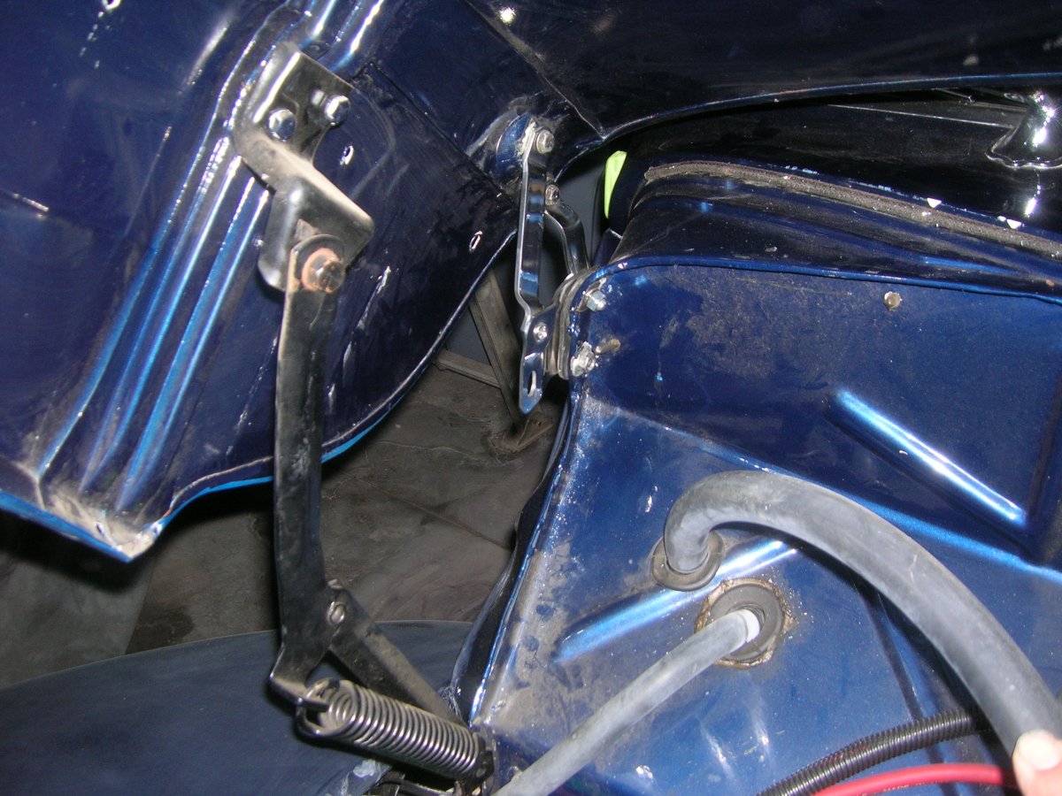

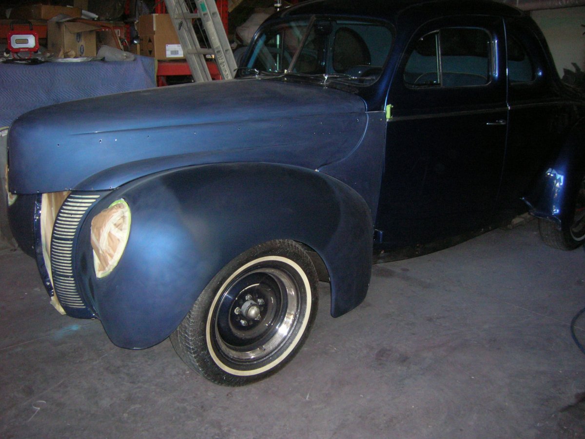

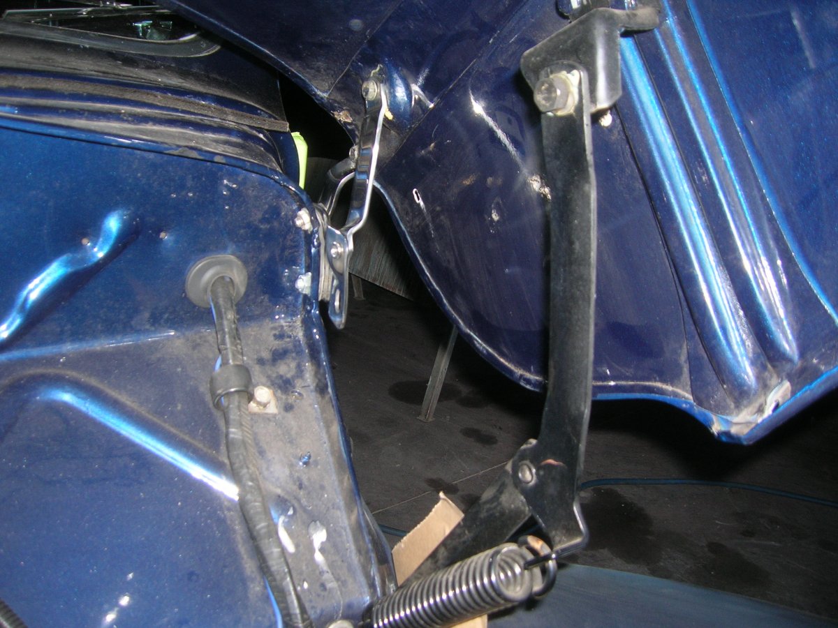

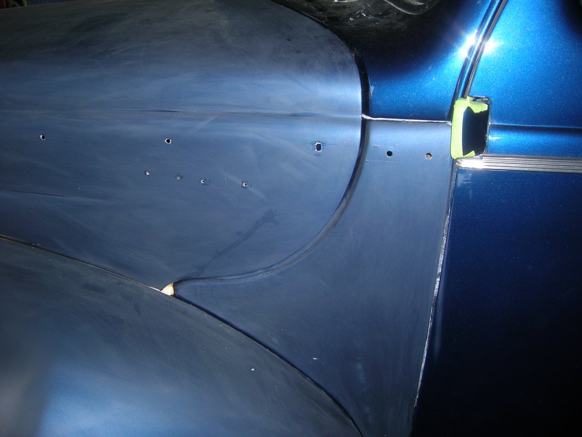

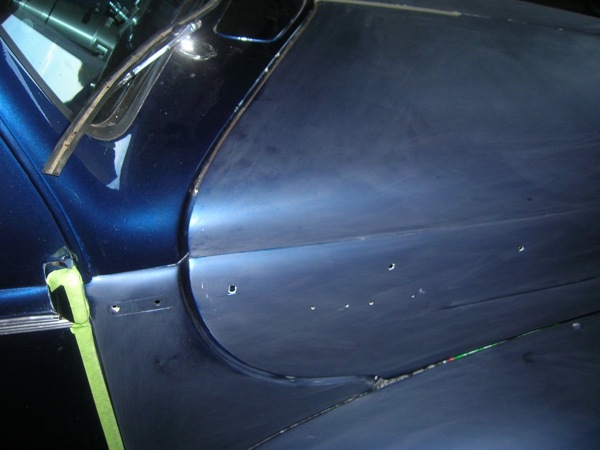

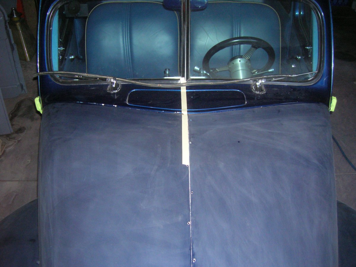

    Thanks olscrounger for the call last nite. Here are a few pictures. I'm on hold with the paint work until I try all the stuff you suggested. Yep, this car was done a while ago, then got some damage during an earthquake. A buddy of mine recently bought the car and we are trying to get it cleaned up and back on the road.
    DSCN0051.JPG DSCN0049.JPG DSCN0048.JPG DSCN0050.JPG DSCN0046.JPG DSCN0047.JPG

  15. olscrounger
    Joined: Feb 23, 2008
    Posts: 4,843
    olscrounger
    good pics
    -make sure door trim is tight or close under the hinges
    -get hood close then--
    -gap on dr side at cowl S not too bad
    -gap on p*** side wide-means front clip may need to move toward p*** side a bit and up a tad
    -inst new hinges 1st and rubbers in hood holes and cowl
    -looks like grille a tad high at present-try to drop maybe a strong 1/8 (can only see dr side front)
    -when close I think you will have to file down the holes for the short trim(use bolt type clips, not snap in) and the last 5 holes on the hood for trim alignment
    I see where it is catching the cowl--try the trick I told you last nite on it as the car sits now and see what happens.
    call again if this doesn't make sense
