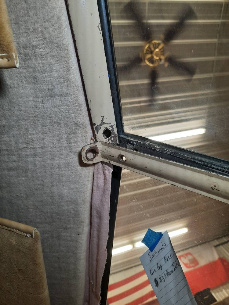

    PO disassemble interior
    What type nut affixed RVM to garnish molding?
    Does the the inside vertical molding belong under or on top of the side moldings? 20210429_172251.jpeg

    You've got the windshield divider upside down. The stock windshield wiper motor switch goes through that large hole from under the dash. The rear view mirror mount spans the upper garnish moldings, screwing through the end holes in the garnishes.

    Tks. I should have realized that
